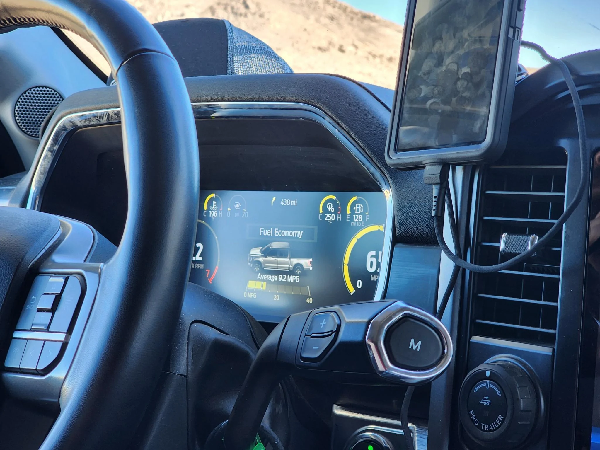

Oh look. A thread relevant to the reason I logged in today.
Ford F-150 High Trans temps 1000009581
I normally run around 200-210, unloaded. And now I'm leaking fluid.

I've got an update!
I took mine in for its fluid leak. Apparently the foreman who looked at it in ABQ WAY over filled it to get me home and attempted to reseal the pan.
The tech, today, told me there's essentially a thermostat in the coolant heat exchanger that opens when the transmission is cold to help it warm up. It then closes at normal temps, and will reopen at higher temps. Mine was binding so it was only opening about ¼ of the way. He's getting the part in and I hope this fixes my problem.
My truck also stinks to high hell of burnt transmission fluid.
