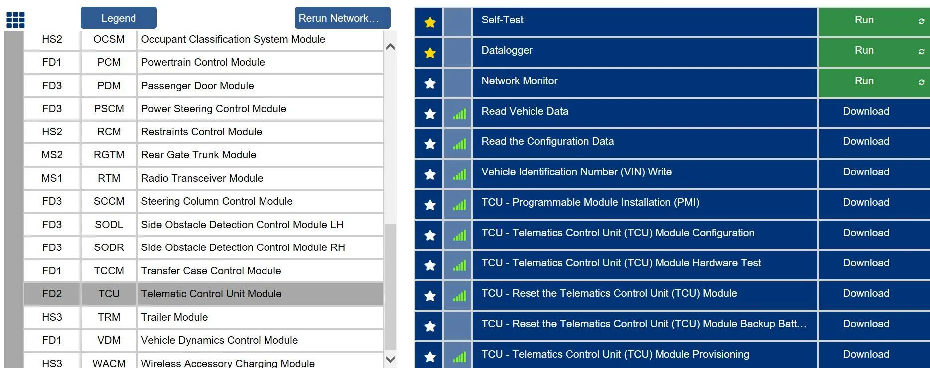

Any pointers on why TCU applications won't be available for my VIN while they are available for a friend's VIN.
My VIN (2021 Raptor):
Ford F-150 TCU Applications - Unavailable 1747216133533-2f
My mate's VIN (2024 Raptor):
Ford F-150 TCU Applications - Unavailable 1747216257062-5d

@Fordphanatic It is not about the updates mate. I am asking about the FDRS applications available for my truck. Like I cannot even do a PMI at this point because FDRS for my VIN doesn't show me an option to do it under TCU.
What makes it more interesting is that I had a TCU Update available 2-3 days back and suddenly today it is gone along with the TCU applications on FDRS.

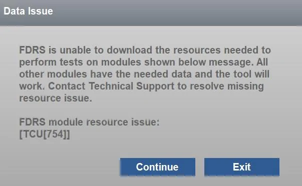

Additiionally if I do a self test, I get this message:
Ford F-150 TCU Applications - Unavailable 1747231095863-yj

Same thing that happened to @Al1979 yesterday. He is also in the UAE.
