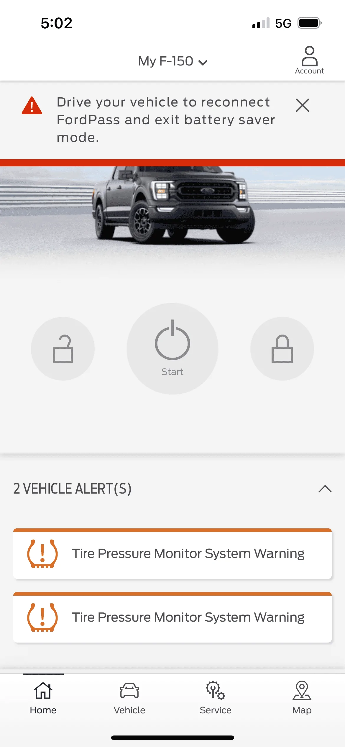

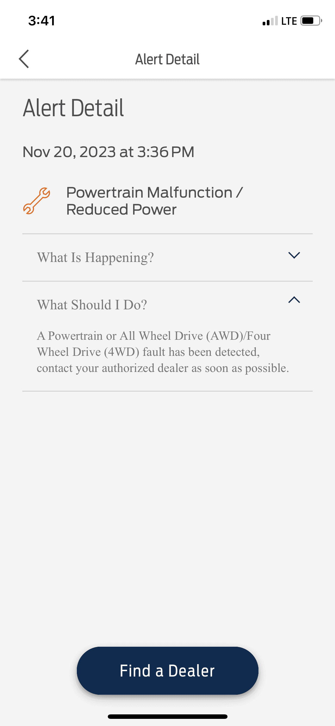

Tried to remote start my 22 Limited PB .. no go… got in the truck to start it .. got this strange chime .. truck started, drive my 10 miles to work .. shut the truck off and get the ignition switch message , no interior lights.. this is complete BS ! I’m already scheduled for a reduced power/power train malfunction check Tuesday at the local dealership .. WTF Ford ! Biggest POS I have ever owned
Ford F-150 "System Off to Save Battery" message IMG_2318
Ford F-150 "System Off to Save Battery" message IMG_2317
Could be both issues are rooted in the same source. A weak battery.
Not guaranteed, but very possible.
