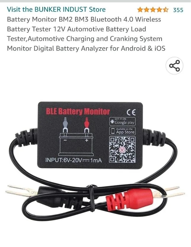

Yea I wish i had a way to pull this data to see what could be possibly draining 40% of the charge every night. I have a dashcam hooked up via usb to the rearview but I highly doubt that could be the issue. My only other thought is to try and force a software update or just unplug the BCM module from the battery itself. Otherwise Monday its sadly back to the dealership.
$25
Installs in 5 minutes.
You can now KNOW the voltage of the 12V battery 24/7/365
It will log the voltage and it automatically downloads to your app the next time you open it.
When you launch the app (within 30-40' from the vehicle, you will get the voltage real time.
Ford F-150 "System Off to Save Battery" message Screenshot_20231201_181356_Battery Monitor
Then it downloads the log and you can see the voltage in 24 hour blocks. As you slide your finger across the graph it will show you the timestamp and voltage at that timestamp.
Here is what an undisturbed truck SHOULD look like if the battery isn't draining (significantly) for the full 24 hours.
Ford F-150 "System Off to Save Battery" message Screenshot_20231119_123622_Battery Monitor
Based on what you describe it would look very different.
Ford F-150 "System Off to Save Battery" message Screenshot_20230419_105615_Amazon Shopping
