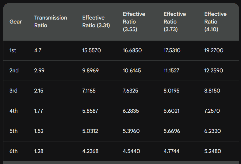

Your Platinum PB is set up like all other 4WD PB's to start out with a 37kw electric motor that utilizes and is optimized through 3.73 gearing.
I've played around with seeing where the power is with the electric motor and have come to the conclusion that the gearing choice from ford is centered around easing the job of the transmission. The 2wd comes with 3.55 as it's a given there's traction limitations in a 2WD truck. 4WD changes that variable. The PB already puts the 10r80 at its torque limit especially as it's always shifting right into peak torque. (furthermore I've got logging showing peak output power of 44kW, just exceeding the 160a fuse rating)
The electric motor will still pull just as hard in 3/4/5 at low RPM. EVs are typically geared around 9:1. The motor used for the PB isn't a typical EV style, they often have smaller diameter rotors whereas the PB's is larger diameter/ flatter, and is geared around more torque at lower RPM than high revving which it can't do as it's coupled to engine RPM.
