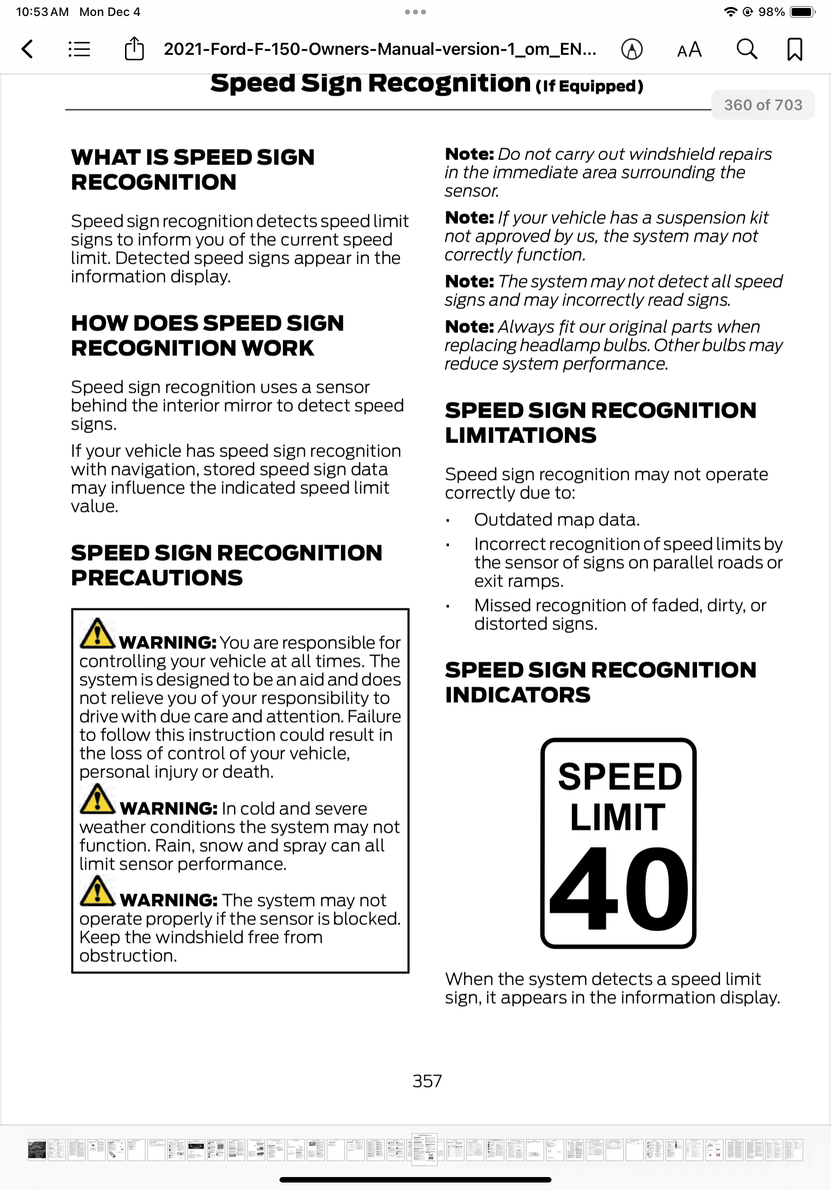

A recent update turned on the automatic speed recognition. You can still have adaptive cruise control and speed sign recognition. Just turn off the automatic speed setting on your infotainment screen.
Thanks for the reply, I dont see the "automatic speed setting" I am looking in the cruise control section. Is it in another menu? Thanks again.

It's in Features; Driver Assistance; Speed Limit Assist.
