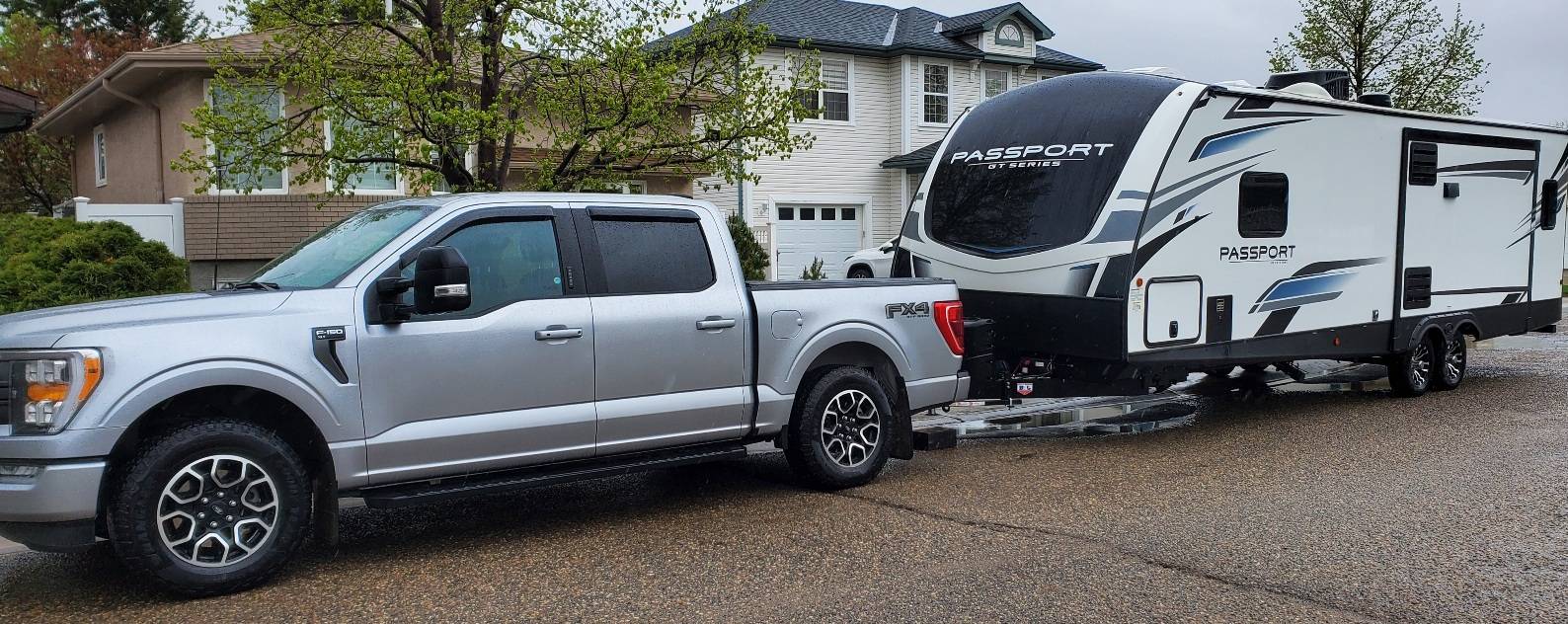

I went with the Stage 3 Motorsports 2.3 offset spacers on my '21 FX4 5.0 The truck now has a 3/4" rake with an empty gas tank and 3/8" with a full tank. The install is simple, just follow their instruction video. Pull the caliper, rotor and drop the lower control arm at the inner attach. Slide the strut out the bottom. Add the spacer and reinstall. I was careful to return the lower arm bolts to the witness marks. When I took it to the alignment shop they just had to recenter the wheel. Rides and handles the same. I pull a 22' RV with a equalizer hitch so no issue with any rake. Truck sets level and the trailer is level.
