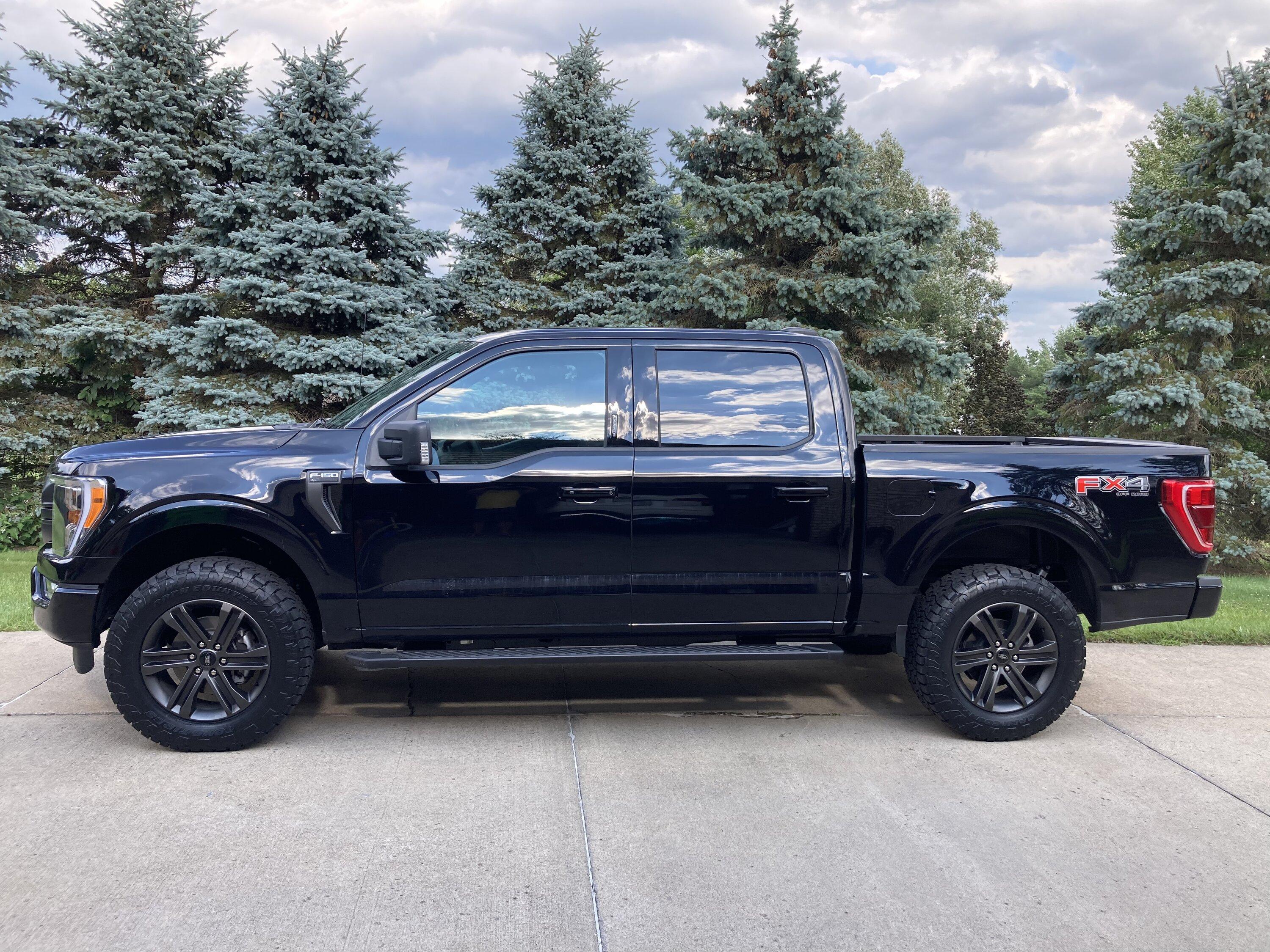

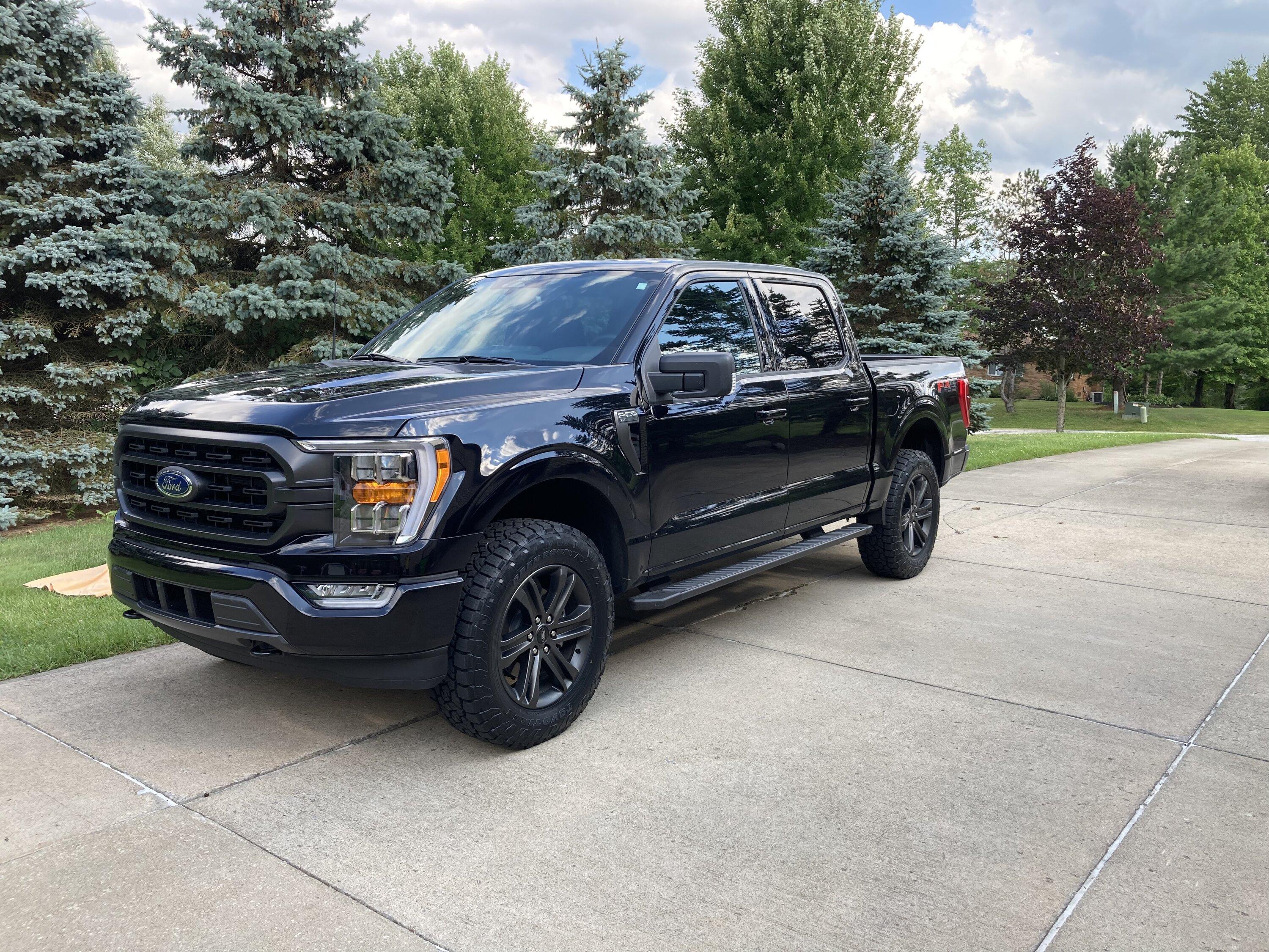

302a fx4, no tow packages, 36g tank. Just over 40” front, 41.75” rear. 21-22 fox 2.0 with 275/65/20. My memory says I got 2” lift upfront but I’m starting to think it’s closer to 1.5-1.75 looking at it.

I’m glad you mentioned this. Trucks with essentially all the forward rake removed tend to appear visually nose high, even if the tape measure says otherwise.
Having the rear wheel liners goes a long way towards making the rake look less visually jarring...especially on lighter paint colors. For my last 3 trucks...2012, 2020 and 2022...about 2" rake is the sweet spot for me. It quiets the look down from the 3.5" factory rake but allows loading almost to the payload limit without going too far into nose high territory. with 1200 lbs I get right around 2" sag and at about that point the Max Tow springs are fully engaged and more load doesn't move it much.

Don't tell the BAP pack...but that Sport Package looks much better than the Black Appearance Package on a black truck.
