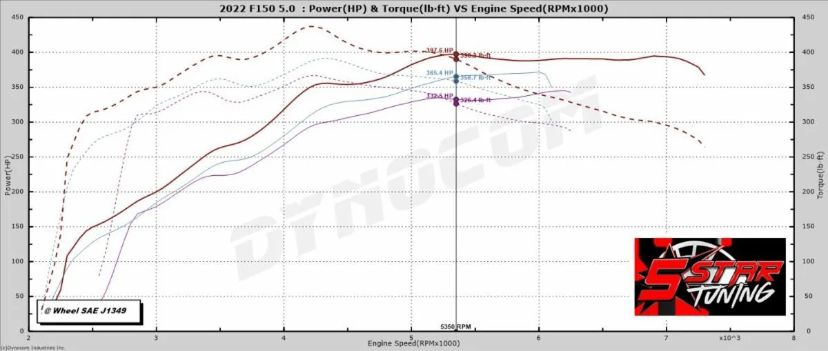

Here are 5-Stars baselines for the 5.0L (at the wheel). Blue is stock on premium and purple is stock 87. The 5.0 makes 30 lb ft more grunt on 93 in certain parts of the rev range. At 12:1 premium is required if you want full torque and power, GM can’t even run 87 in their slightly lower but still high compression 6.2 (11.5:1). The 5.0 is adorned with some extra technology that can bleed off cylinders pressures to tolerate lower octane, but it costs power. Per F-150 owners manual, 91 or higher octane for best performance on the V8.
