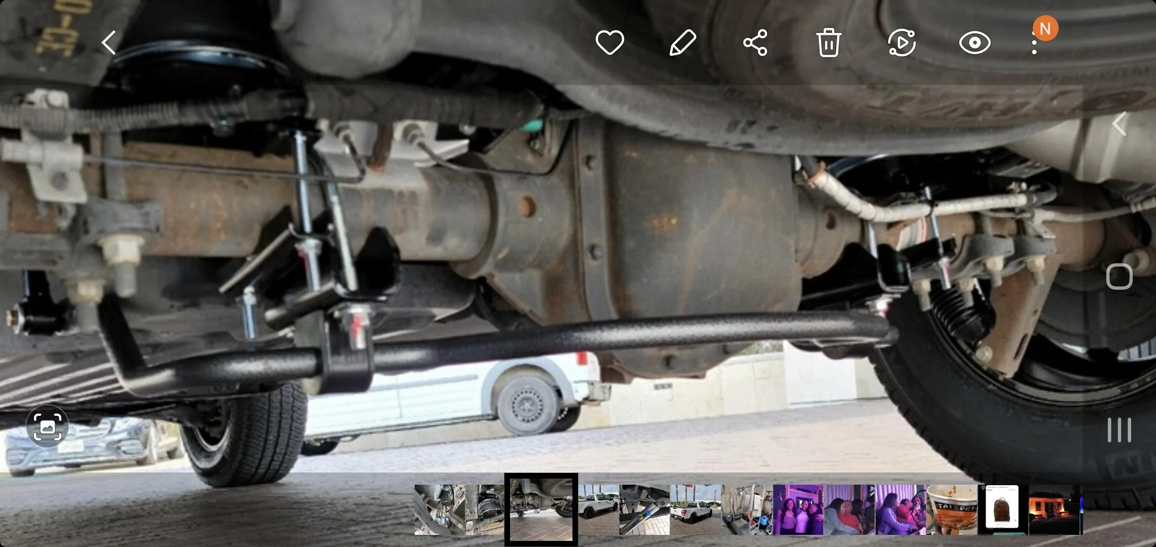

Don't know if it has been addressed, but there is an installation issue with Airlift PowerLift 5000 airbags on PowerBoosts. I have a phonecall scheduled with AirLift Jobber department and they are going to give me the full skinny on the issues. More to come on this topic. The initial report is that there is a clearance issue with the PB fuel tank and the airbags.
A few weeks ago, I ordered p/n 88355 as it was the kit listed for 2021 F150 4x4. After I received them, I went back to Airlift's website for some installation photos and they now have a subcategory on the 2021 only giving the NON PowerBoost option.
I'm not sure which brand of Airbags we put on our Powerboost in our corporate fleet, but it did get a Helwig rear sway, Bilsteins, Load E tires. We use it to tow an RV to remote airports to provide shelter for Aircraft technicians and power for tools and lights. Basically a rolling aircraft maintenance department.
