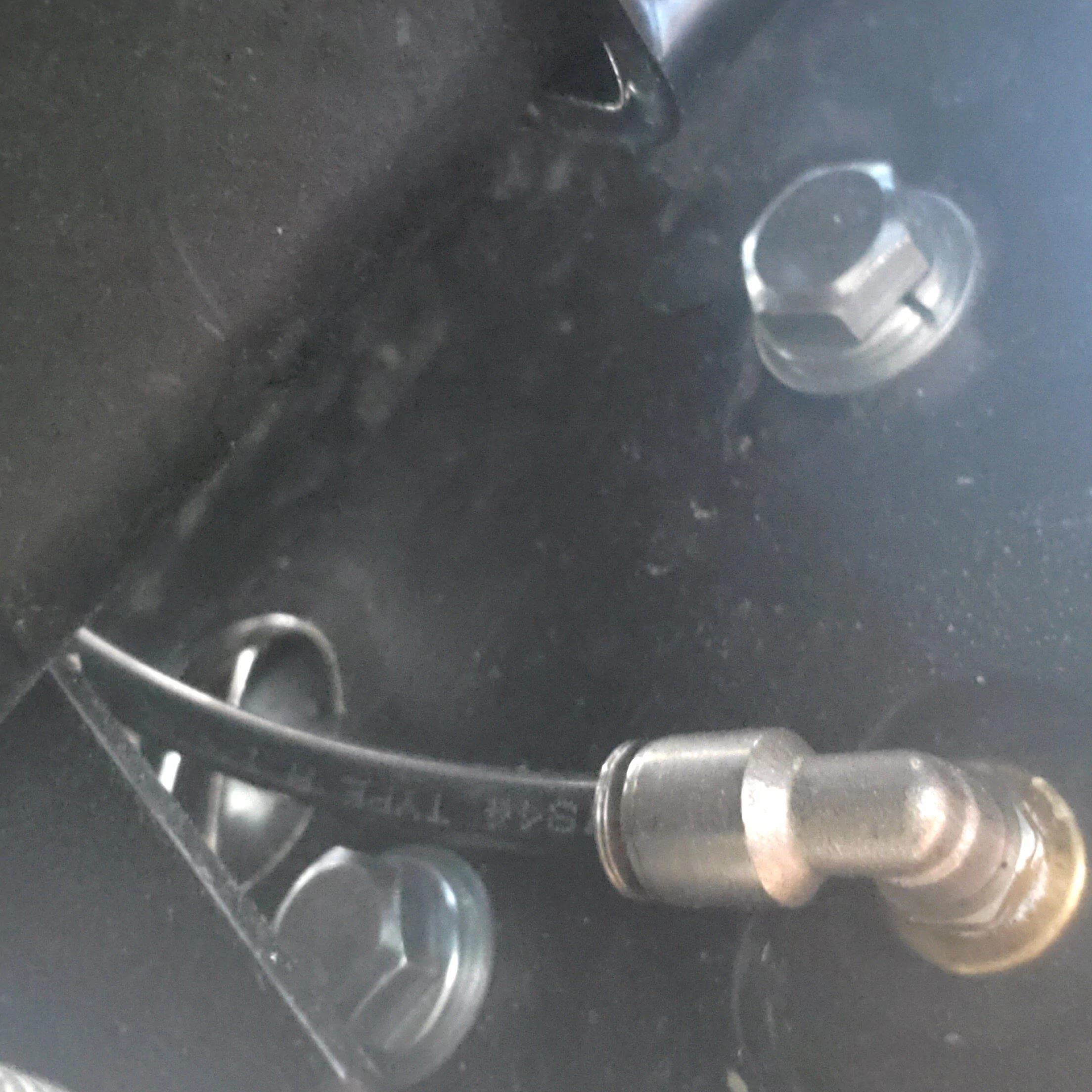

AIRLIFT AIR BAG INSTALL. BOUGHT ON AMAZON, https://www.f150gen14.com/forum/threads/show-us-your-powerboost-suspension-mods.18303/
I did the install myself, 68 yrs old and took the better part of 2 days, taking my time. The hardest part was starting the to bolts of the air bags on my back and blindly feeling around. I did not use a electric pump, just a air inlet on the bumper near the lic plate. 2021 F150 XLT powerboost and be sure to read all the instructions. I had bolt left over and OPPs found they were optional with a call to the tech support people. No room for torque wrenches, use you strength and judgement for that. https://www.airliftcompany.com/

Nothing extra by way of factory installed suspentions. Just enough with the AIRLIFT to take the squat out when towing my travel trailer.

I just let all the air out, and the ride is OEM. Simple solution to what I thought what u did.

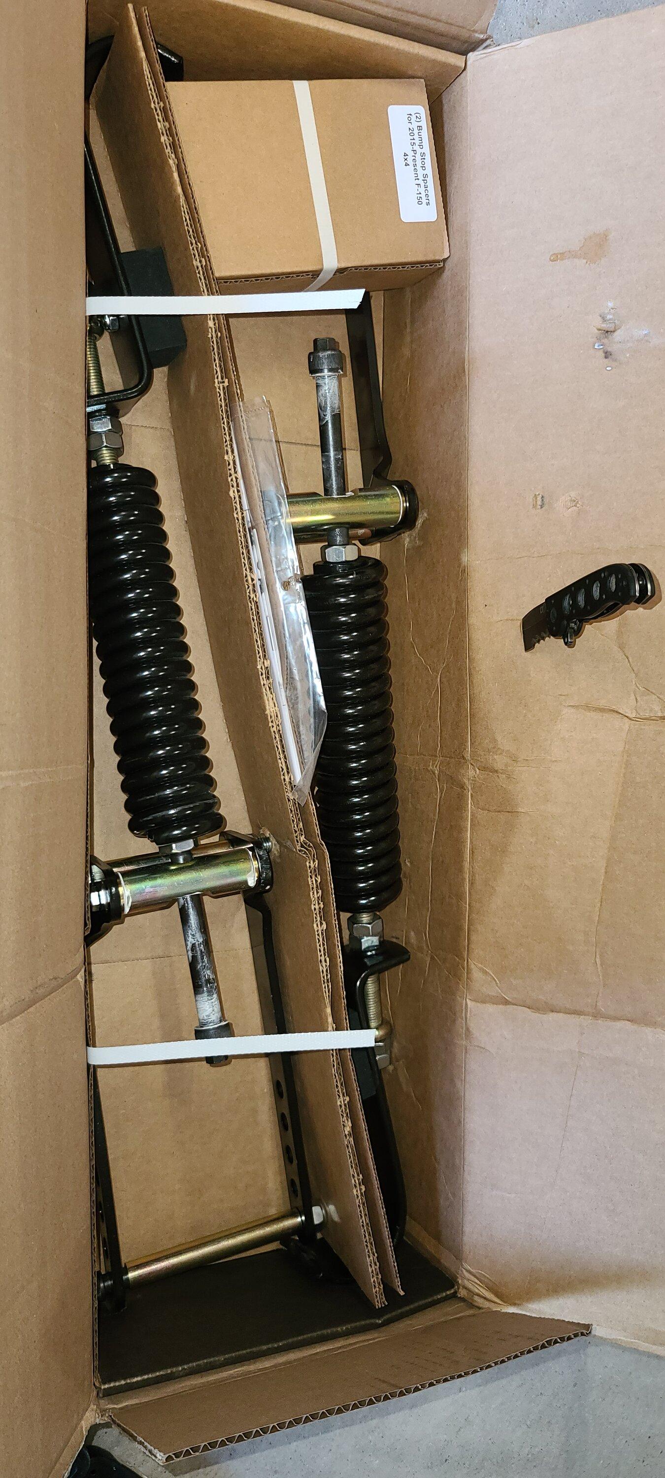

You describe my exact concern. The air suspension limits the distance the axle can travel away from the frame and removing bump stops concern me the other direction lol. ReadyAir I found interesting but I can't confirm they work yet on my PowerBoost. I think the HVB module or fuel tank is in the way. Something like that.
A bit more analog, and requires a few seconds/minutes of your time to "tune", if you are wanting to dial it in for changing Payload state.
But it's one way to skin the cat.

Exactly what my next mod is going to be. Any issues with the install on your PB? Did you get the SD or HD model? Black or white disk for tension?
