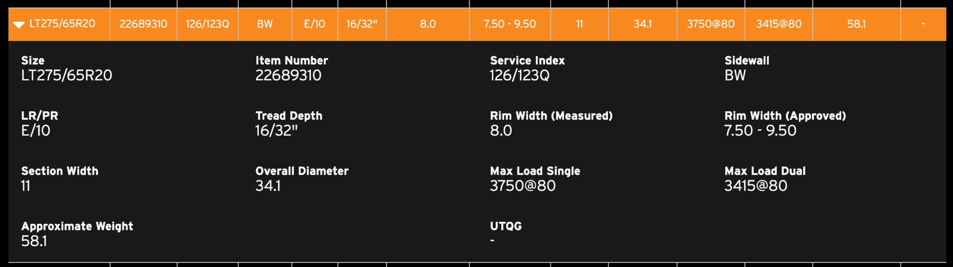

Falken Rubitrek stock size. Nice ride, barely noticeable more noise on highway. No change in fuel economy. Can’t speak to snow or off-road yet. They look nice. I think these are 116SL. Installed for $1000. I’m happy.
Ford F-150 All Terrain Tires for your Powerboost 3B89B210-39C9-46B9-AA0B-21629BFD9D98
Ford F-150 All Terrain Tires for your Powerboost F4060646-42A6-4C6E-8336-51E7A1D183FB
Ford F-150 All Terrain Tires for your Powerboost 57389182-A9A8-442C-9ADB-725C0AB92A42
Ford F-150 All Terrain Tires for your Powerboost 5AB8959A-341E-49D7-987E-DC9A3F2CD03E
