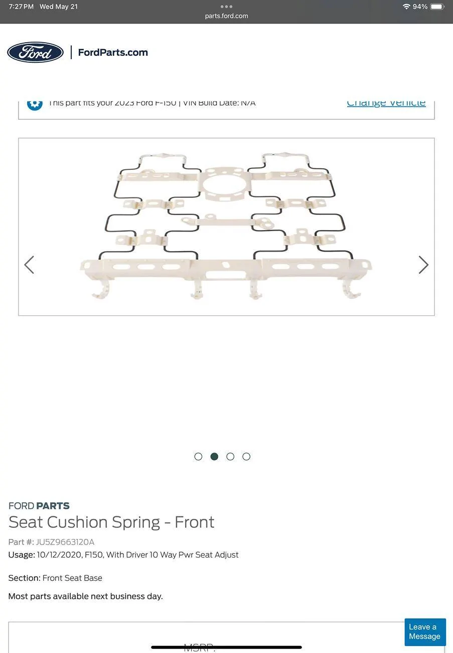

This is the part you likely need. it’s what was broken on my 18. Roughly $60 at Tasca, took me about 30 minutes to replace.
Thanks so much for that! How hard was taking the seat off, the cover, getting it back on, etc?

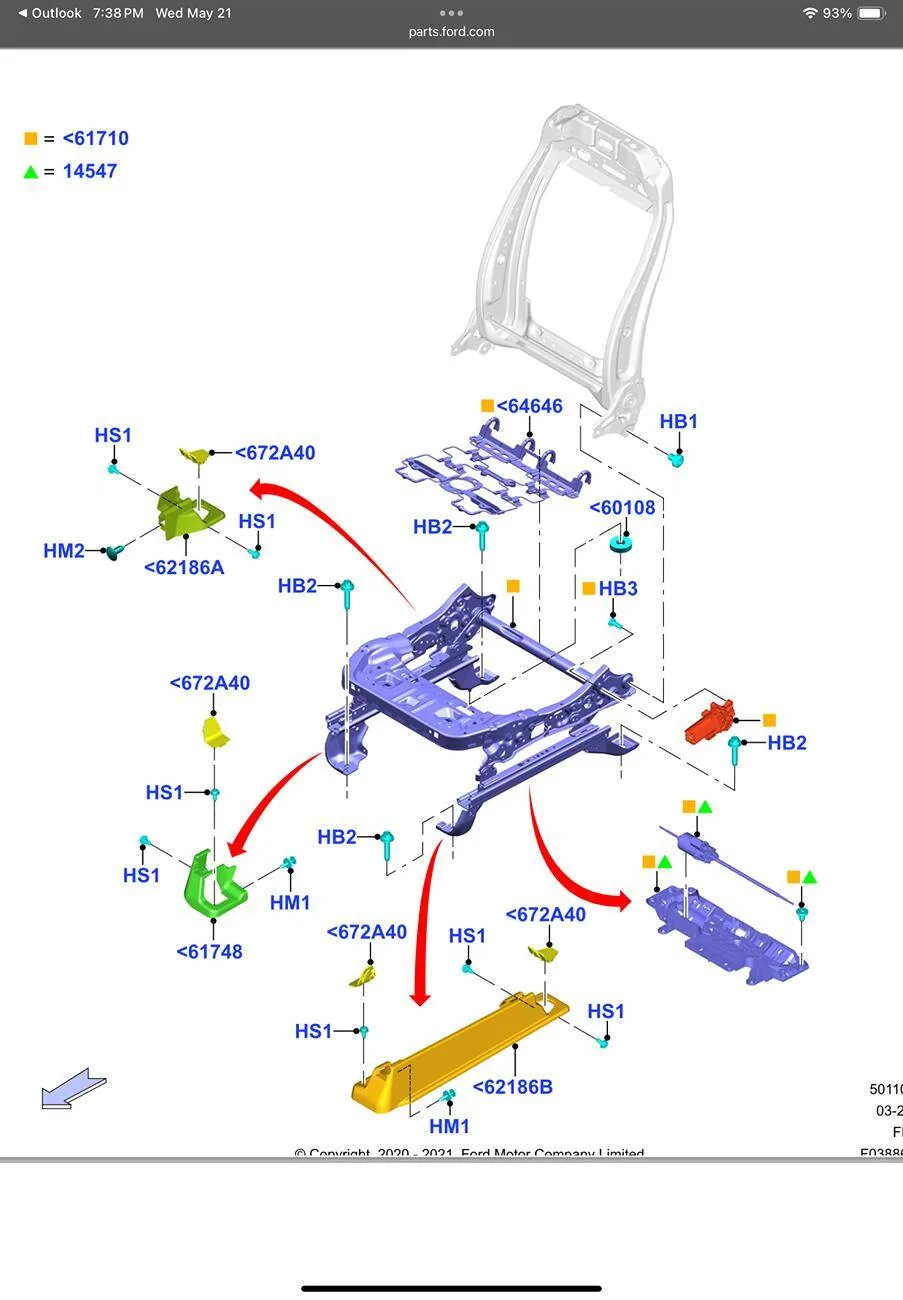

Super easy. Unbolt the seat track, unplug the seat, remove from truck. Underneath, the lower seat cover is held on by plastic j clips. Undo these and the cover pops right off. Then this spring basically just sits on the frame. Swap it out and reverse of removal.

Will want to disconnect the battery and make sure there's not an aux battery under the rear passenger seat before tearing into it. since you need to pull the seat out which means the seat airbags need to be disconnected when unplugging the harness to the seat. If you do this yourself just be sure everything is reconnected BEFORE reconnecting the battery. Otherwise you could get an airbag fault that will take several cycles or Forscan to clear.
