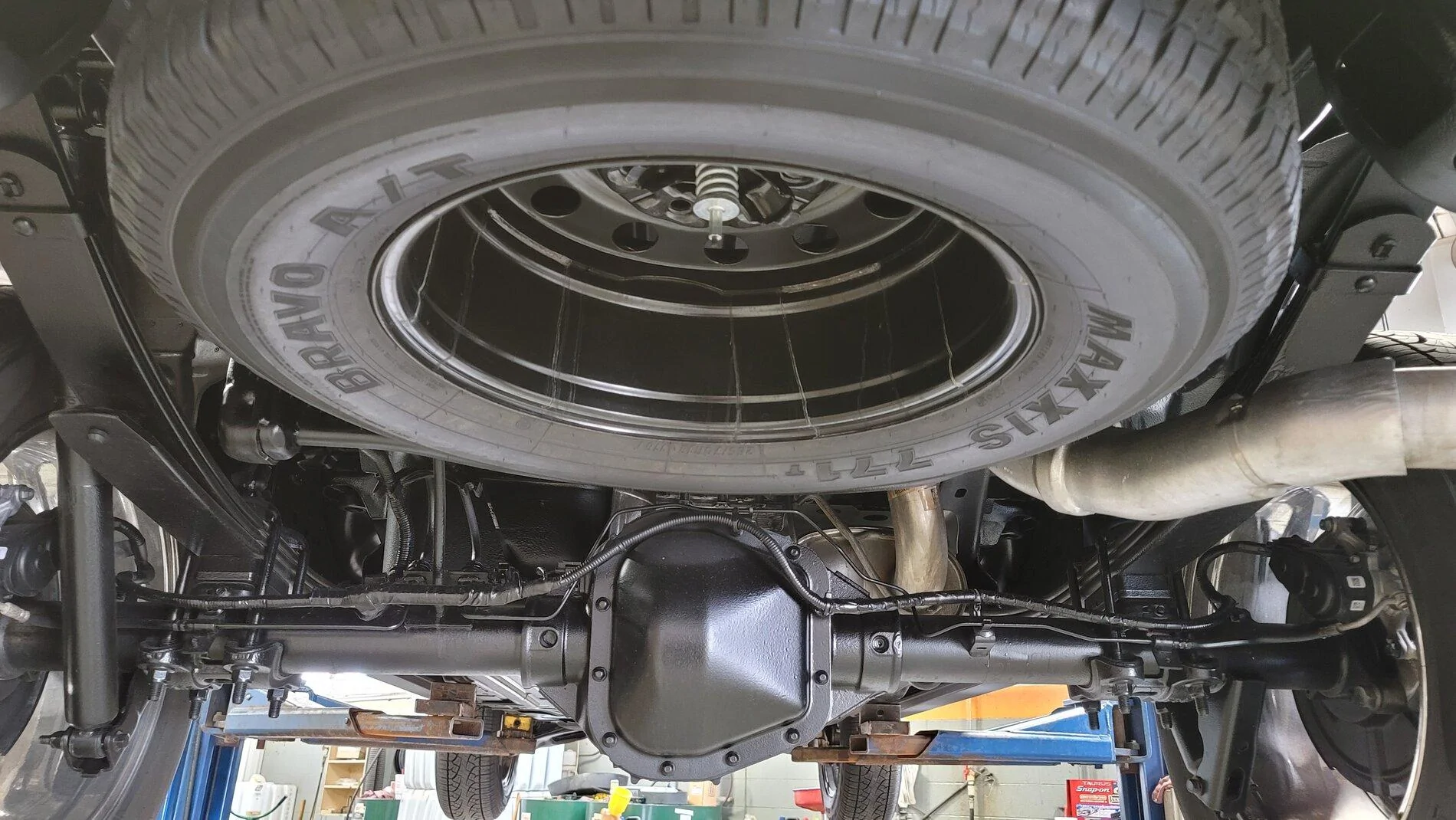

I have done the Line-X undercoating on my last 7 vehicles. It helps to seal (no rust) and deaden road noise. Never had any issues.
I did my 22 that was 3 months old still clean as a whistle underneath with linex. Happy with the job they did. Of course time will tell.
