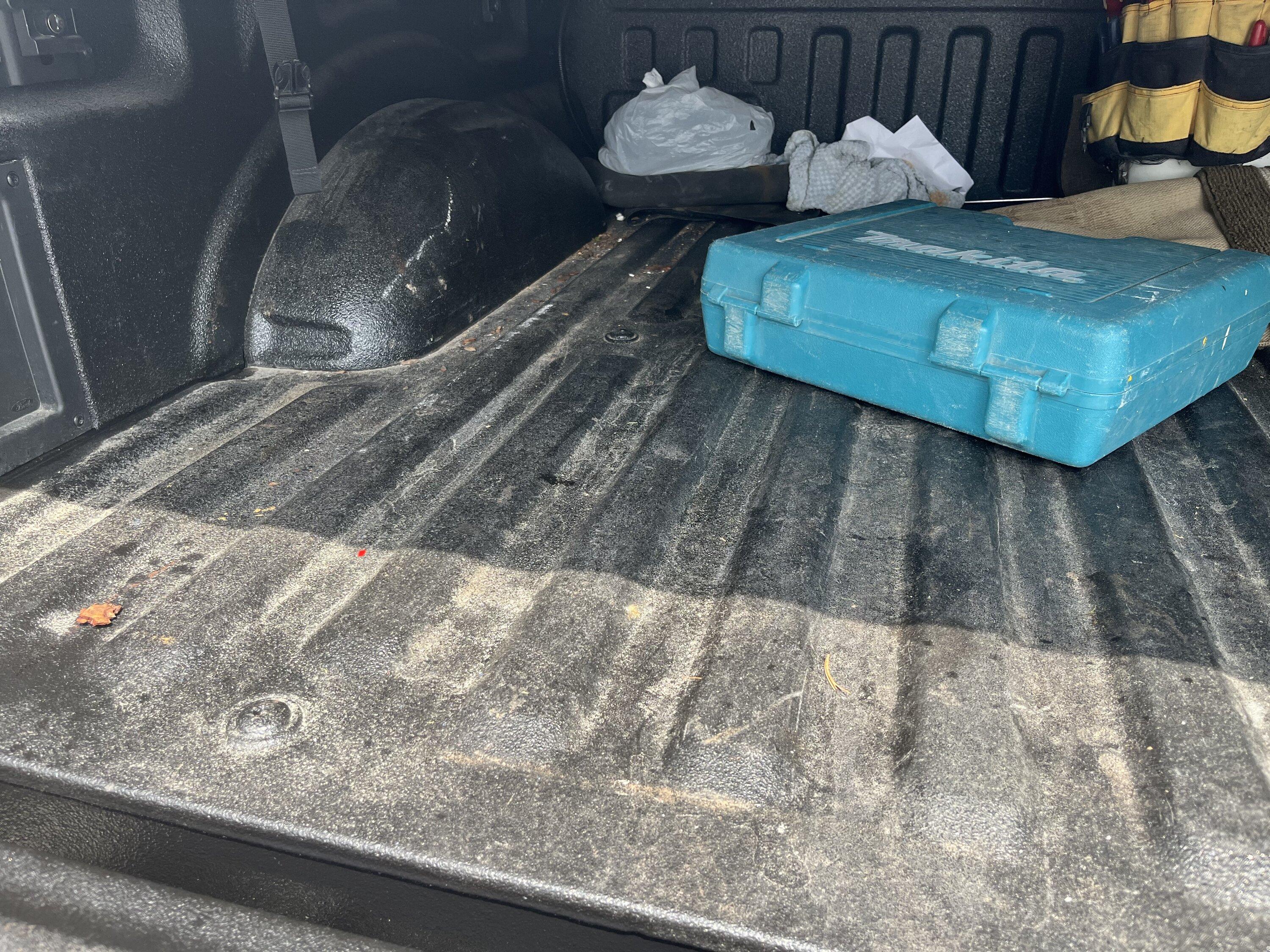

I got lineX sprayed right after I got my truck because I use the bed to carry stuff from time to time. I’m in Toronto, Ontario and for the basic line, I was charged $575.
Here’s after 1 year of use… no washing.
Ford F-150 LineX Undercoating - Worth It? D96BB88E-4C75-43AB-B100-2FD79CA3E453
