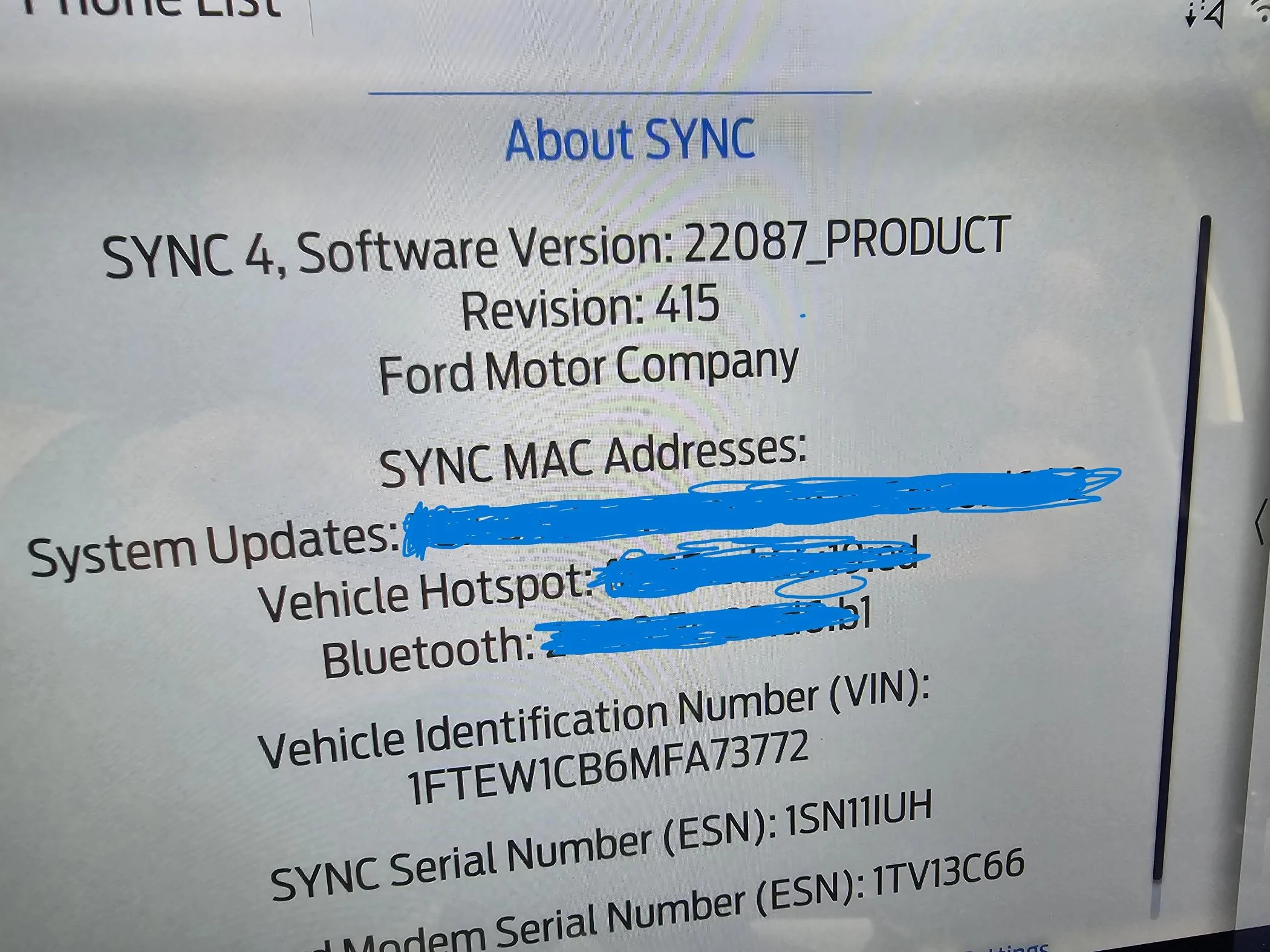

Can you check my Vin 1FTEW1CB6MFA73772
I am on 22087 and have FDRS and a mongoose and would like to know how to get out of OTA limbo.
I have ESP and have spent 400.00 in deductibles trying to get it fixed at the dealer.
Thanks in advance

PTS shows you are on Sync 21233. Post a pic of the "about sync" screen of your truck please. Have you bought the FDRS license and plugged your truck into FDRS yet?
A few months ago, did some updates but no apim, gwm, or tcu was listed as needing updated.
Ok, it seems your truck and the servers have mismatching data. Chances are, you still won't have any of those updates showing. When did you plan on trying FDRS again?

The weekend of May 24, 25, 26th
Ok, we have time. Remind me tonight to check FDRS for you. The data issue would have to be corrected by Jesse before you start FDRS. I know at this moment, he is helping another member out who has a HUGE problem, so we can revisit this before then. We will help you get your truck right.
Thanks
I also have forscan

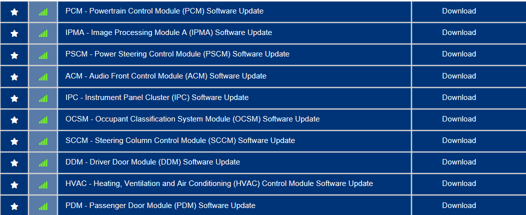

I’d love to know if my truck is behind on any updates on both sides of the system. I don’t know a ton about the process other than what I gathered from the intros
Truck: 2023 f150 xlt 3.5 eb
Vin: 1FTFW1E85PFB79981
I just received ota Priority Update 23-PU1009-SS-NS and it doesn’t seem to apply to
My build at all

OTA dashboard shows 6.4.0 was your last power up update and then a few PU updates before and after that one. List of modules pending updates is below. The SCCM is 6.5.0 and the IPC is 6.8.0.

How do I, as a regular end user get to this information and update my truck completely at home and whatnot?
Also, thank you! I have no clue what the code numbers mean but I will learn I promise. I’m very new to all of this

FDRS thread covers that. $600 of stuff to buy and lots of hours.
You just bought the truck so it's very likely to just update on it's own as you drive it. The important thing to know is you are not missing features. Nothing new has been added for a long time to these trucks. I would in your shoes just ride out the OTA process.
