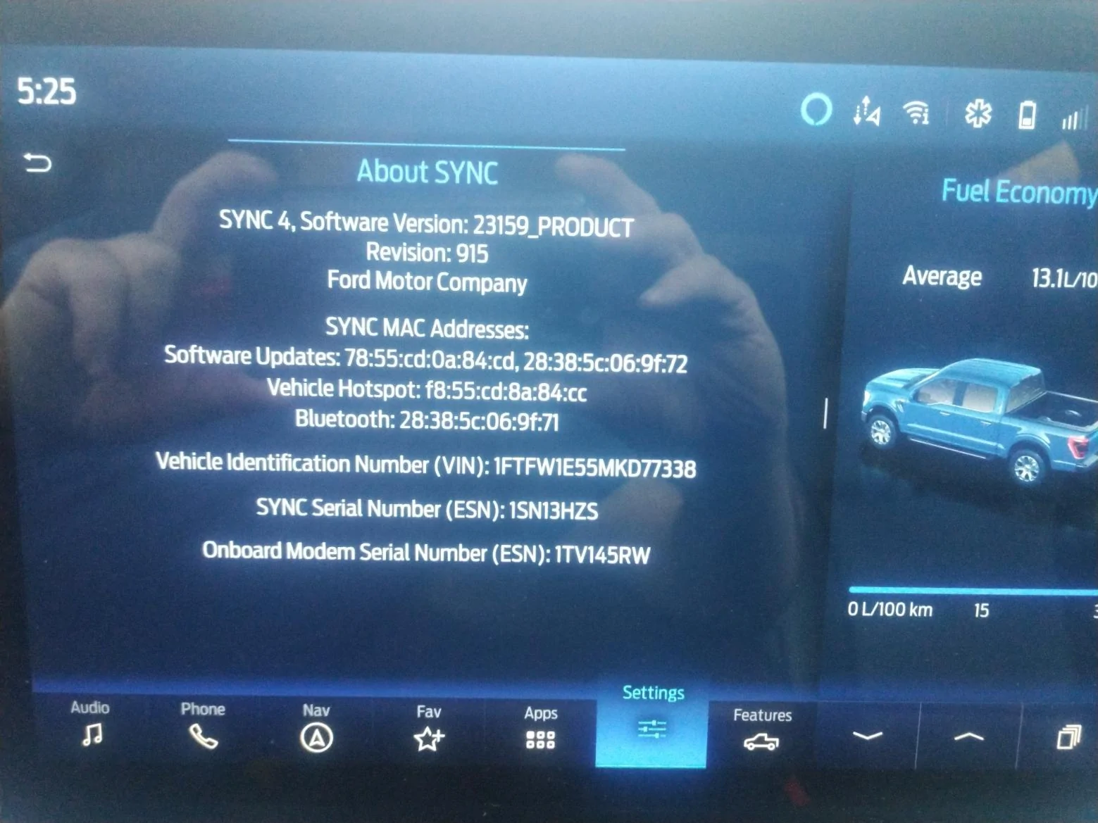

Had my truck at the dealers Friday to fix the Boo-Boo they did in not reconnecting the Propower properly while they had the dash apart to warranty the HVAC vents that the knobs had broken off before I had purchased the truck.
Dealer said that the truck tried to do an update on the APIM Jan 26th but had failed to update. Said it should retry at some point and he showed no other updates listed or any reason as to why it failed.
VIN is 1FTFW1E55MKD77338
Is there anything showing up for this truck that I should be concerned about?
Thanks for the help gang!
I see no indication that the tried to update the APIM or anything else. APIM update 23-PU0724-DOM-RS has been sent to your truck three times and failed all three. The most recent failure failed due to a "release notes validation error" which is something I have not seen before and I am not sure what that means. What is strange is that the Sync page in PTS for your truck shows your truck got an APIM update on 1/20 that brought you to Sync version 23159, but vehicle history on that date does not show your dealer updating anything. That is a bit confusing. What Sync version does your touch screen say you are on?
Have not seen any signs of an OTA update since you and Jessie helped me out with the failed update last October and the sync screen is showing the same info still on version 23159.
Dealer did not attempt any updates, they just fixed the mechanical issues in January to replace the HVAC knobs, then Friday to reconnect the ProPower jack that they did not plug back in properly in January.

I had to back to see what it Jesse needed to do and I remember your case now. Remind me tomorrow to dig a bit deeper into your situation. FDRS shows you have a GWM pending, so I think you're good and just need to wait for the OTA roulette to get to you.
Today Mar 4, 2024
Oct 4, 2023
Your truck is fine. The update Ford is trying to send you is failing because you already have it. You just need the GWM to be sent to you instead of that APIM update that keeps failing.
