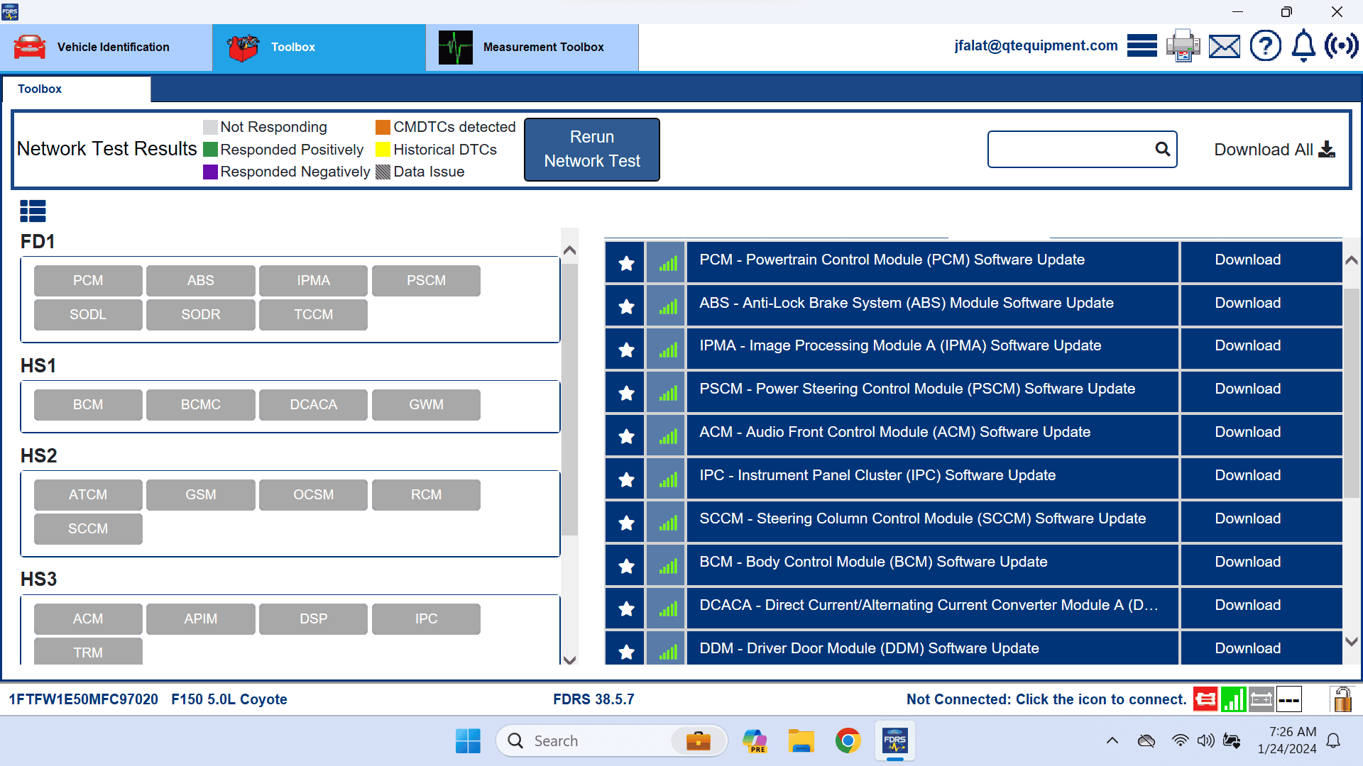

Crainstyle
Ryan
Jan 23, 2024
Orlando, FL
F150 2021
looks like a few.
Thank you. I have auto updates on but I don't think they are working. The status says not complete and no other updates are scheduled. I am not able to do any manual downloads via Sync. How can I force these uodates?
One way and one way only: FDRS and a Mongoose. Otherwise, you are fully dependent on the OTA process.
