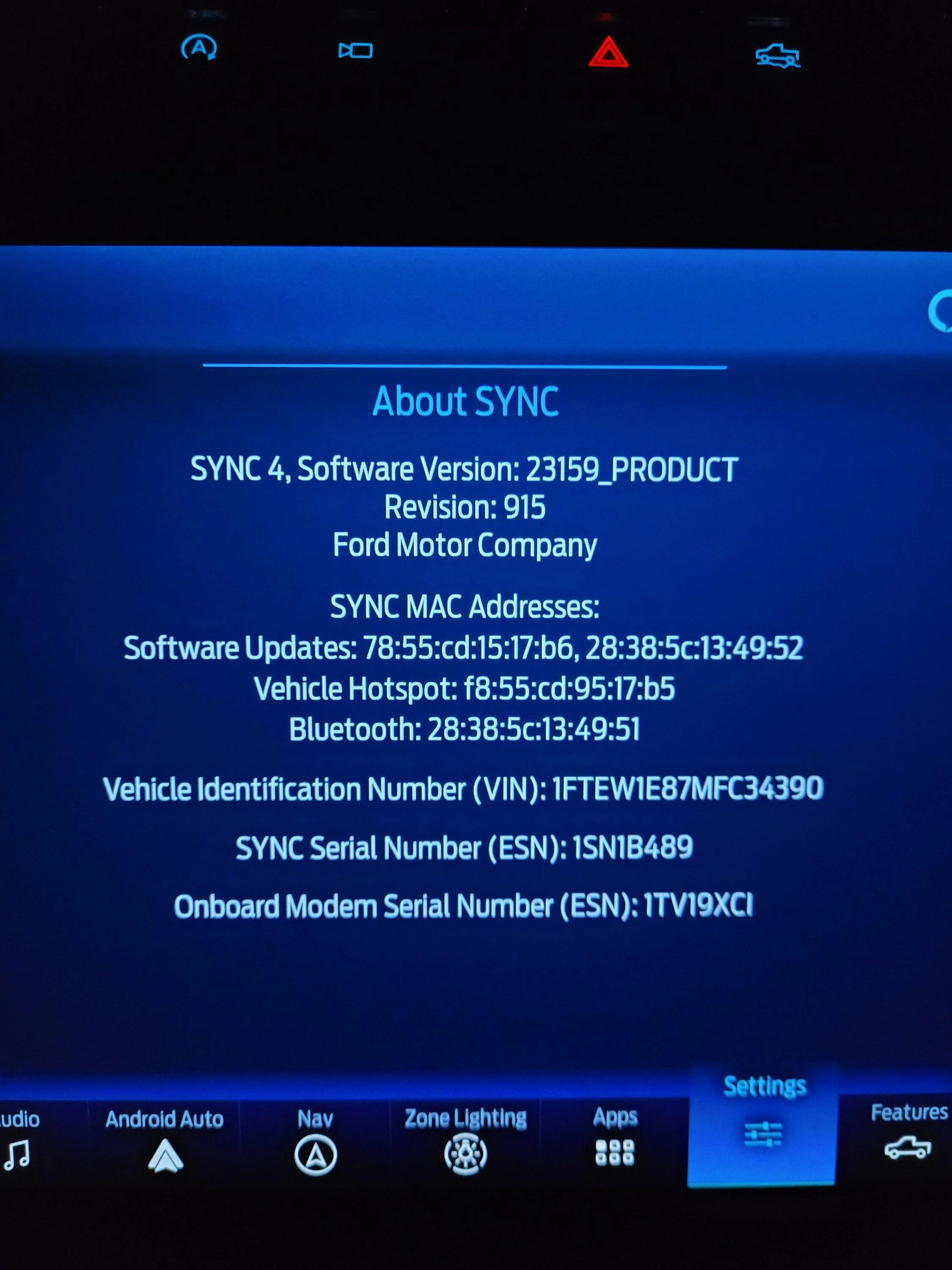

TexasTea
Dec 14, 2023
Here
2021 F150 Tremor 402a
Hi all. Came over from the f150 tremor forums to investigate
VIN
1FTEW1E87MFC34390
Ford account online has the triangle saying there's updates...
Of course the truck says there isnt.
Got 2.7.4 a couple weeks ago... Seems out of date, no?
Really really appreciate those who can check on this stuff... Seems the software OTA is a bit of a disaster!
VIN
1FTEW1E87MFC34390
Nothing to worry about. It's known. Ford released a BCM update with the same 2.7.4 revision from an old IPC update. Not sure what they were thinking, but it is documented on the OTA history thread stickied here.
TexasTea
Dec 14, 2023
Here
Preciate it. There's a lot of threads about OTA here so I missed that one. Thank you
