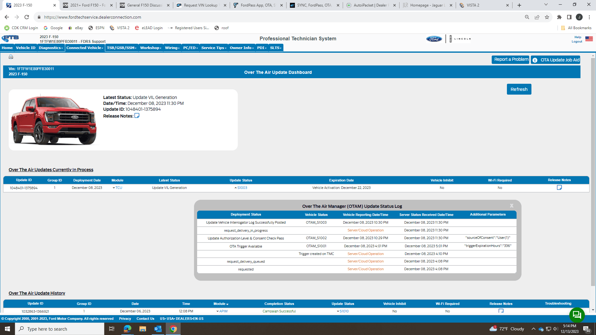

i received a FordPass message on 12/6 that i had gotten 6.2 redo. today i check updates in my truck it shows 6.4. No FordPass message. I’d appreciate your checking my vin so i can wrap my head around all of this….LOL
23 Platinum 3.5 EB
The short answer: Fordpass messages are unreliable at best.
I see 6.4.0 is in your queue, but it seems to be hung up not doing anything. The log posted on 12/8, but the manifest hasn't posted yet for the files to be verified before they download. Not sure what's going on.

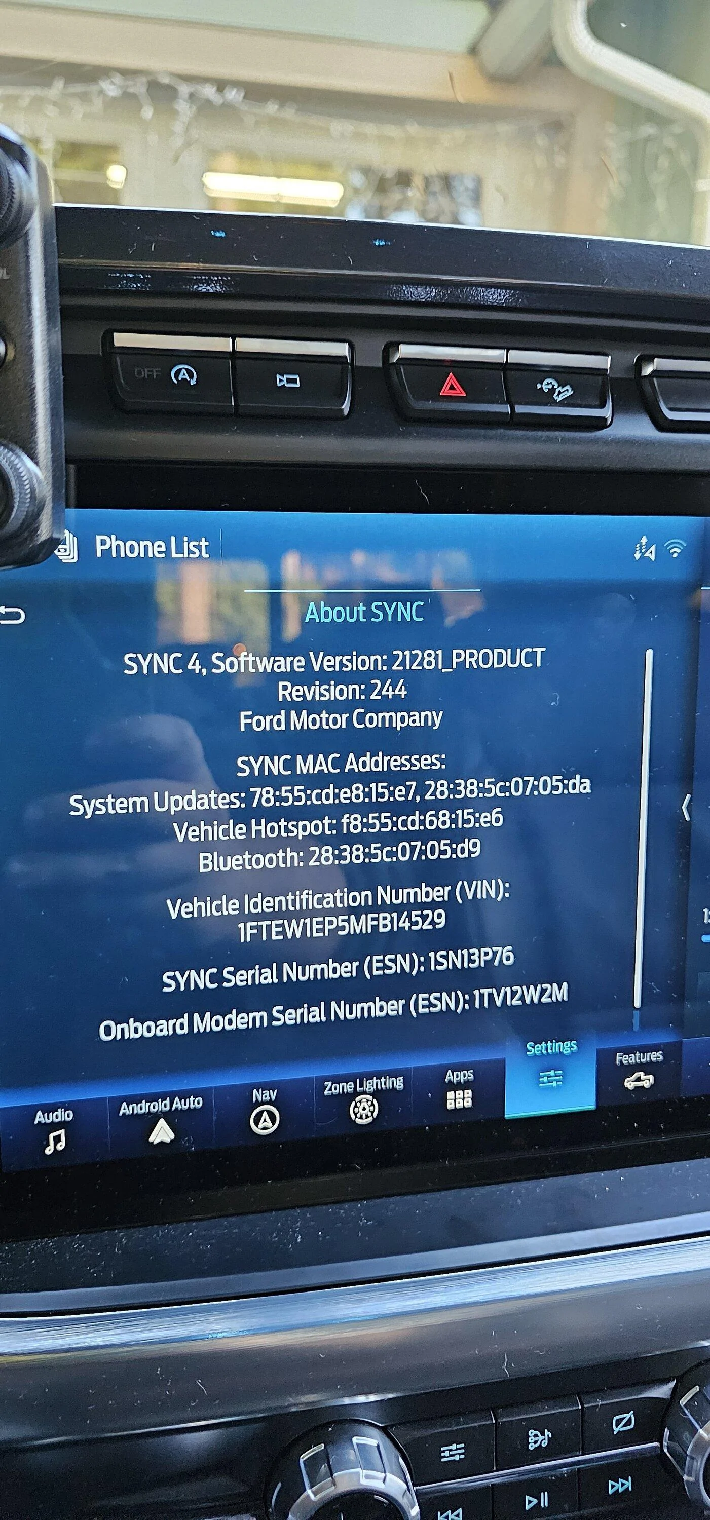

Possible to check my vin as well? Picked the truck up about two months ago and still no updates and no full screen android auto. My dealership said there's no updates pending but checking online I'd love to have more/better information!
1FTEW1EP5MFB14529
PTS shows Sync 21281 was installed on your truck using FDRS in Feb of 2022, but vehicle history does not show your truck was connected to FDRS on that date. OTA history shows 2.1.1 was sent to your truck in March, but that update is older than the Sync version your truck is on. Something seems off. When you can, post a pic of the "about sync" screen in your touchscreen settings.

Thanks for taking a look so quickly! Definitely appreciate all the background information to learn more about the "new" truck!
Here's a shot of the sync page from a couple days ago when I started researching the problem a bit. Do let me know if there's any other information I can help to provide!
