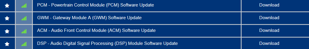

I guess I am trying to see both. What OTA am I missing and what modules have not been updated. I saw that there was a voluntary paypal account to send a few bucks for your time looking things up. Can you point me to that previous post with the info?
1FTFW1ED4MFB96960
Last OTA in your history is 3.5.2, so you are pretty far behind. Your next OTA would be 3.5.3 which gives you full screen carplay/android auto. List of FDRS updates pending modules is below:
Ford F-150 Request VIN Lookup Thread 1698067201688
The APIM update you see there would be 3.5.3. Once that update is done, more will pop up on that list.
I have never had a link to my Paypal on my sig and I will never have one. I do not do this for money. With that said, I appreciate the gesture.

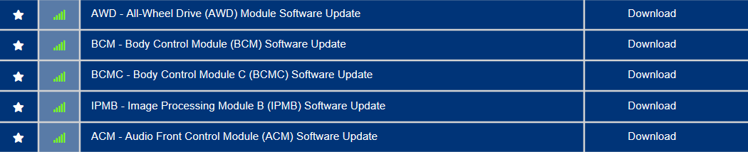

Can you check 1FTFW1E81PFC39979. I should be up to date but you never know
Modules pending updates are below:

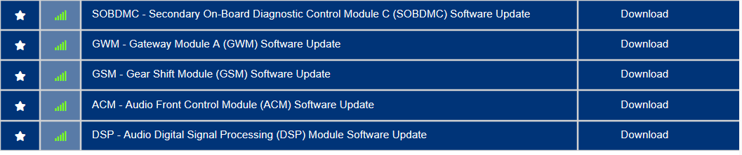

yesterday I received 4.3.6 do you have any time to check FDRS for me ? 1FTFW1ED3MFB23739
Ford F-150 Request VIN Lookup Thread 1698070532362
