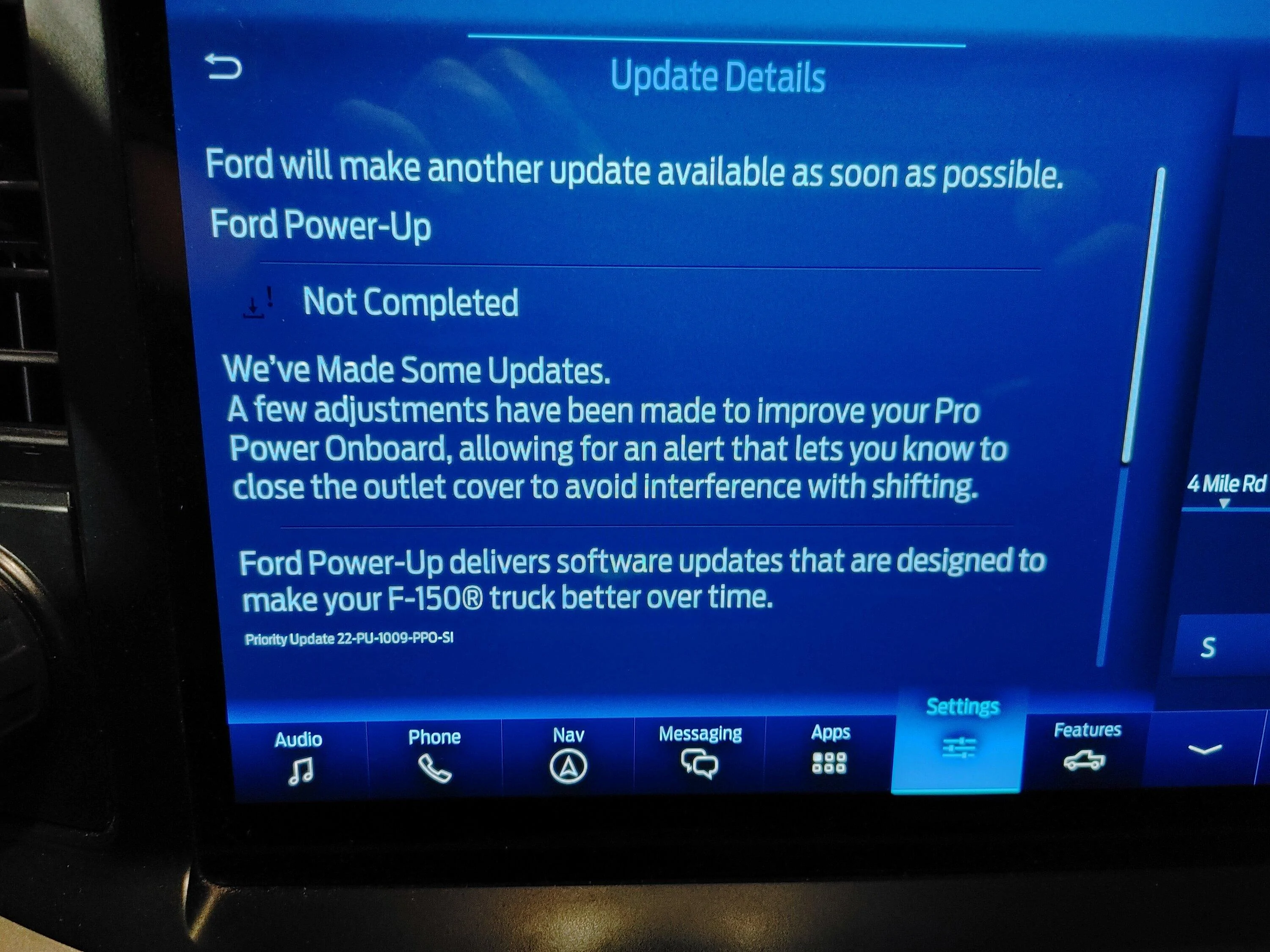

@rugedraw - I just had a look at my truck to make sure Auto Updates was on and checked the updates....
It shows
Ford power up not completed referencing 22-PU-1009-PPO-SI. Could you have a look and see what failed please?
1FTFX1E81MKE01710
Thanks

Weird. PTS shows it went through without issues.
Thanks...maybe will do a hard reset on Sync. See if it clears.
Edit; I tried hard reset - still showing this error. Because it was a PCM update - may need a PCM update to clear it. Also, as this was a Pro Power update, which I do not have, that can be the reason as well.

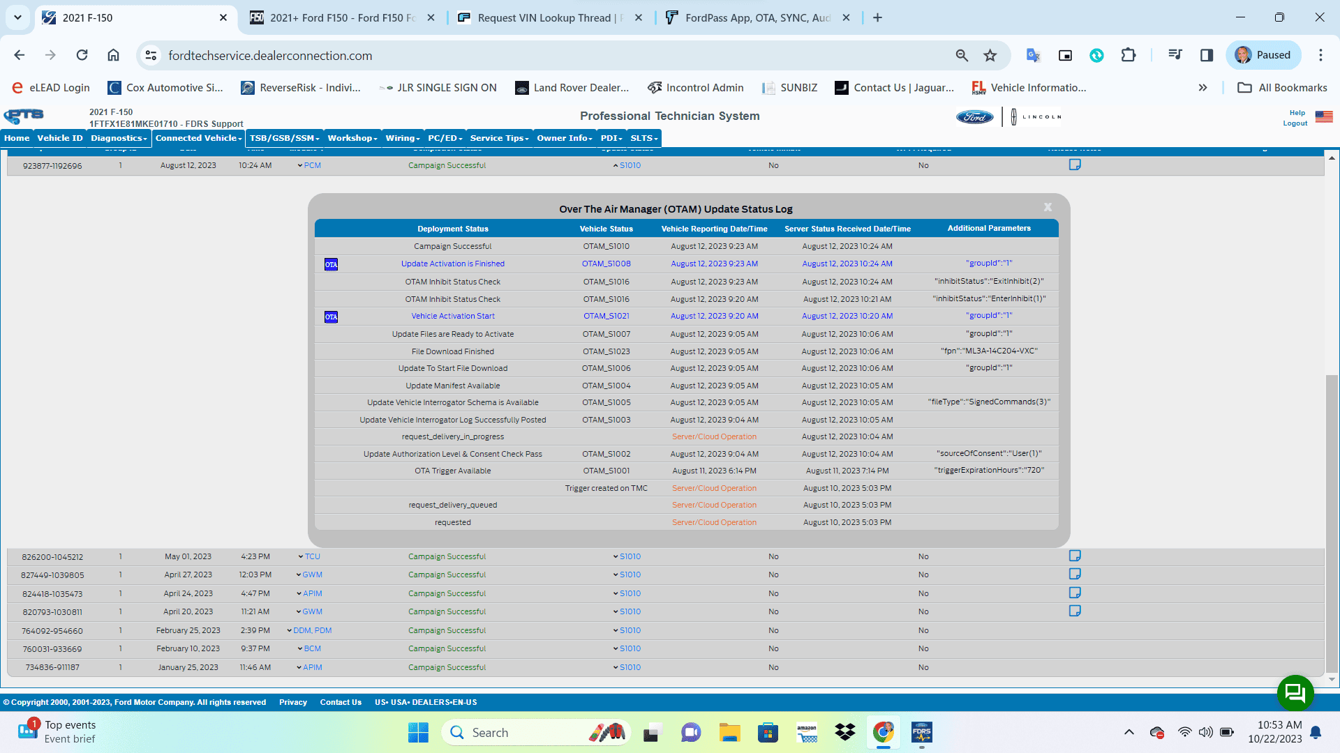

Ford F-150 Request VIN Lookup Thread 10222023
Hey folks. Been away for a bit. I have my year long FDRS for another 6 days. Are any of these worth loading? Any issues?
If you have audio issues, the DSP and latest APIM seems to have fixed my weird audio pop sounds when using any camera view. I did DSP months ago and APIM came in OTA.
I would install them all in your shoes just to take advantage of having the subscription. Less waiting for the OTA version to come in.
