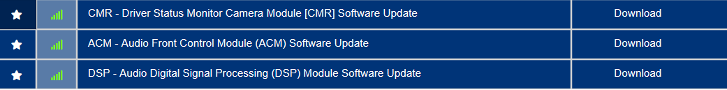

Can anyone help with this error? I was able to do a couple of GWM updates earlier in the day without issues. Thanks.
Ford F-150 Request VIN Lookup Thread IMG_0093
