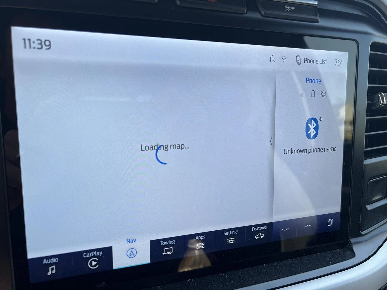

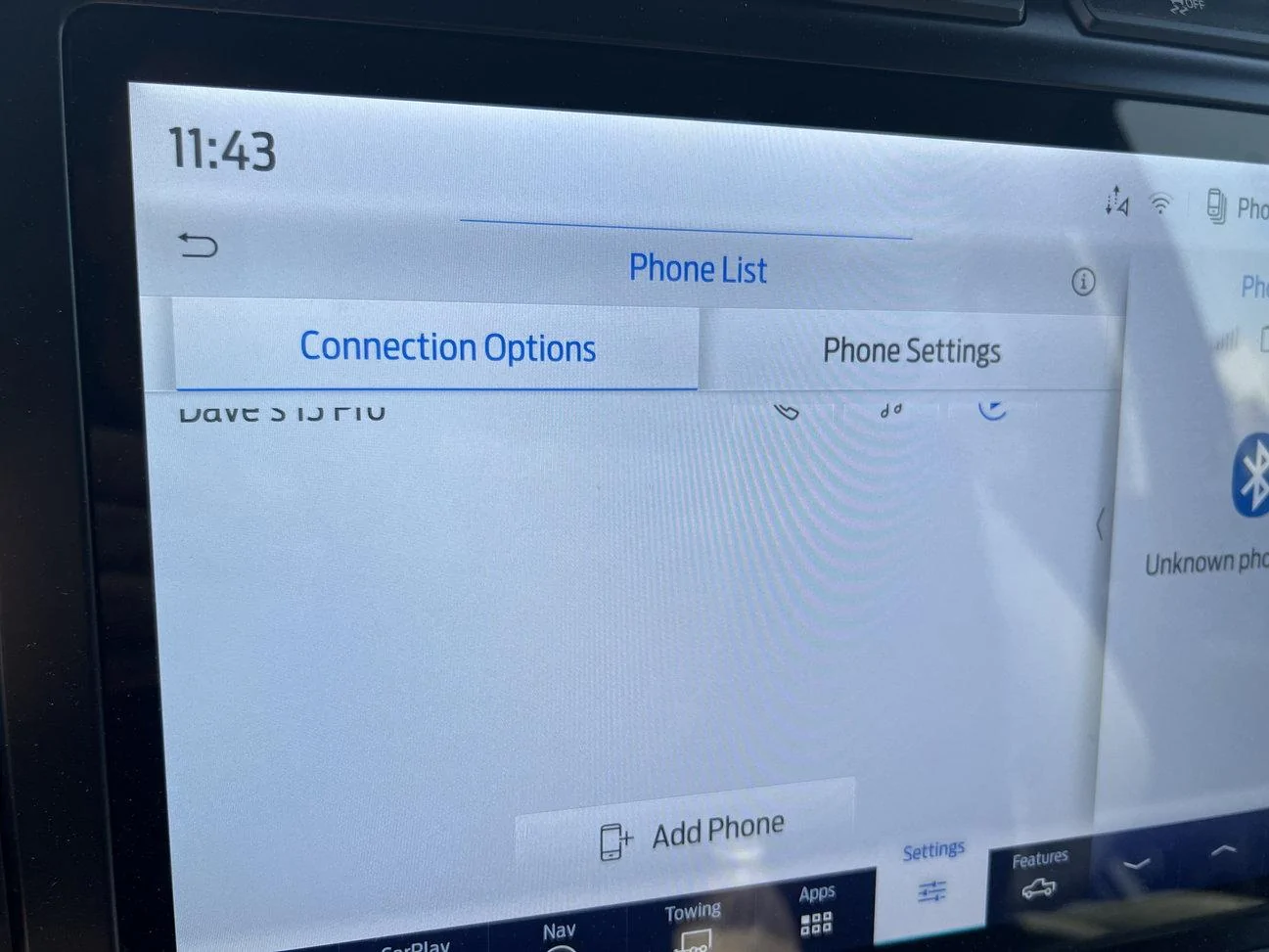

This truck belongs to a member on F150forum. He has been updated via OTA up to 4.2.4, but he says he has no cameras in motion. At first, I thought his truck skipped over the updates, but after going through his FDRS history in PTS, it shows the dealer updated all modules back in October of 2022, so he should be able to use cameras in motion. I am wondering what GWM update this is since he did receive 4.2.3 successfully according to PTS.
Nvm, I confused his truck with someone else's. His problem is his maps aren't loading and he has overlapping texts on his Sync screen after getting OTA 4.2.1.
Ford F-150 Request VIN Lookup Thread 1687799932202
Looks like his APIM updates failed to install... So it's stuck in a partial install state.
Have him send me a PM and I can possibly help him get the updated files to install himself
Partial install? That would explain why PTS says he is on Sync 23031 even though PTS recorded the failed OTA. I don't think he has account on here, so I will tell him to make one. Thanks for your help.
