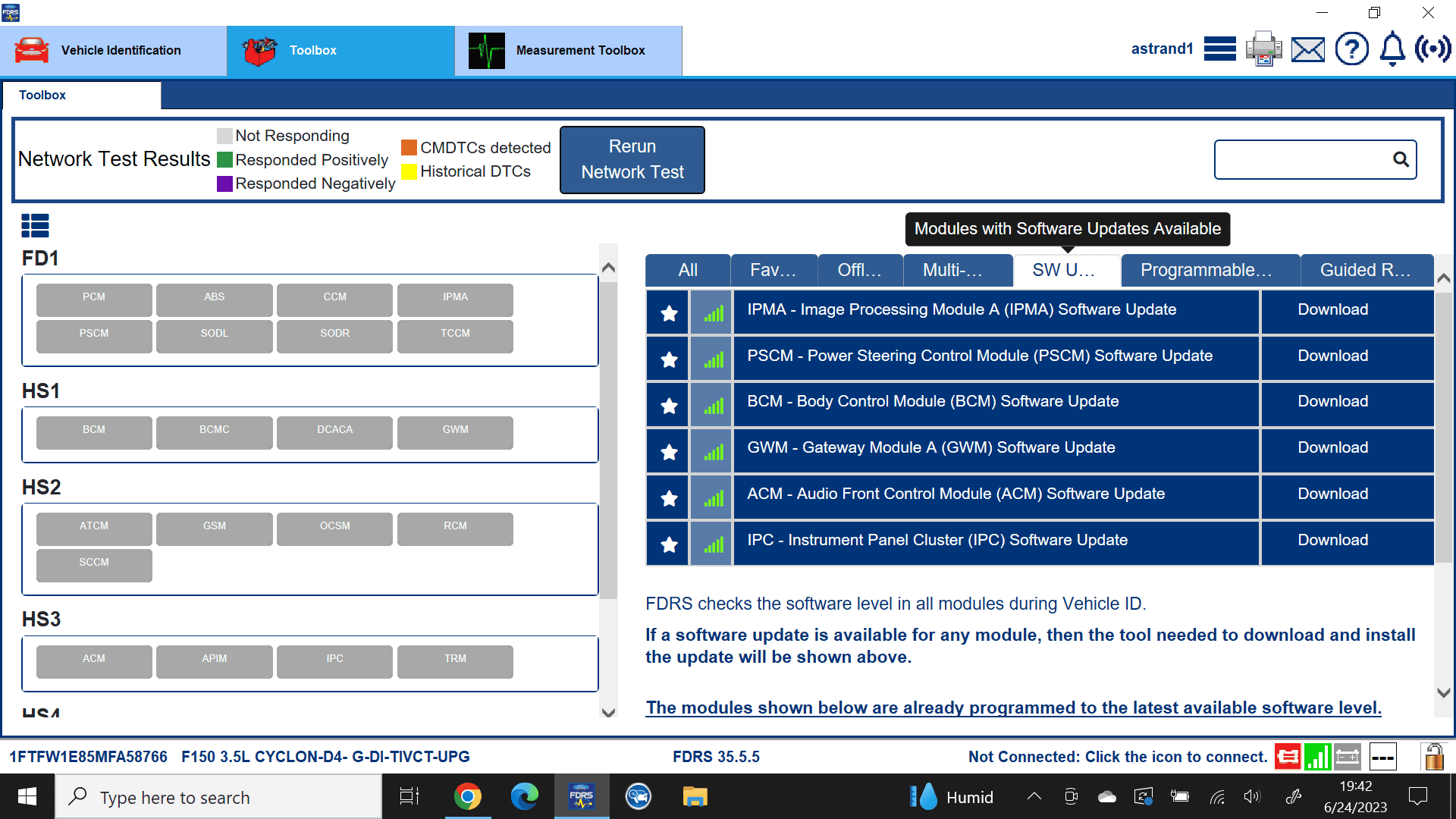

2021 F150 XLT 3.5L Eco Boost - Job 1 1/21
Alright, just got back from the dealer with the third APIM. If someone would please look mine up before I buy a new license.
VIN: 1FTFW1E85MFA58766
I see the performed a successful PMI on the new APIM and they actually performed several module updates to several important modules. You are now at Sync 22177 and out of OTA purgatory. You actually got sent OTA 2.1.1 just yesterday. While you are still very far behind, with FDRS, the update process will now be very straight forward for you. Do it to it.
Awesome, thanks for confirming!

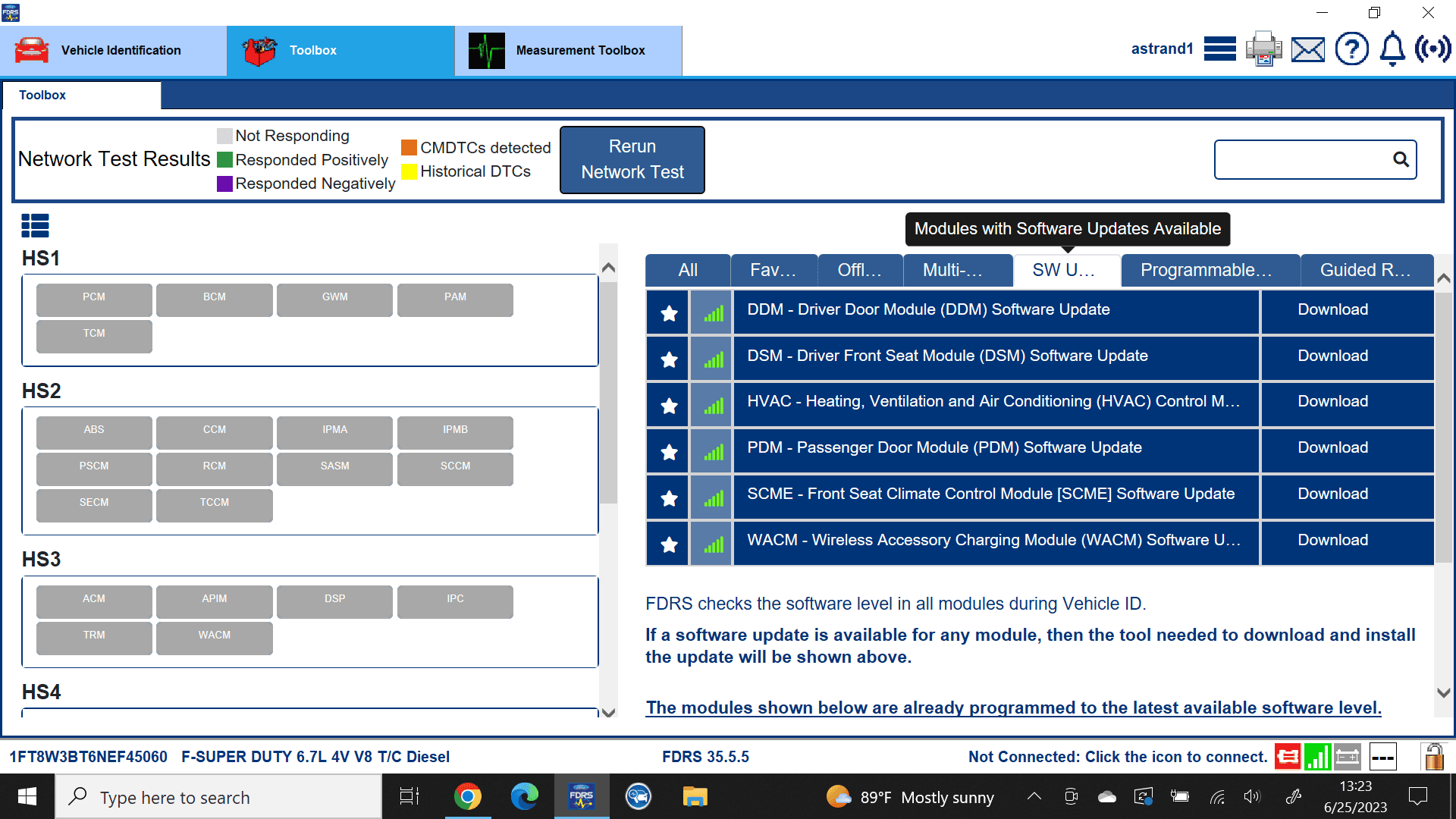

PDay1213
Phil
Jun 11, 2023
2022 F350 Super Duty
VIN lookup request: 1FT8W3BT6NEF45060
I’m taking to dealer next week for some work to be done and if anything needs updated in FDRS. Having problems with the wireless charging pad on my iPhone 13
Thanks I appreciate you guys help.
