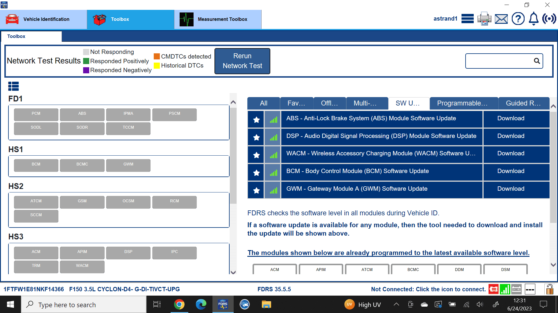

Hey there, I just picked up my new F150!
I heard full screen CarPlay is now available via software update, can you check the vin and let me know if that update will come for me? I can be patient, but want to make sure I’m not waiting for something that won’t come without intervention!
VIN: 1FTFW1E81NKF14366
Thank you!

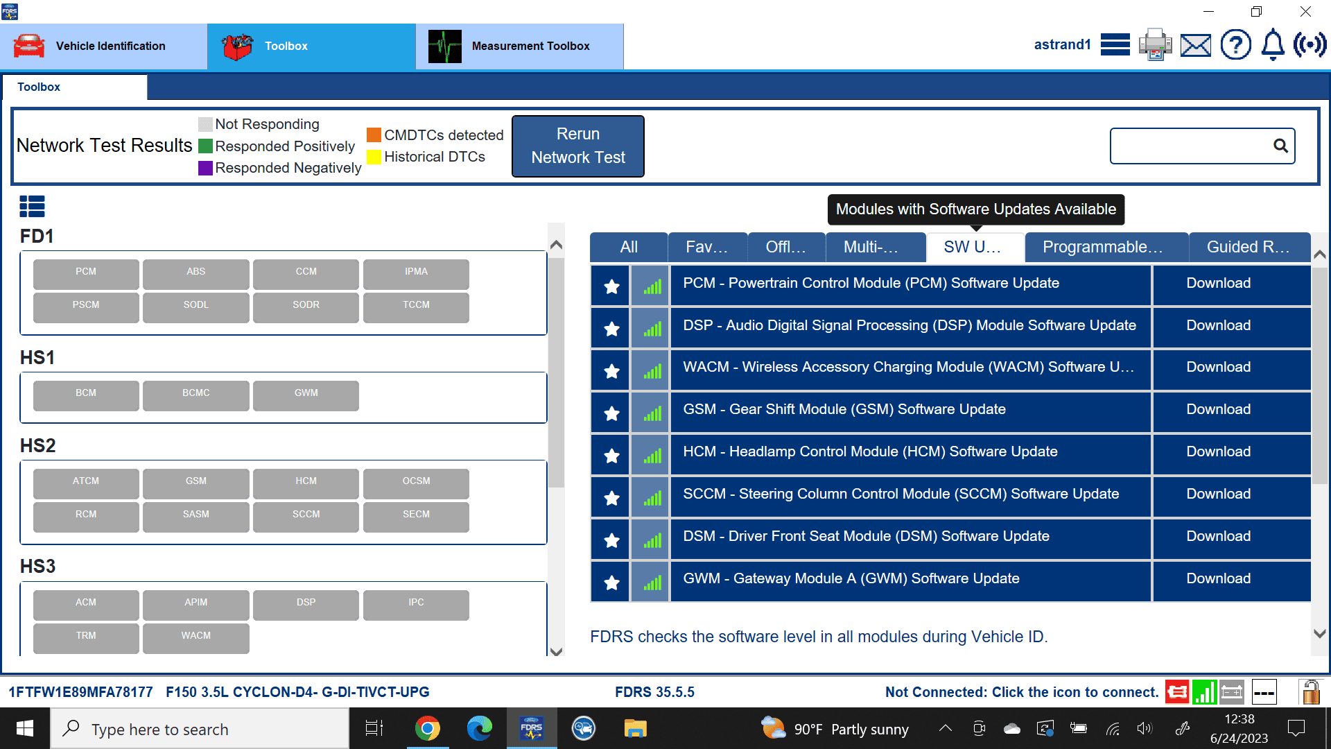

Can you please check VIN# 1FTFW1E89MFA78177 ? Last OTA I received was 4.2.4 on 5/2. Just want to make sure I do not have any OTA failures.
Many thanks!

Sorry if there are instructions on how to read this, but is this good or mean I have updates pending that I should have received? (I'm viewing on my mobile so hard to see)
Your truck is on the latest sync software, but there are some modules that do not get updated OTA. I can't tell from looking at this or PTS if your truck skipped over updates like has happened to a lot of people. If you can turn on your rear camera while driving, you should be good to go. If you cannot, then your truck possibly skipped some updates.
astrand1
Alex
Dec 16, 2021
833
606
22 Ford F150 Powerboost 7.2kw
Studio truck driver
These are updates that are ready for you’re truck. I’m looking these up on FDRS so as far as pending OTA updates I don’t know.

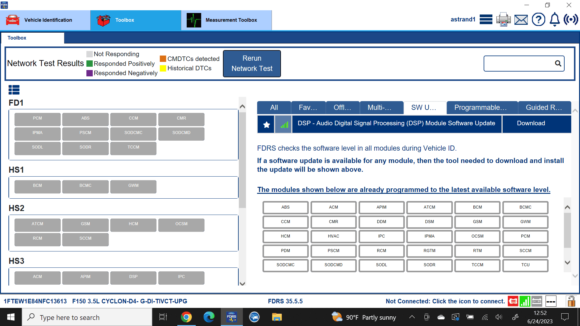

Could someone please look and see if I have any updates? i finally have a couple of days to do updates if needed.
1FTEW1E84NFC13613
Thank you!
