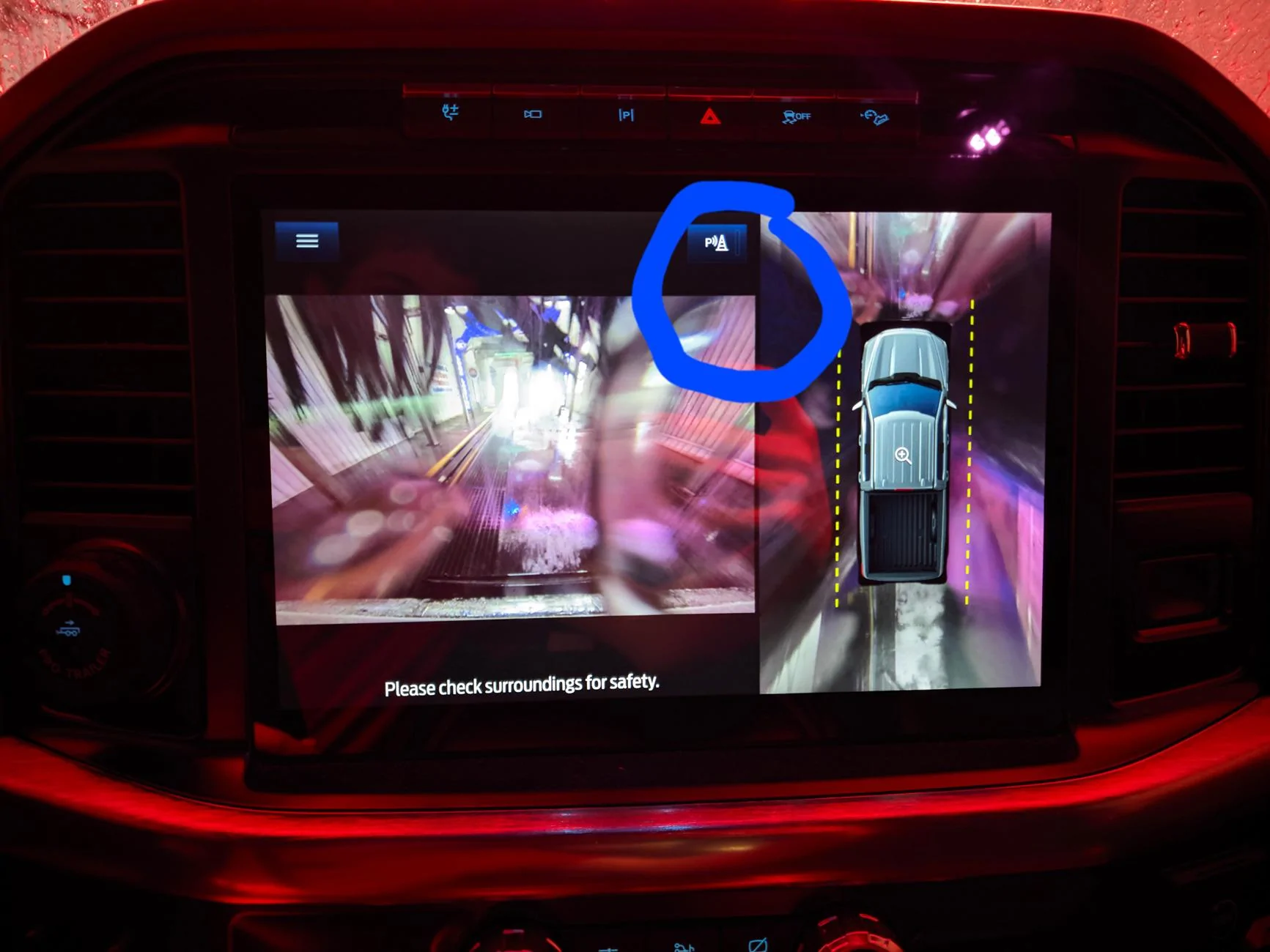

I've had it a couple times before and figured out what was causing it in my situation: I turned the parking sensor alarms off when I was going through a carwash, as my truck has the 360 camera package and it always pops up thinking I'm being crashed into from all angles, but then I drive home and reverse into a parking space and that same message pops up, and I figure out that it'll go away if i press that same toggle to turn it back on when the revers camera is up.
