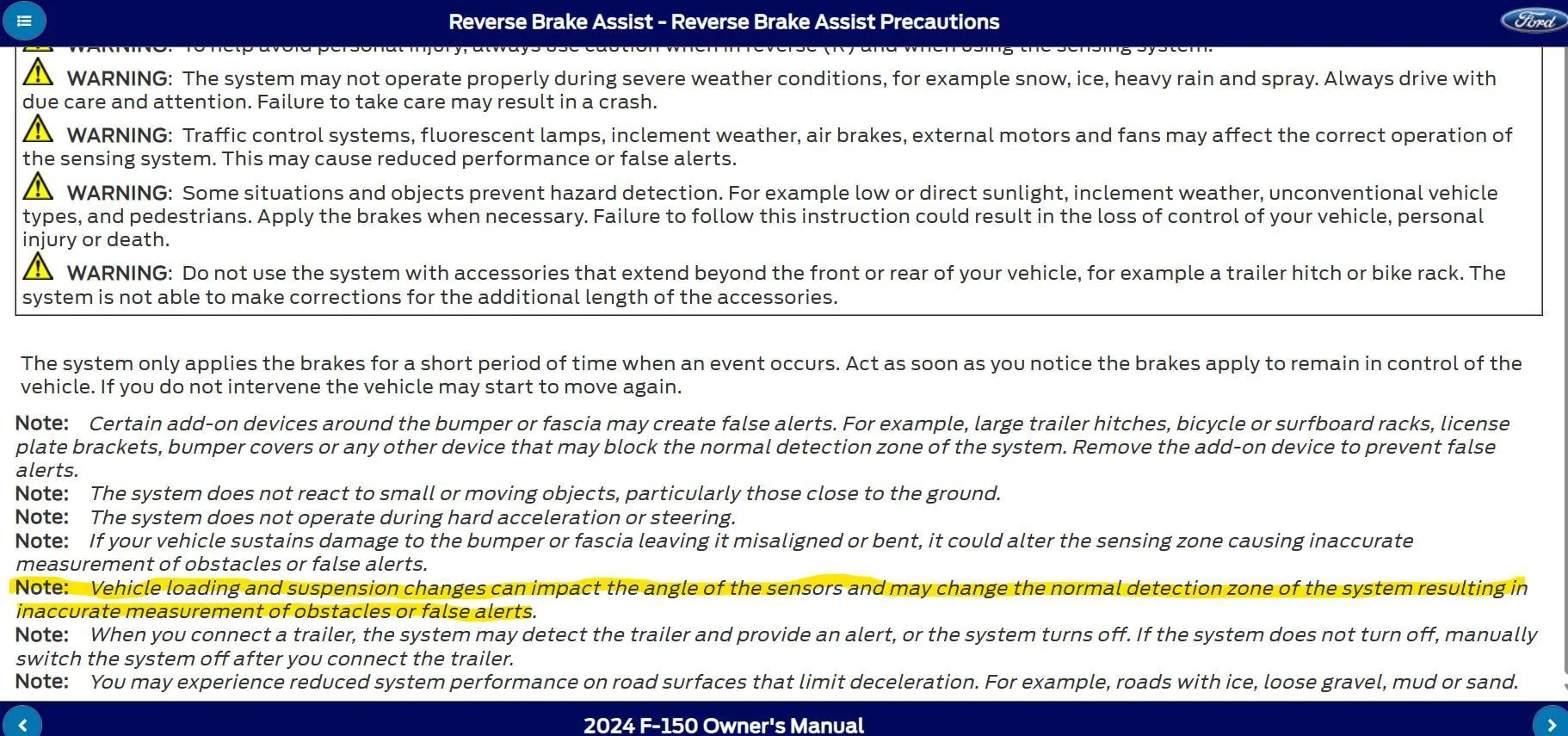

Hi there, I decided to just turn off the setting. Now when I back up, I only get a pop-up window saying the system is off, and not the annoying chime it would do. I decided to hold off on getting the sensors adjusted because I was still adjusting the right height on the truck. I tried the slammed look, the minimal drop look, and the happy medium where I have it now. It rides great, has the clearance I need for my driveway, and still has the lowered look. I will be posting an update with the rear end. It took many adjustments to finally get the truck to ride as good as it looks.Hey did you ever get this fixed? I just installed my ridetech lowering kit and having this issue now.
