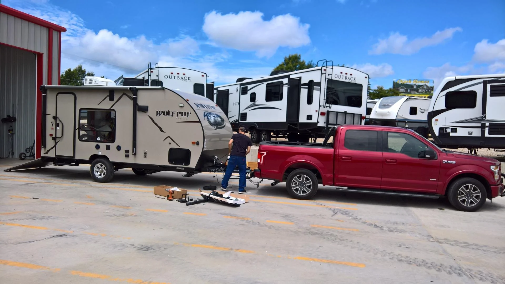

I don't think I have ever heard similar issue with the 2.7, but then I don't think it would be common for a 2.7 to be in the same exact circumstance.
Not a slight on the 2.7
I've had one myself and used it to haul my little 17' toy hauler all over those passes in Colorado.
