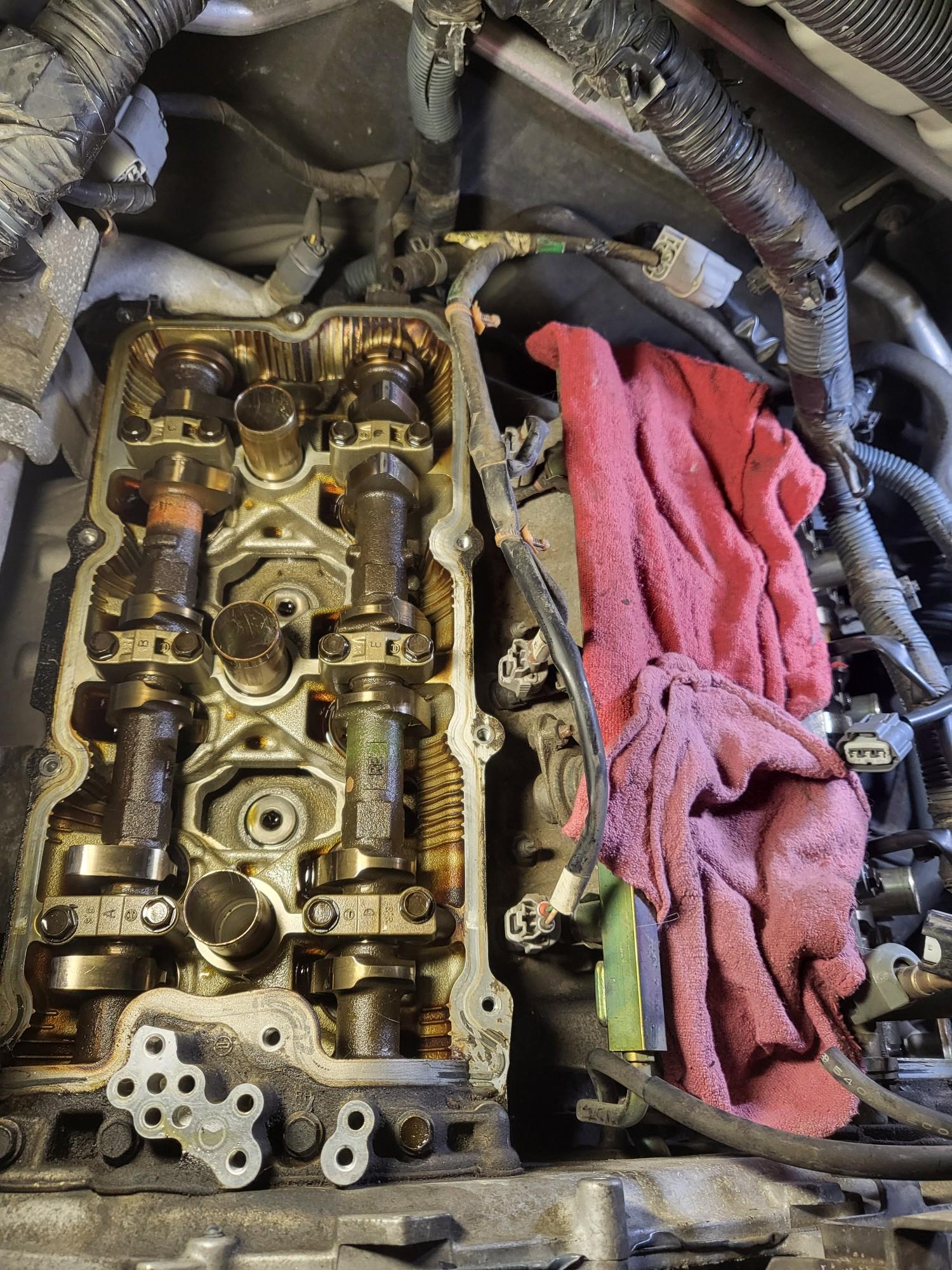

Not a Ford but the wife’s 05 Pathfinder we bought brand new in 06 with free lifetime oil changes from the dealer just had the valve covers and gaskets replaced. Mechanic sent pics to me and asked if this was original motor. ? I told him everything else has been replaced, but the motor which is literally true, changed oil every 3k and we just clocked 277k on it. I thought it was impressively clean in there.
