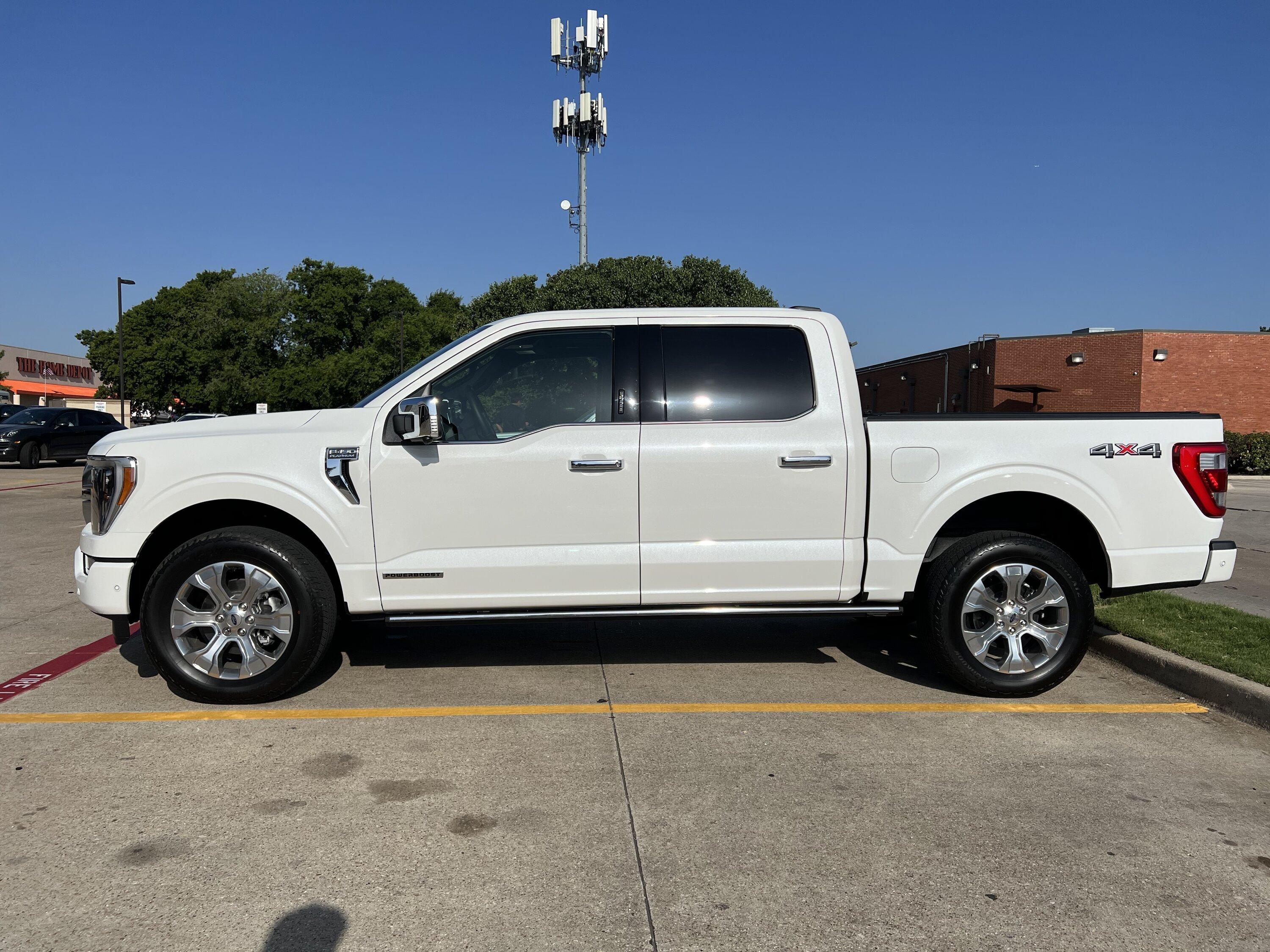

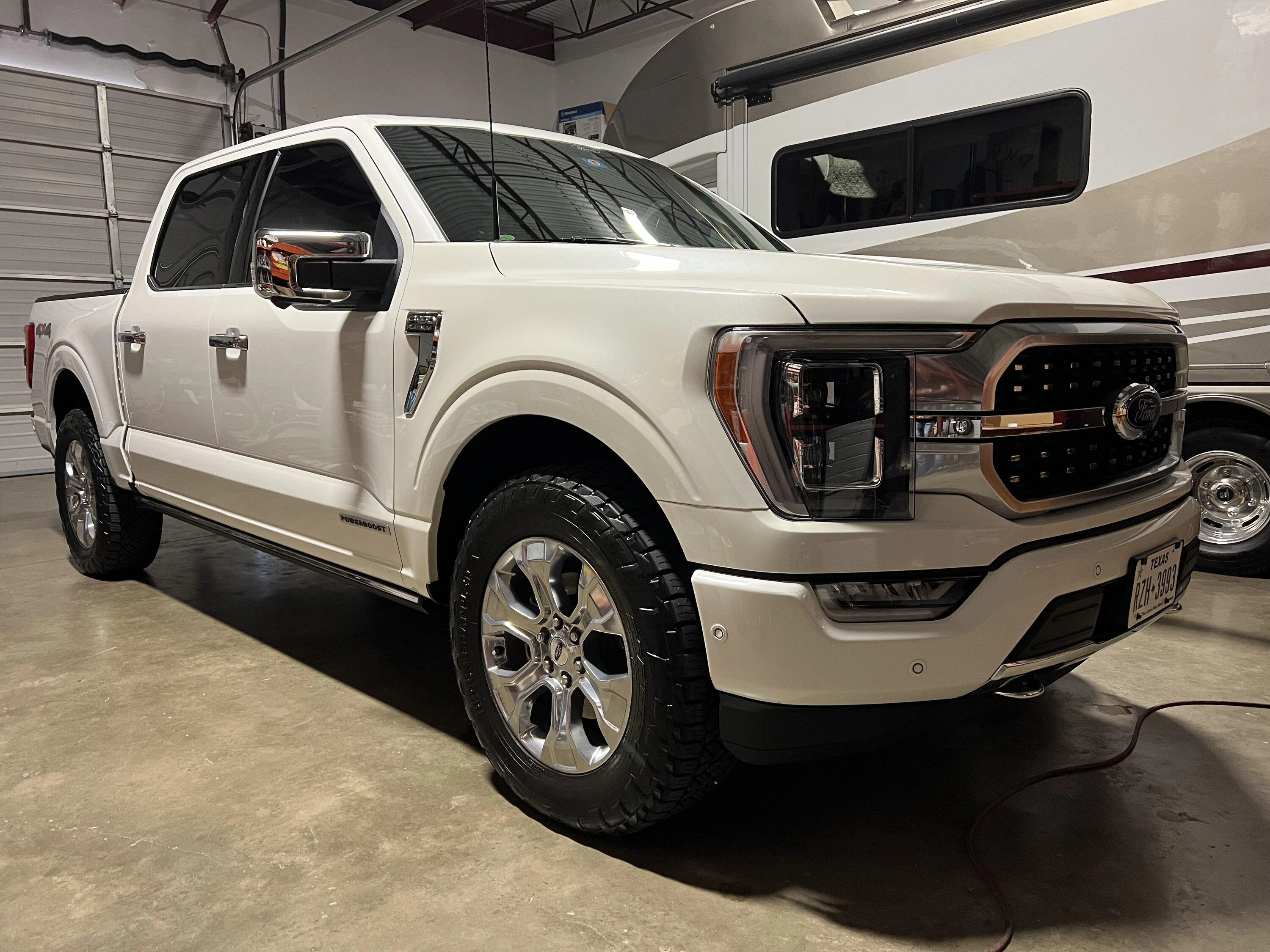

I put LT285/60 20 Nitto Recon Grapplers with Fuel Blitz 20x9 wheels +20 offset on my 22 Lariat PB with a 2” Roush Fox coil over kit on a few months ago and get between 19-20 mpg average I was getting about 21 mpg with the stock Goodyear AT tires. Great tires.
Ford F-150 Powerboost Aftermarket Tires IMG_0362
Ford F-150 Powerboost Aftermarket Tires IMG_0361
Those are some nice looking shoes! They have just enough offset to look aggressive but not over the top. The tires too. I’m still on my stock Hankook AT2’s at 38K. They have been great to me so far. But I’m not an off-roader so I prefer the highway biased tread on the Hankooks. My average mpg has been 22.3 over the past 30k miles which includes hauling to N. Dakota & back to N Texas and some hill country trailering. When just cruising around North DFW area for work I regularly get between 23-24 and occasionally 25.
I would try some slightly more aggressive tires but don’t want the noise and reduced mpg. BTW, mine’s a 21 XLT 4x4 Sport 302A PowerBoost highly loaded.
