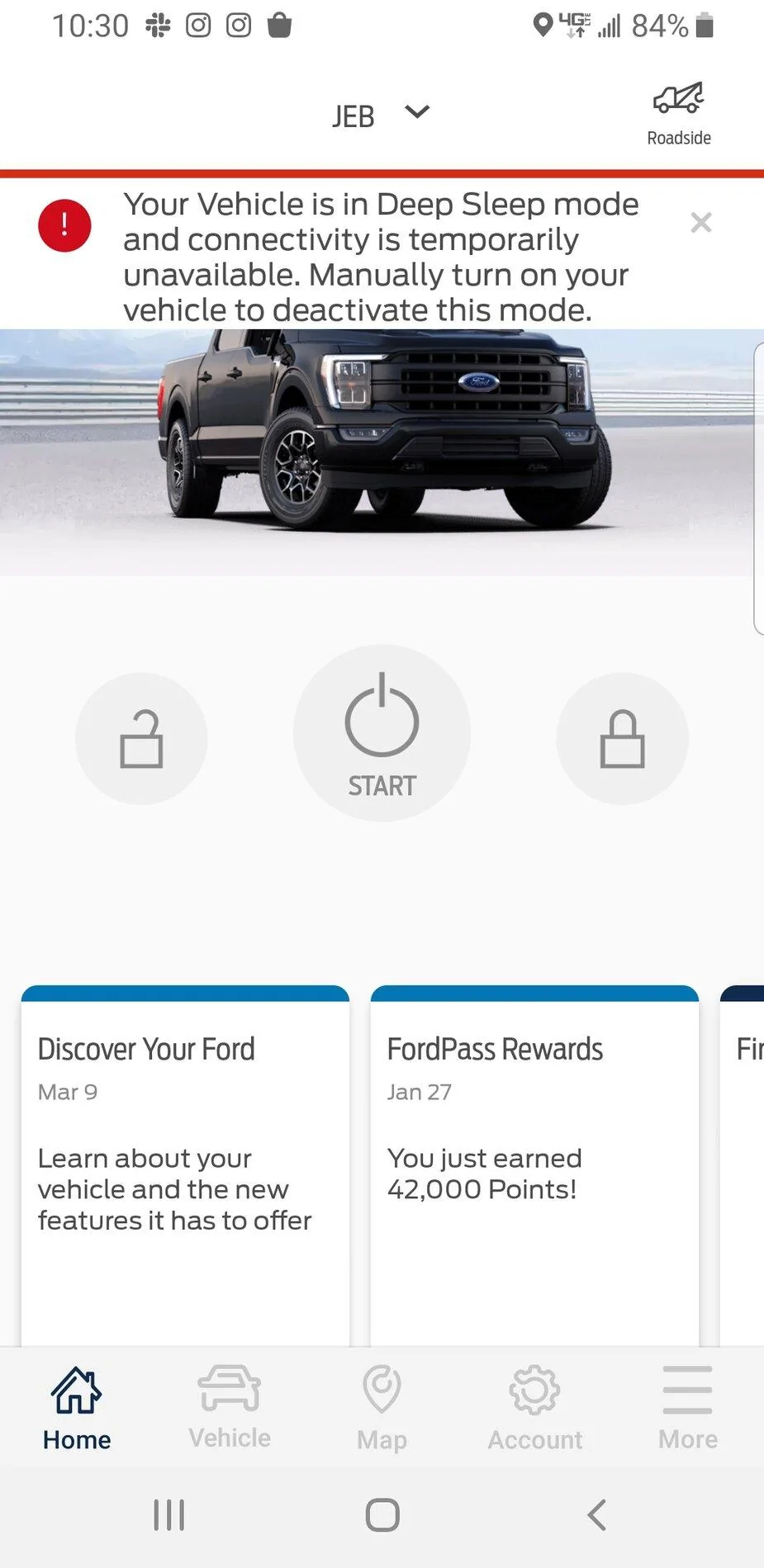

After sitting for 2 weeks. New battery and zone lighting disabled. Truck I deep sleep mode
Ford F-150 Phantom Battery Drain Issue in 2021 F-150 confirmed by Ford  -- "Deep Sleep Mode" [News Article] Screenshot_20210319-103008_FordPass
The truck goes into deep sleep when a long period of time goes by without use. Not just dead battery. When my 2020 sat for about 2 weeks it would do the same.
question is we’re you able to start it? Is the battery truly dead or just in a deep sleep state to conserv?
Interesting, with the Ford Pass app could it be causing your issue?
Were you able to manually start the vehicle like the app suggested?
Can you turn off deep sleep mode in the settings somewhere?
Unfortunately I'm on vacation still until Monday. I'll find out if the battery is dead then.
Any time I received the “Deep Sleep” mode via FordPass, my truck needed a jump. I hope this is somehow not the case for you.

Or be sure you have your NOCO jump starter in your truck before you get to the airport and park it for several days.
Luckily I have a wonderful daughter picking us up at the airport while Jeb is in "deep" sleep at home. I guess Fords need lots of quality sleep.
Ok. Let us know when you get back if it’s truly just a sleep or dead. Hopeful it’s a true sleep mode issue and not a dead battery again! ?
