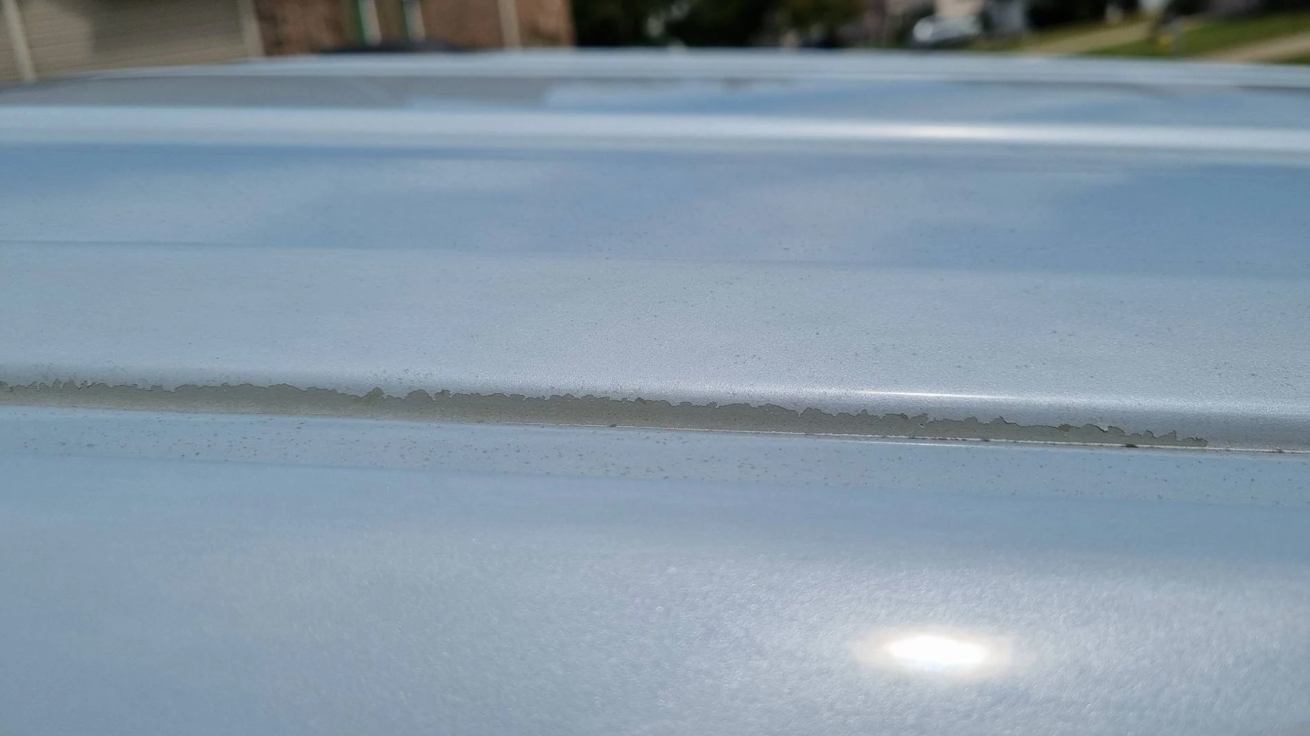

Ford F-150 Peeling Paint 20240908_142727
This is the original one on the passenger's side. The new peeling on the driver's side is in the same location and is much smaller.

This is the new damage that started when they pulled the tape.
Ford F-150 Peeling Paint 20240919_190053
This is the aperture panel, circled in red. The green arrow points at the damage location.
Because part of it is hidden in front of the bed (Yellow), they will need to remove the bed in order to paint the entire panel.
Ford F-150 Peeling Paint 1726882051944-5k
"Side" problem is that Line-X sprayed the bed bolts, so they will need to cut the bolts (these are one time bolts, but that's the least of my problem) and then will need to re-spray the bed. I asked him why can't they spray just around the bolts, he said they'll spray the entire bed.
Also, the greenish color that we see in the peeled paint - that's the primer.
Appears to look like they forgot to apply the paint sealer on the primer before applying the color.
I asked him about this, he believes that the primer has a window in which the paint needs to be applied and they may have waited too long between primer and paint.
