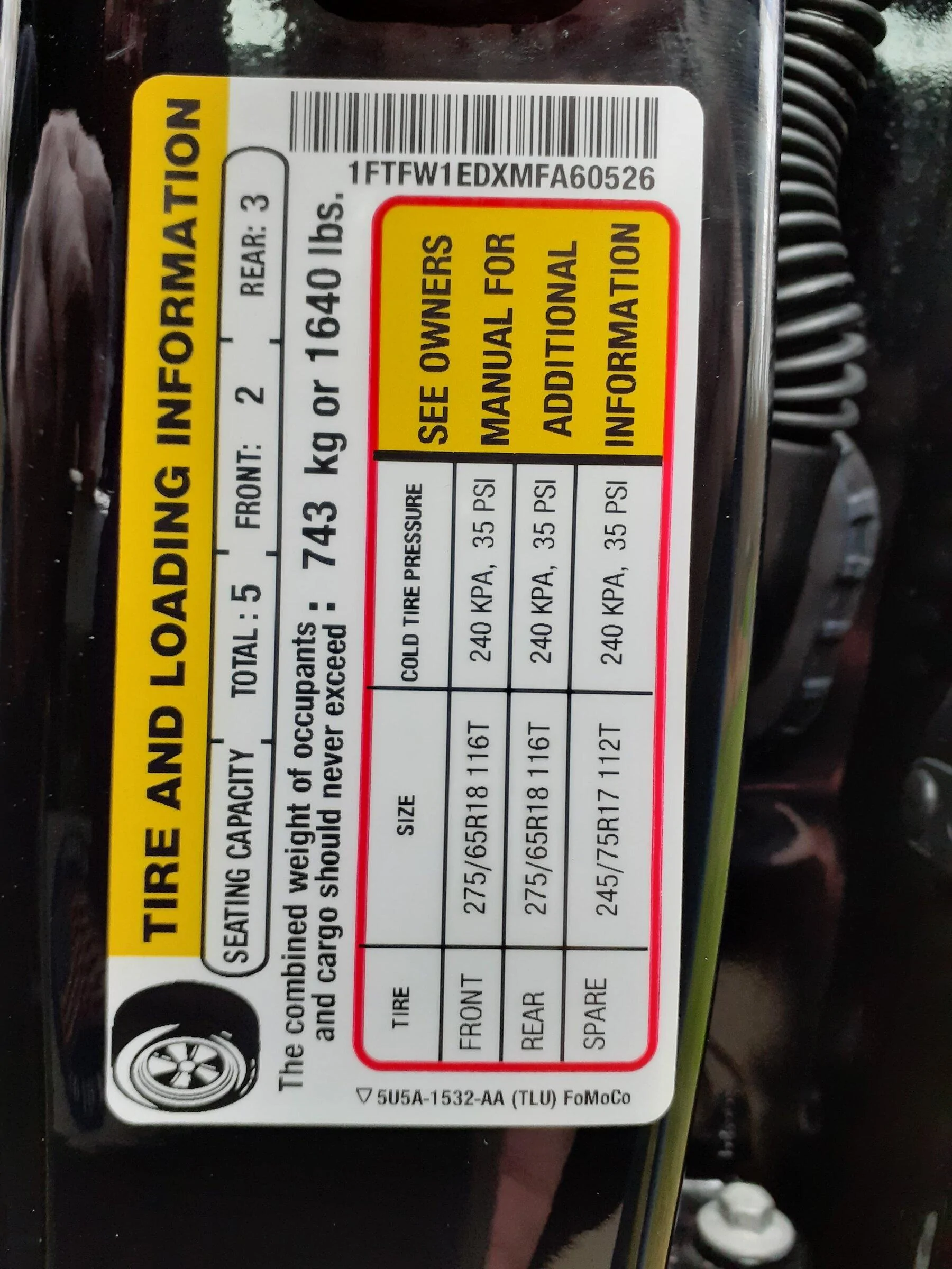

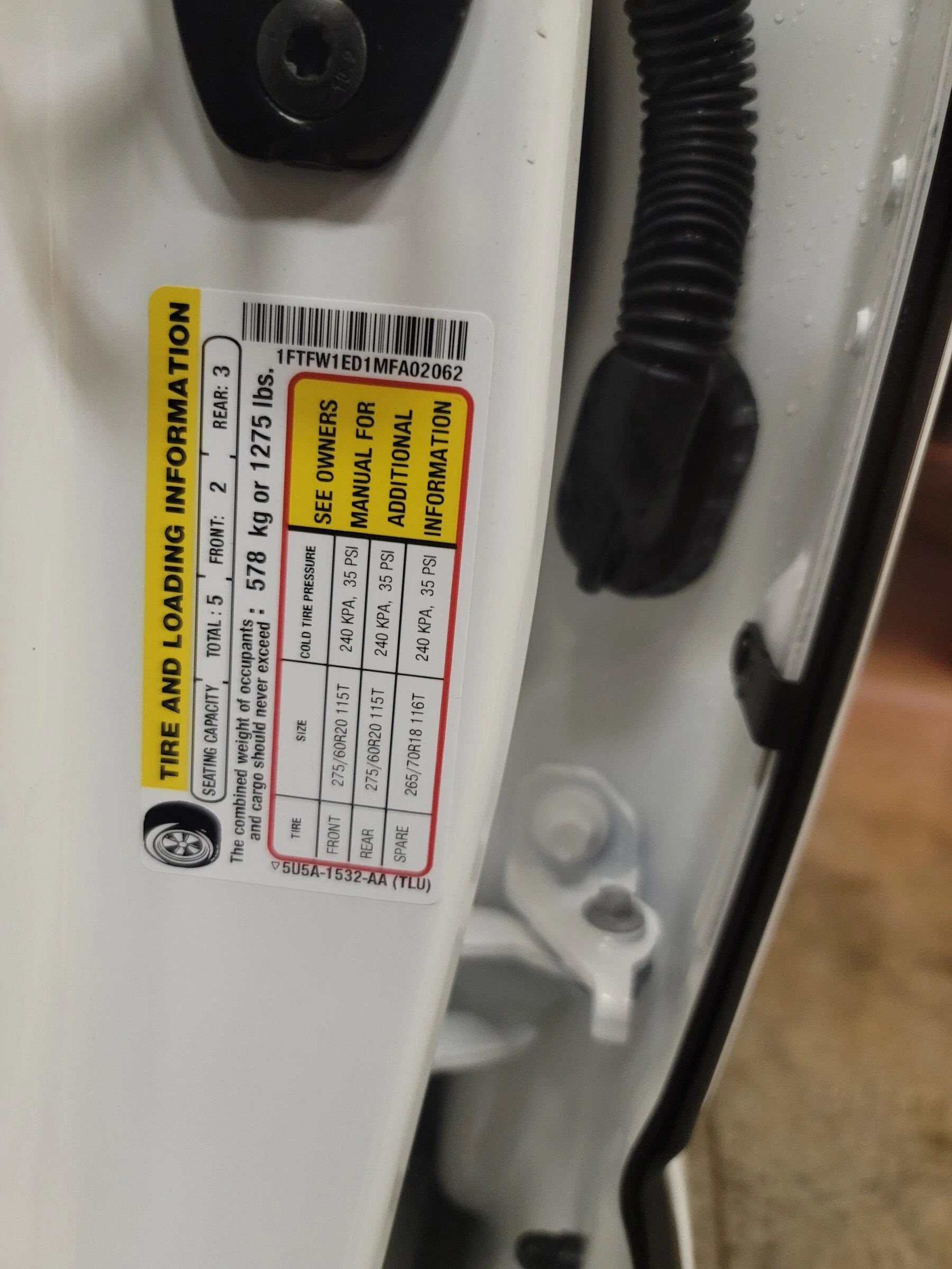

This is so weird. Nearly all of the payloads I‘ve seen in the posts are higher than mine for similar trucks. Can’t see the seats adding that much additional weight and the pano roof only adds are 65 lbs.
And this is before the spray in bed liner and hard quad fold Ford tonneau cover and other smaller items such as full weathertech floor mats , ww liners , mud flaps and hood protector. Not only that, its only a 2.4 generator as well. So before adding payload, I’m down around 1200. The door yellow sticker confirms the payload at 1320.
Those weights are in Canadian Lbs!! that's the difference ;)
