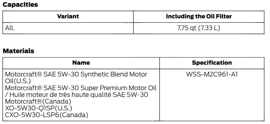

id move up to 5-30 tho.

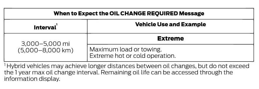

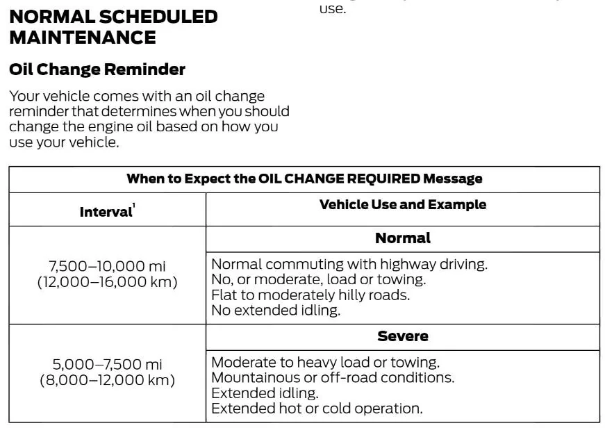

For your 2021 F150 V8, the correct oil weight is 5W30. I wouldn't leave 5W20 in there very long...

I did first at 3,000 ish. Next is at 10,00. full synthetic

I just follow the manual and will run full synthetic.

What possible reason would you run an oil weight not meeting Mfg spec? 5-30 will give a 20Wt when needed, it won't give 30wt protection if needed.

I'll change mine at 1500 miles and then at 5000 miles or one year which ever comes first, with Mobil 1 full synthetic. This has always worked well for me in the past.
