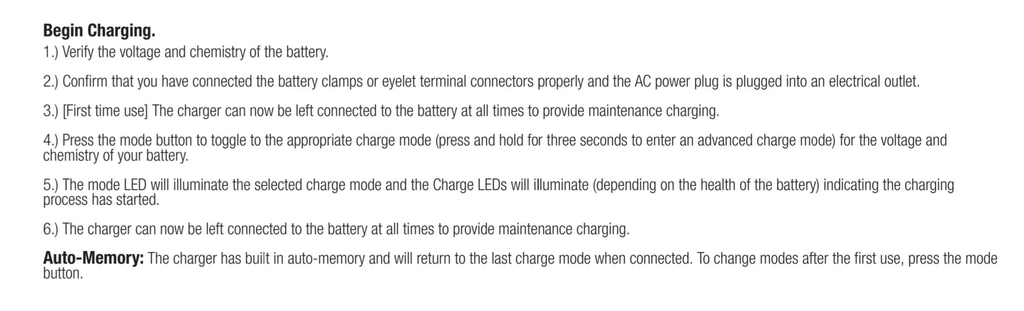

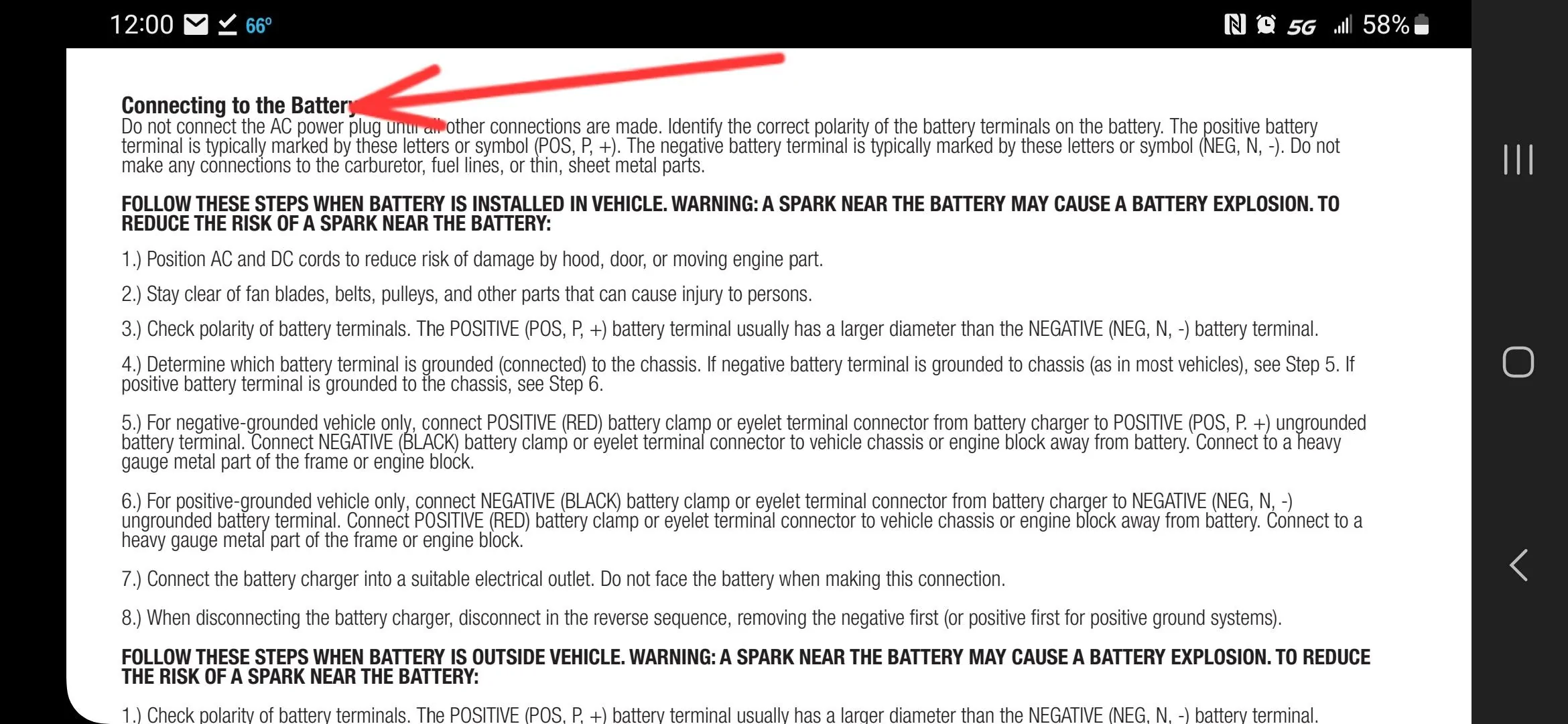

I connected this to the truck last night and it started blinking the first light. This morning after nearly 12hrs it is still blinking the first light. Is this charger not strong enough or there are other issues at play?

Have you tried getting that black negative clamp onto the negative battery terminal itself?
I think he actually has it connected properly for the BMS to account for the charging current going to the battery.
And there isn't a "strength" requirement for the charger. Many of us use the same charger to charge our AGM.
Do you have it set for AGM?
Edit: I see that you do.

Yeah not saying it’s wrong. Just trying to troubleshoot the issue. My thought was to 100% guarantee it’s getting juice to the battery by connecting directly to the battery post. Just removing a touch point for the charger I guess.

You could also enable Force Mode by holding Mode button for 5 sec. Supposedly that will allow charger to start charging a heavily depleted battery.

I think the power to the charger was on when I made the connection. I will retry correctly this evening. Thank you!
Will try that this evening. Thanks!
Will try that if everything else fails. Truck is working fine. I have just been driving very short distances for the past month and I thought it doesn’t hurt to charge it. It is also getting cold in my area.
That was probably the issue.
They are smart little devices and have a lot of failsafes built in.
Good luck
