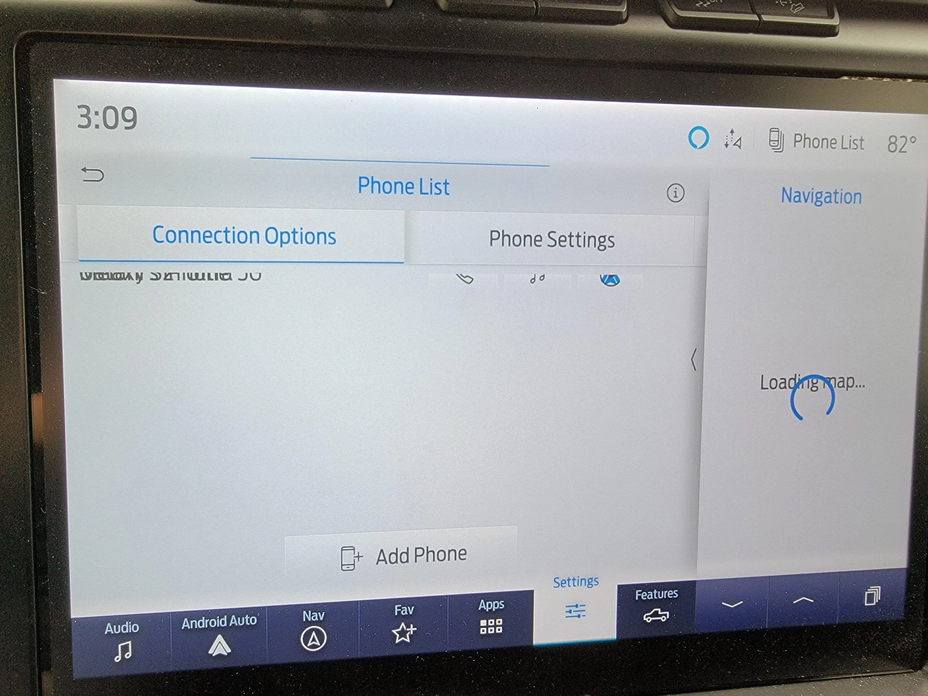

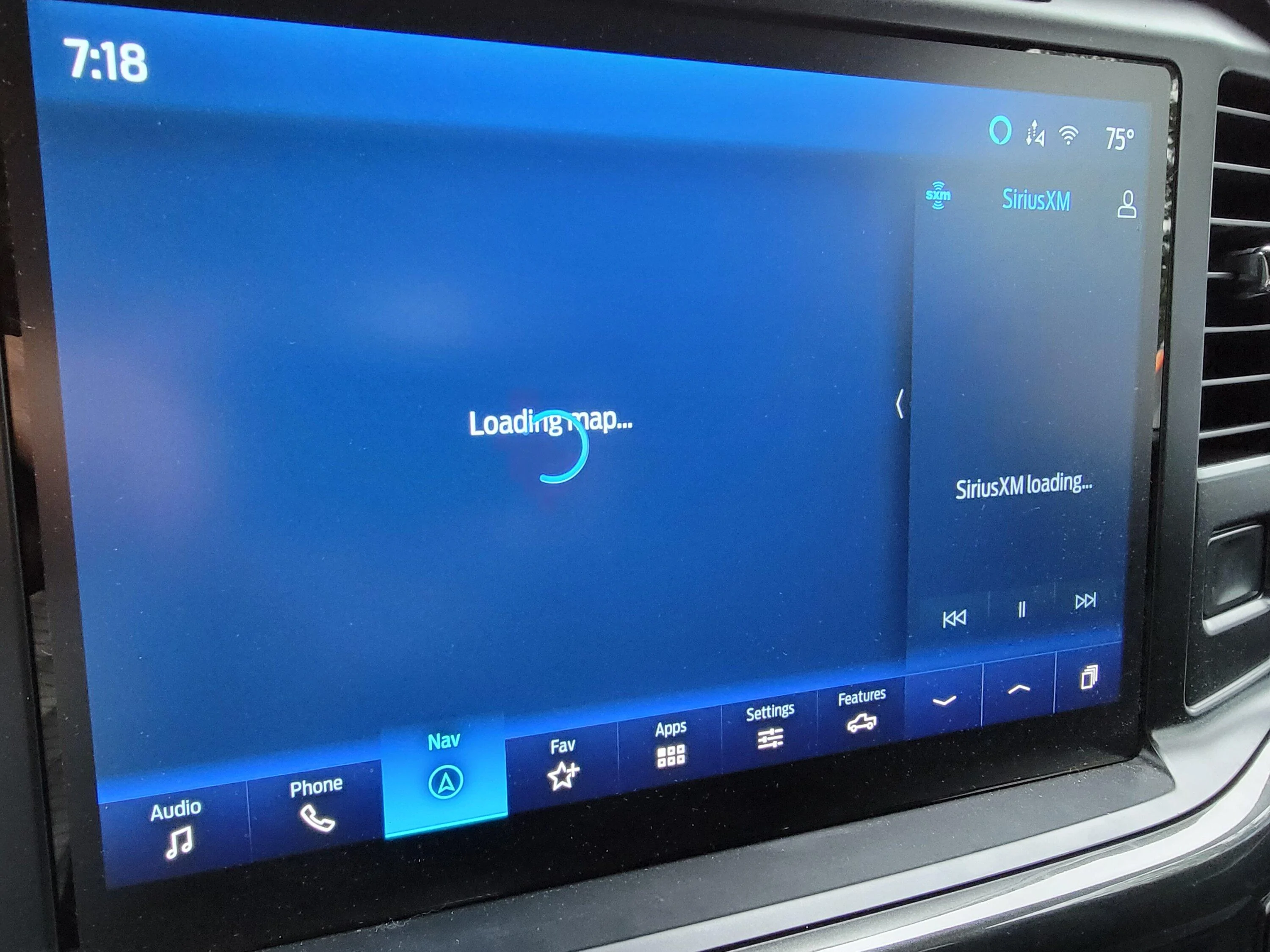

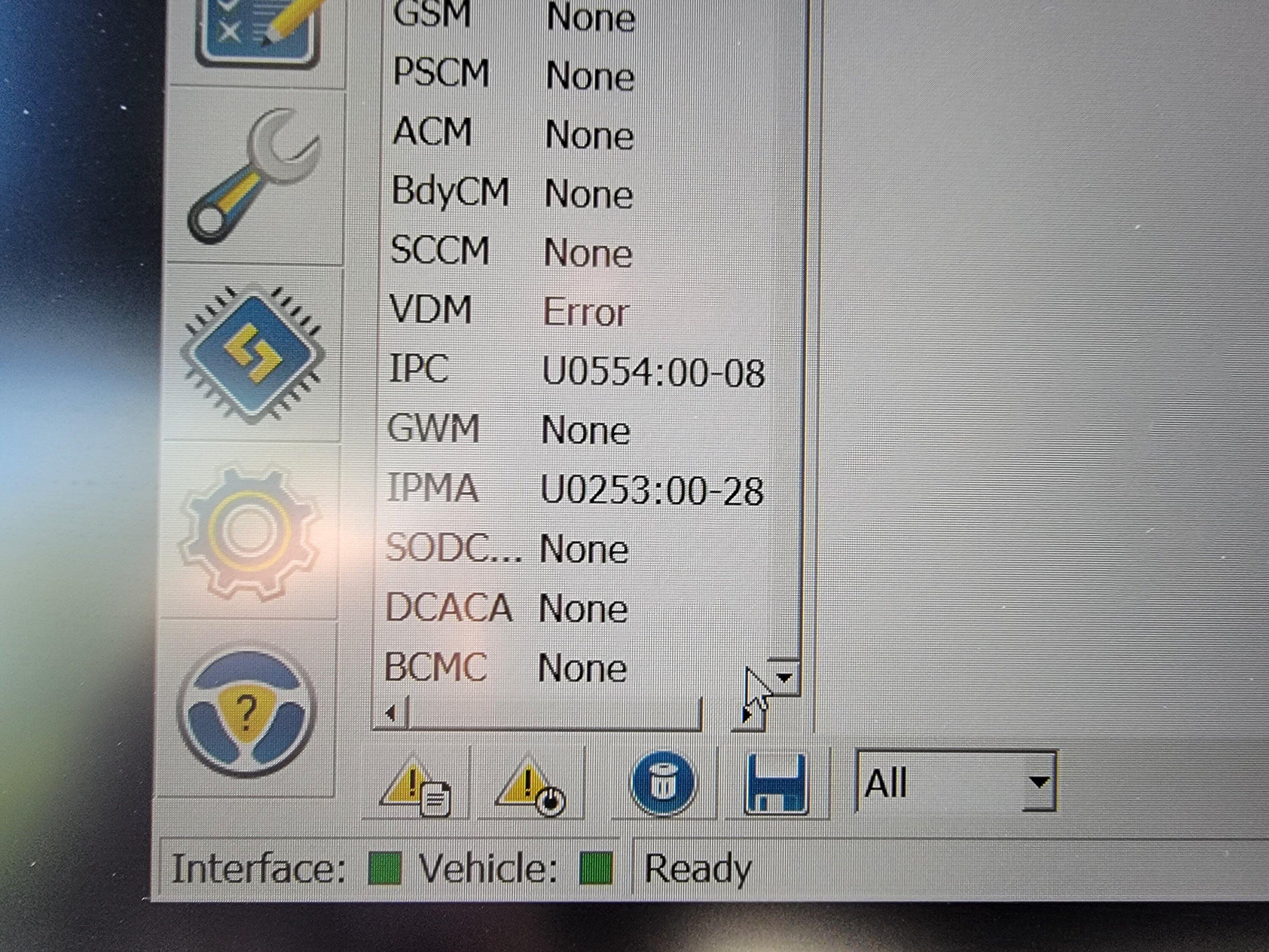

adding a couple pics showing what mine was doing. they ended up replacing apim.
Interesting. Mine was different.. The map would load (said I was in Dearborn), but it would have "GPS" with a line through it. Also I couldn't connect Android Auto because it couldn't locate me by GPS. I didn't try Sirius, because the truck has been at ford through most of my trial and it expired last month.
Mine was the exact same as yours. Crazy that dealers are having trucks sit for weeks and replacing stuff because of this issue.
