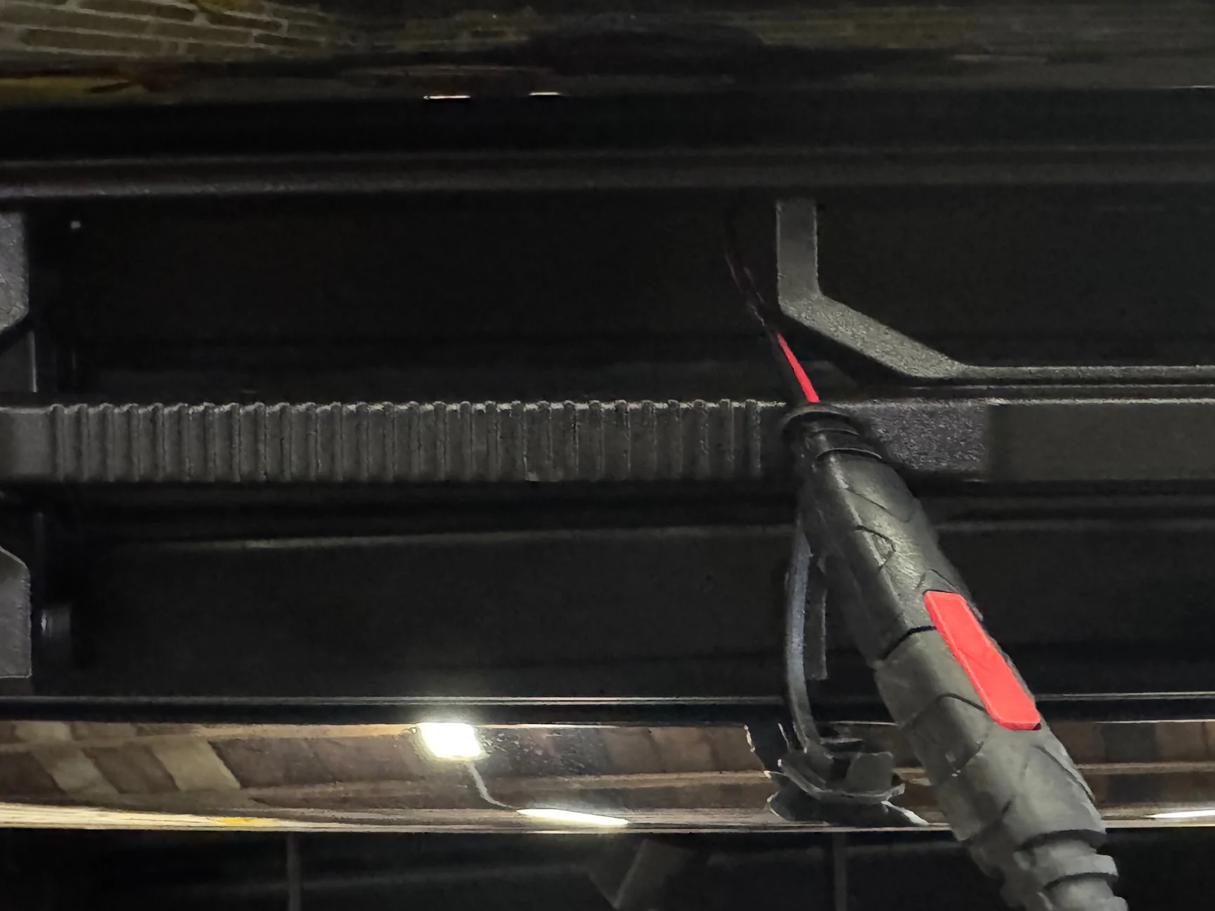

thank you, if possible can you share pictures of how you run the cable through the grill to battery? thank you

@stlgrym3 there's several openings at the top just behind the grill that are plenty large enough for an extension cord to snake through. You can also get the hard-wired connection for a battery that has the Noco quick disconnect on the other end. Makes it easy to pop the hood connect the pigtail to the Noco and snake an extension cord down. Takes 1-2 minutes.
I do the same. It has a disconnect. You can get a 10 foot extension... this is the Genius 5. I got 3 inside my garages.

I chose the external. I have a 1a as well as a 10a NOCO. I have three other brands of battery maintainers. I keep vehicles and 4 wheeler on chargers in the winter.
Anyrate, I used a 3’ extension to route a cable lead from the battery to just behind the grille. I can connect the charger and also touch it behind the grill when not in use. It’s not long enough to get bounding the shutters.
It works well for me, it’s been there since last fall
