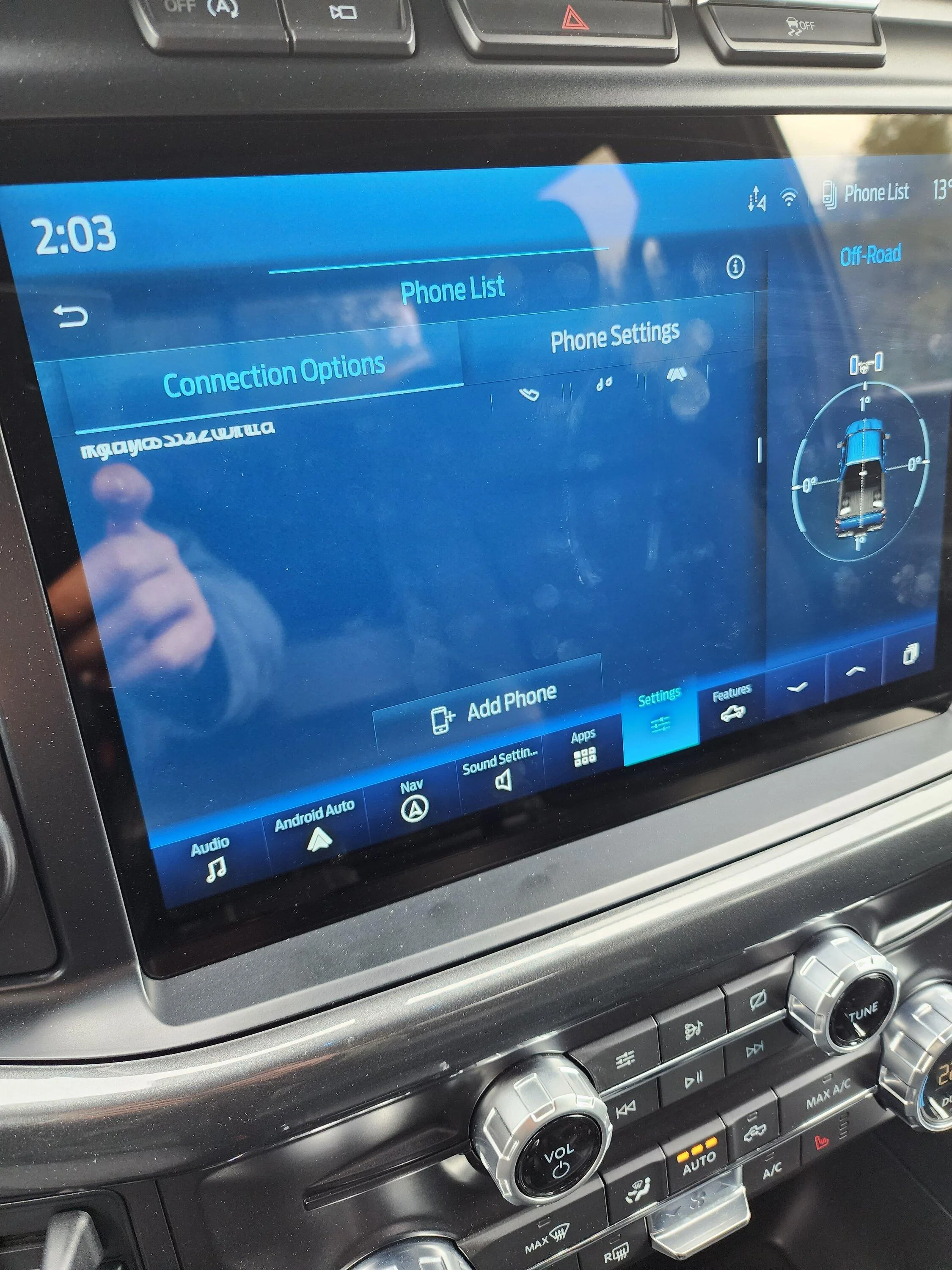

I received 4.2.3 yesterday now my navigation fails to ever load it just says Maps loading. I seem to have GPS, I have the arrow icon and the up and down icon in the top right corner, I can also locate my truck in Fordpass. I tried a soft reset and master reset to no avail. Also my phone list is unreadable. Has anyone seen this issue before .

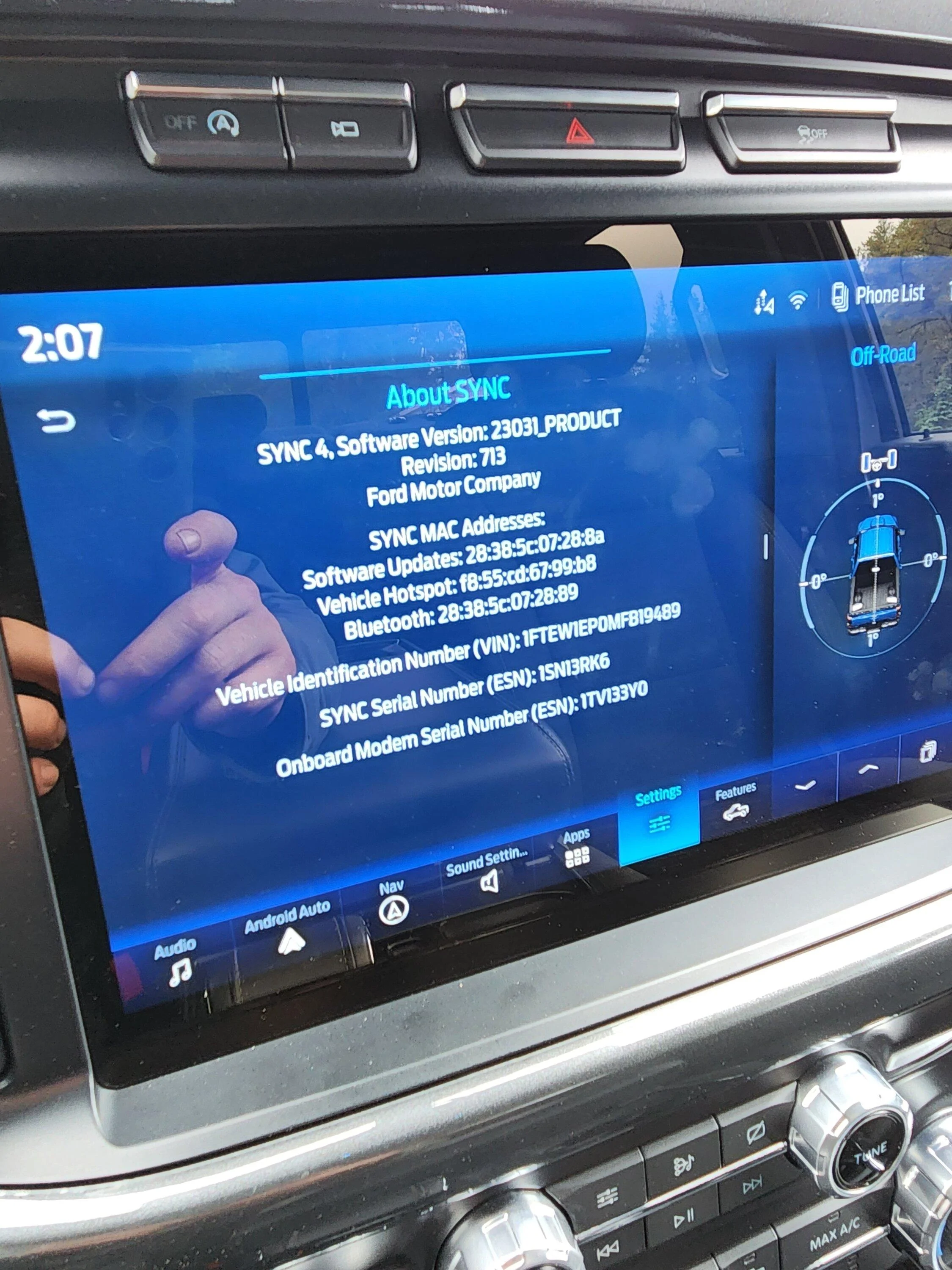

Yes just recieved 4.2.4, this morning. Didn't fix anything. Tried reset, pulling Apim fuse. Even disconnecting battery. Everything else works but I paid for the navigation. Tried cycling connected services. I paid subscription so it sucks it doesn't work. I use AA anyway but still.
