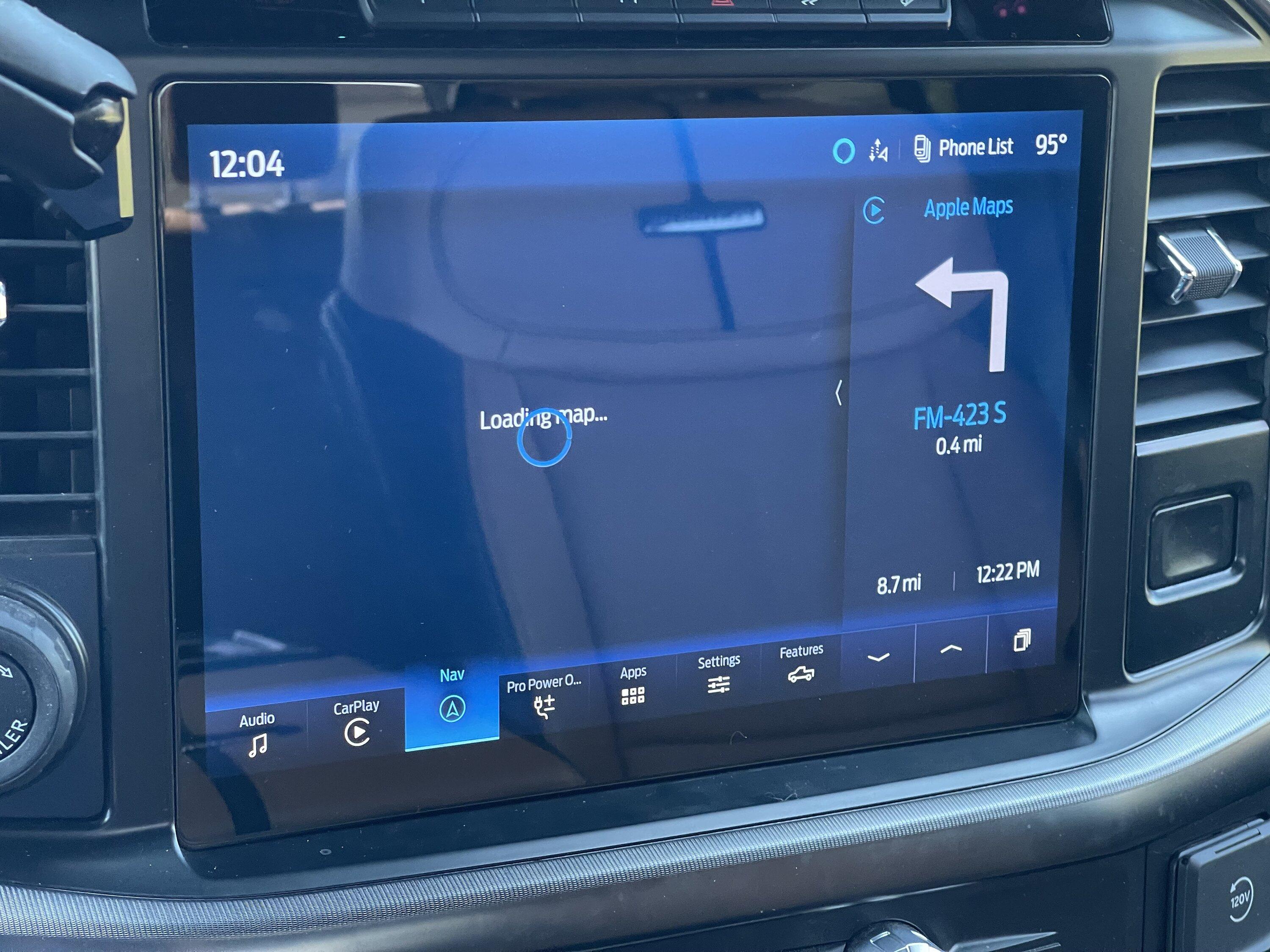

Not sure if it's related but I noticed the problem the day after accepting the latest non-update. (My most recent actual update was 4.2.1 done May 25th.)
Navigation is stuck "loading map". CarPlay will not display in the main screen but does show on the side bar of the screen. The side bar can no longer be moved from side to side and SiriusXM is stuck loading. I never use Nav so I don't really care if it doesn't work but the CarPlay thing is killing me!
CarPlay actually loaded yesterday but stopped when i touched Nav to see if that was back working. When I restart the truck I see CarPlay load for a second then it's gone.
I've tried pulling the APIM fuse for 15 minutes with no luck. (it didn't even erase my radio presets) Tried doing the Sync system reboot. No luck.
Is there somewhere in Forscan I can look to see if some setting is wrong?
Any help would be greatly appreciated!
