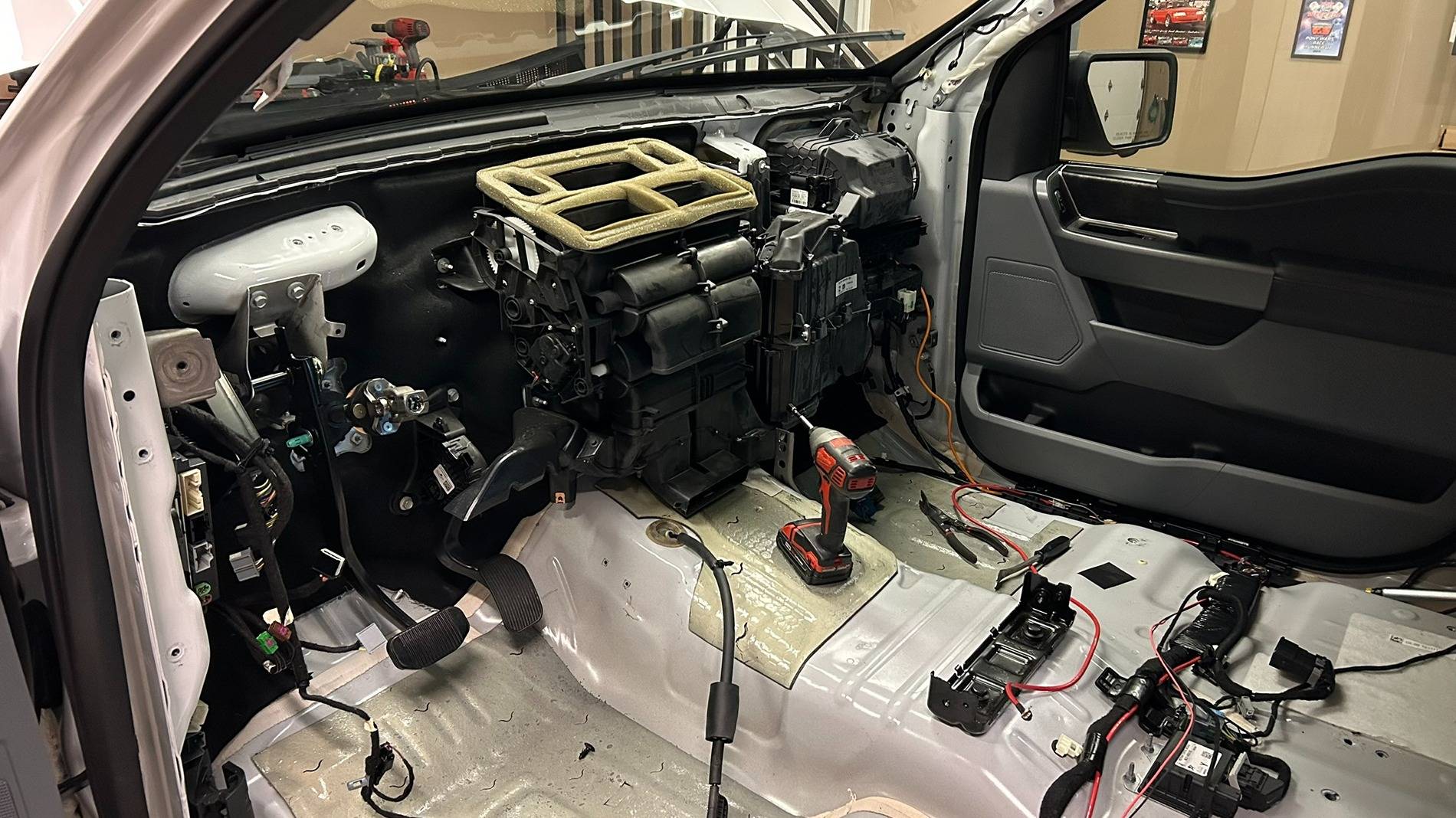

When I first bought this truck I had a specific list of options I wanted the truck to have. 1 was Push To Start, and the other was Passive Entry. Both of which I missed dearly. (I know, first world problems :facepalm:)
Since I bought the passive entry style door handles early on when I was paint matching the truck, I already had those installed and ready to go. I started this process out thinking I'd just add a few wires to the existing harness and be done with it. But once I started looking at how many wires were needed, on top of the fact that I wasn't really happy with the fact that you can't back pin the BCMC. I started to investigate replacing the entire harness instead, which meant replacing more than 1 harness. I began acquiring the correct OEM harnesses I would need, this included the door harnesses, the dash harness, the floor harness and finally the main engine bay harness. I bought all of the harnesses except the engine bay harness used. There are a couple recyclers on eBay that do a great job on removing harnesses from vehicles without cutting a single connector, they even remove the holding clips with the correct tools, which allows you to snap the harness back into place as designed. Which makes reassembly much easier. The harnesses aren't very expensive, in fact the main engine bay harness was less than what I paid for the aftermarket LED headlight harness.
By now I was pretty far down the rabbit hole, wondering what else I could add. Memory seats would be awesome since my wife and I share the truck. We have a Lariat 502A Crew Cab F150 that does the "work", like towing the toys and whatnot. But this truck is our "fun" vehicle...if I can ever get my Foxbody Coupe painted...that will be our "nice day only" vehicle. ? Anyways, back to the truck, so I figured, if I was going to add memory seats, why not add adjustable pedals and electric tilt/telescoping steering column as well?!?! Ambient lighting would be nice while I was at it...since I bought Lariat 502A harnesses, I had all the right plugs for whatever upgrade I could desire. I was just a matter of installing said option, and programming it via Forscan.
After 2 months of acquiring the necessary components, it was time to begin. And now seemed like as good of time as any to tear a perfectly fine truck apart to upgrade it!

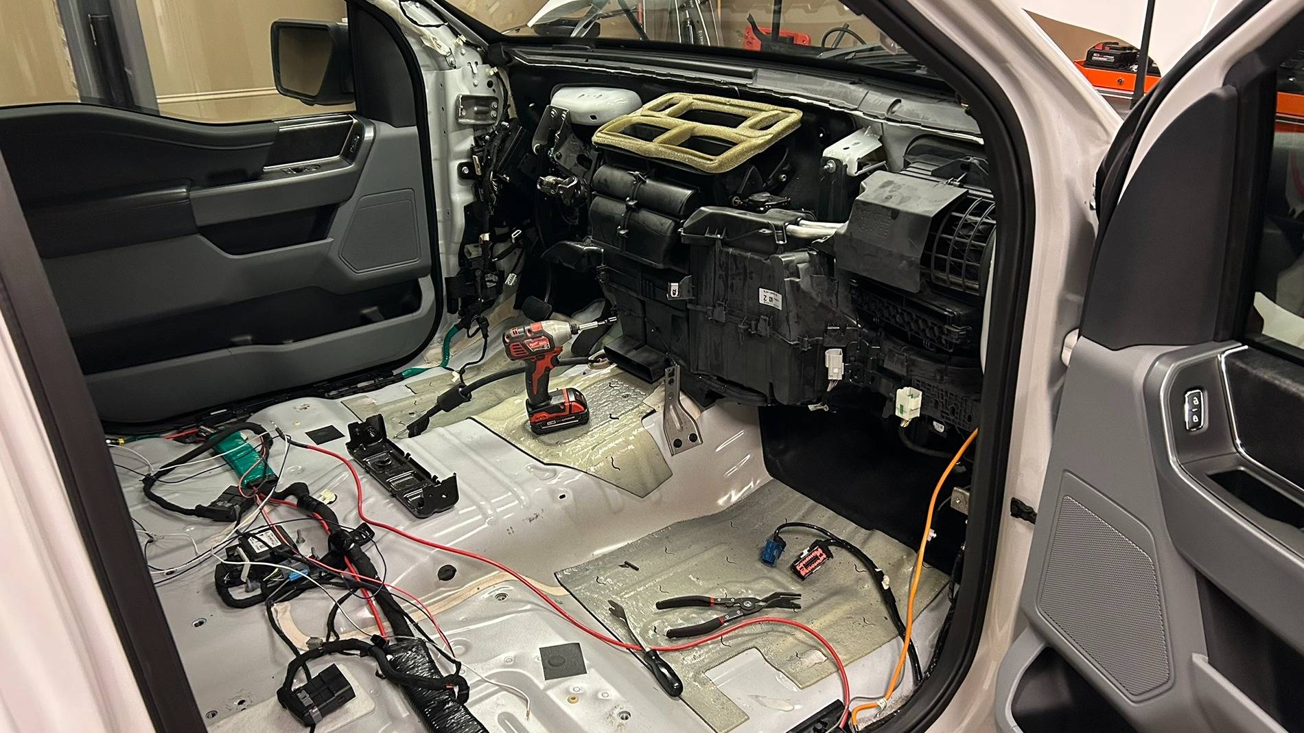

The dash and door harnesses aren't difficult, getting everything out to replace the dash harness is the tedious part. It's not hard work perse, the dash comes out fairly easy in these trucks...there's just a lot of crap that has to come out first before the dash can come out. The engine bay harness wasn't as bad as I thought it was going to be. I was able to snake the harness from the drivers side to the passenger side wheel well, where I was able to remove it from the truck. Installation of the new engine harness was reverse of removal...with the wife's help, we were able to snake it back through and plug everything back in. The engine bay harness has several large connectors on it that make it a tad more difficult to install. Not terrible...but you do need to plan your route.
The floor harness was the "fun" one...since Ford never made a regular cab truck with all the options I was wanting to install, the only solution was to shrink a crew cab floor harness. I was able to layout the regular cab harness along with the crew cab harness and begin working on removing wires that are no longer needed.

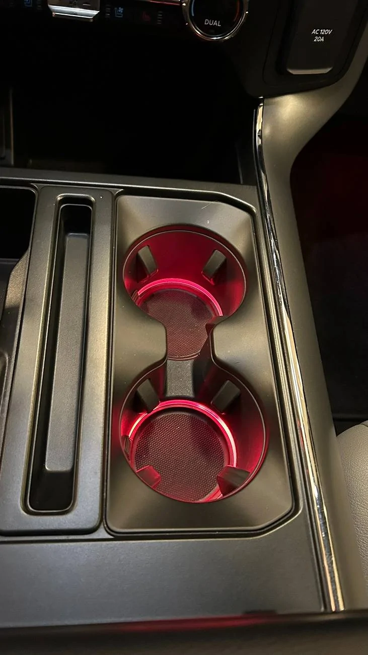

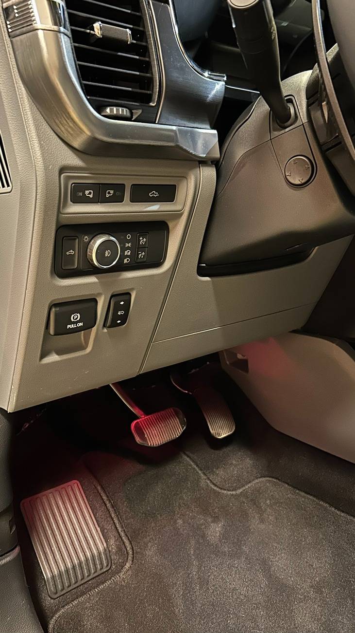

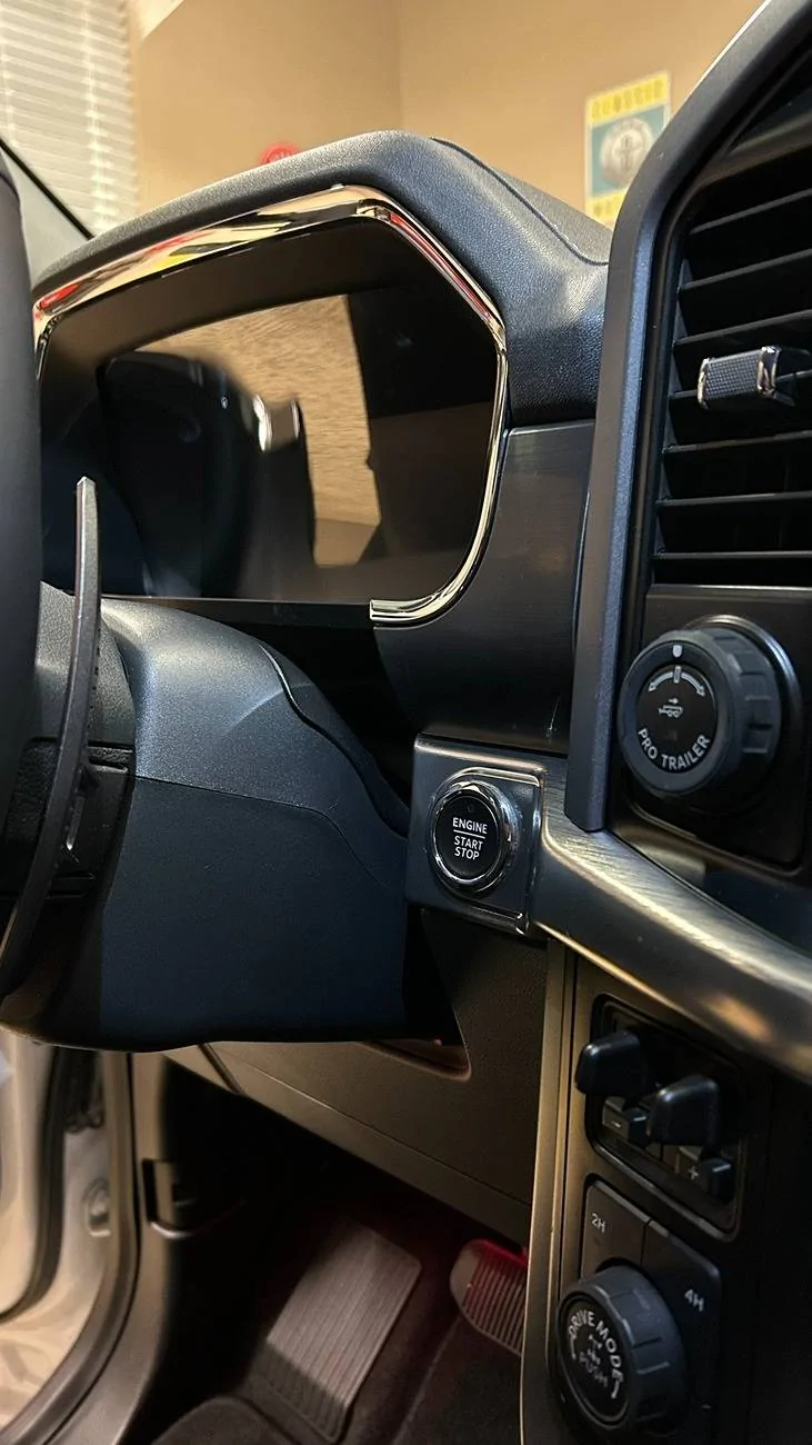

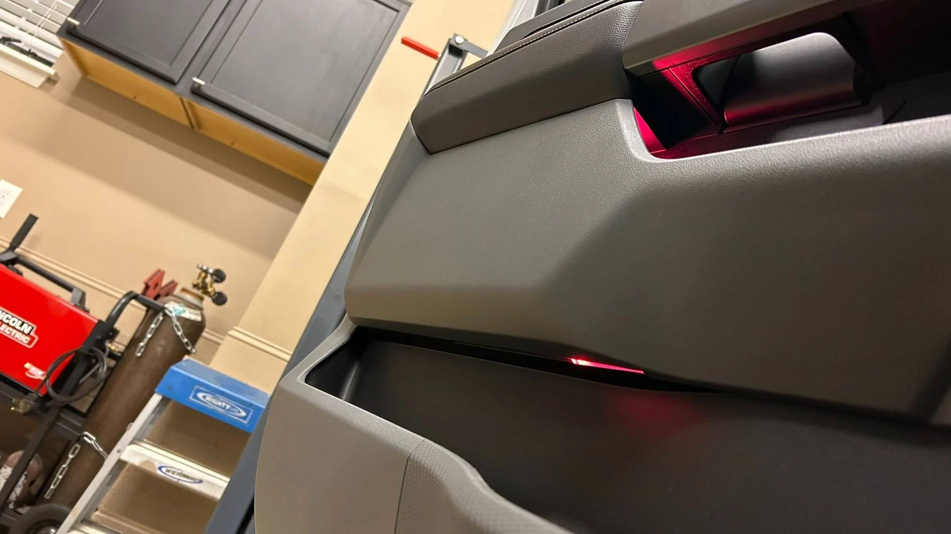

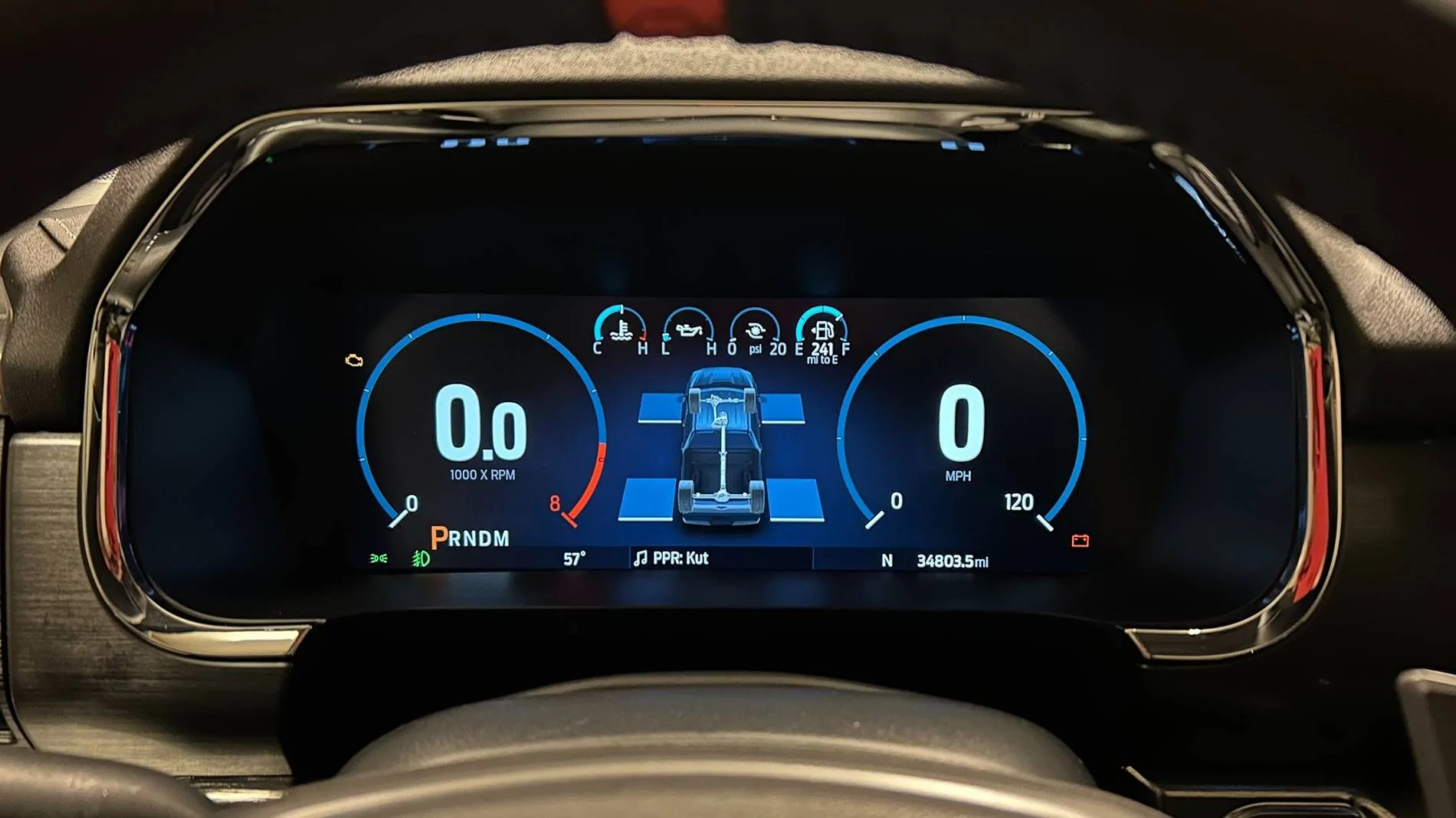

After working on it for the last 3 weekends, I am happy to report that she is back on the road sporting her new upgrades! She now has passive entry, PTS, multi color ambient lighting, B&O DTS sound system, 12" cluster upgrade, memory adjustable pedals, and memory tilt/telescoping steering. Programming was no joke...I spent a few hours on the laptop in the truck getting everything to cooperate. Everything works, I don't have any DTC's and I couldn't be happier!

Memory seats are pretty easy but do require a DSM native driver's seat. Swapping out the whole driver's door harness does do this, but also adding in the 2 wires to the lock harness while moving from 4 pin to 6 pin connector also do it (the avenue I used). I didn't move to memory pedals as me factory pedals stay against the firewall. Love to see the effort put into adapting harnesses, not an easy thing to do tearing into factory harnesses removing the tape / etc.
If you upgrade the mirrors to folding, the 'seat' memory works on their position as well. Not sure if you replaced the harness that connects to the rear view mirror, but the mirror dimming will also work if the harness to the door is populated to the rearview mirror.

I ordered the harness based off the VIN number from the donor vehicle. I'd then use the VIN number to decipher what options the truck came with. Usually, I could get what I needed based off auction pictures from the sale of the wrecked truck. Below is what I used on my truck, I'm sure there are other harnesses out there that would work. It just all depends on what options you want to add. I don't have the door harness part numbers, I bought those for a 502A Lariat.
Dash Harness: ML3T-14401-DAD
Center Console Harness: ML3T-14B079-MD
Floor Harness: ML3T-14A005-LDG
Under Hood Harness: ML3Z-12A581-CBA
Keep in mind, the dash, floor, and door harnesses are not engine specific. But the under-hood harness is. The part number above for the under-hood harness is for a 2021 F150 with the 5.0 engine.
For Push To Start, you will also need the appropriate BCM, the PTS BCM is different from the key-in ignition style BCM. You will also need the external antenna's. There are 3 total, but you only need 2 in order to make the PTS to work. The 1 antenna is under the center console cupholder, the 2nd antenna is mounted on the cab back wall, and the 3rd antenna is built in with the tailgate release handle assembly. I currently do not have the tailgate antenna since I have not upgraded to the electronic release tailgate operation yet. Your best best is to find a used BCM and buy the key that went with that particular BCM. Most recyclers will sell you the key that came with the truck. This will make programming much easier...if not, you will have to jump through many hoops in order to get FDRS to PMI a new BCM that never came in your truck. You will need 2 keys at minimum in order to program the PATS system once you are done. And of course you will need the PTS button and the trim that it mounts in. The trim piece that goes across the middle of the dash is different from the key-in ignition style trim piece.
Passive entry will of course need the correct door handles, once you have added the wiring via whichever method you choose, it just requires some minor programming to enable. Hope that helps!
