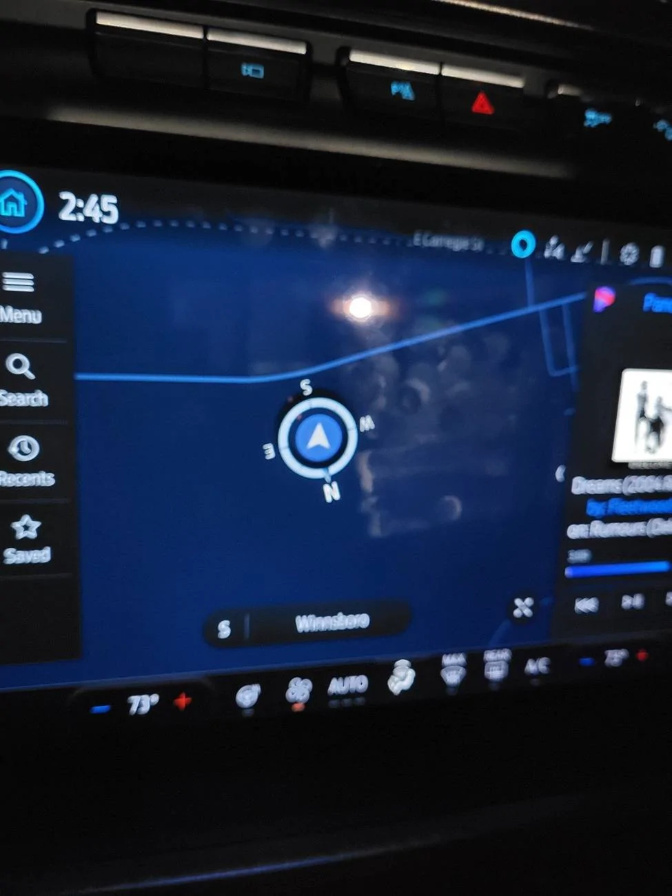

Two, can you get a pic of what the climate bar looks like on the Synch screen after you made the changes? Wondering if it’s something I would want to add.
Ford F-150 My FORScan mods on 2025 KR 20230212_024524
Ford F-150 My FORScan mods on 2025 KR 20250308_154224

I know on my '23 to get the climate bar you had to enable unreal theme.

A couple questions, one, which engine do you have(for the fake engine noise)
I have the powerboost.
powerboatr provided a photo above. For earlier model years you also have to enable the unreal engine, but it's enabled by default for 2025.

I will have to give that a shot. So as far as the “fake engine noise”, is that more than the backing noise? I’ve heard some sound when in all electric, wasn’t sure how much of that was artificial.
There is both the backup beep, and the UFO sound when going under 20mph. The item referenced is just for the 20mph UFO sound I believe.

My 24 super duty I picked up in Jan
Unreal was already enabled
But climate stuff was not on lower screen, it is now
Plus the honk on exit was a toggle in settings
And running boards have an extended timer to stay out for 5 minutes if truck is off...but not locked
