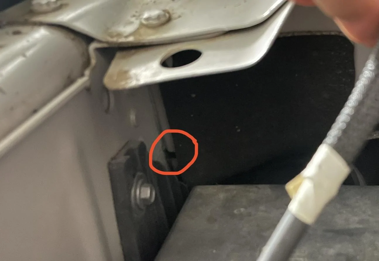

Check the under hood on the passenger side cowl drain point, see photo. It will clog and water will leak into the cabin air filter area.
Ford F-150 Musty Smell Coming from Air Vents IMG_3736
Can you zoom out to better understand what I am looking at/for?
