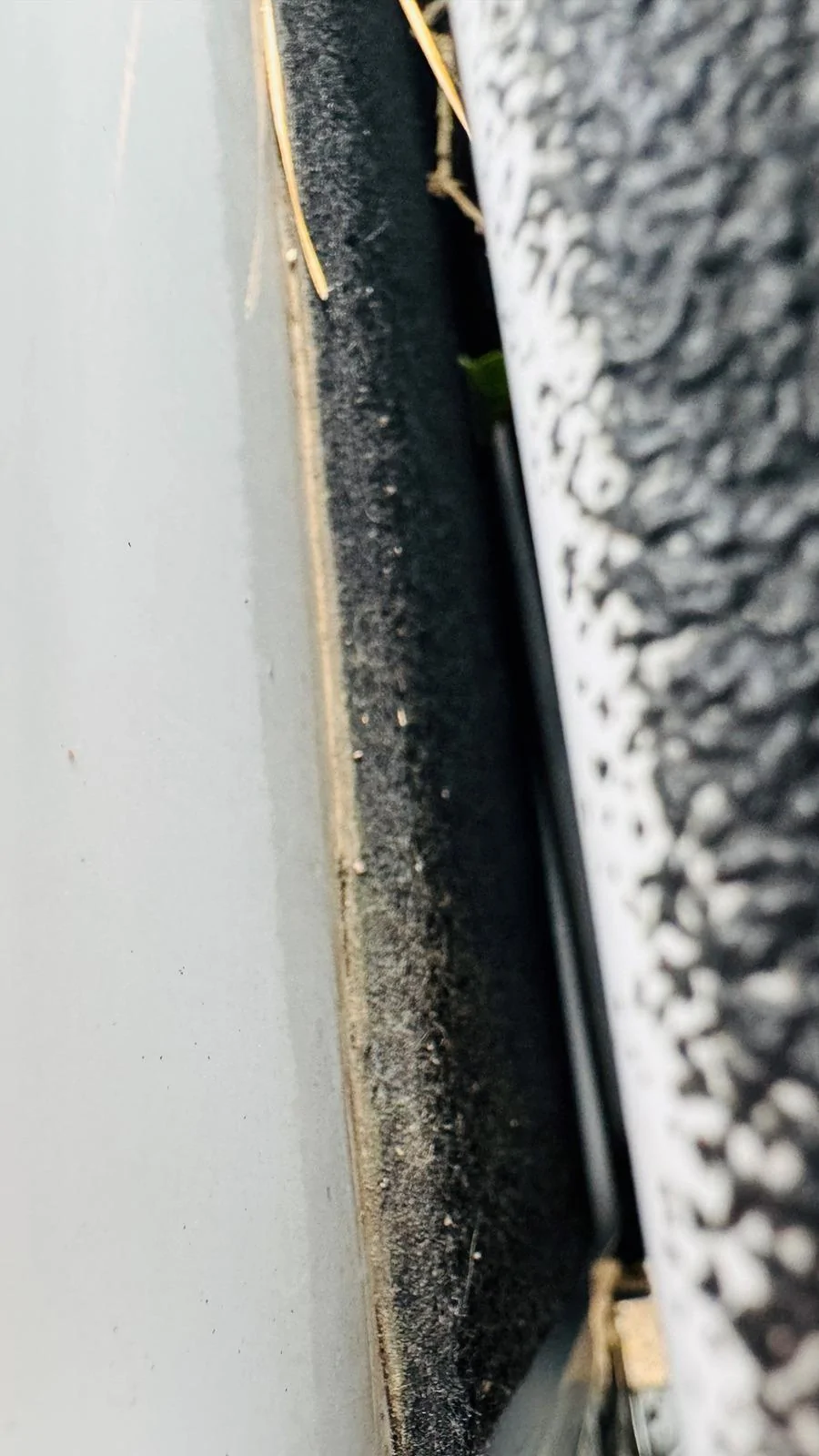

The issue is that I don't believe there's enough room to get the vent out. The bed has to be removed. I tried to push mine through and it just hits the bed. When I was working on a box I'm pretty sure I tried to remove it to see if I could just seal it up but it goes back a little bit and then stops.
Why did you have to say that.... :crying:
Maybe I can find a material that will allow air to pass but is hydrophobic. I can design and 3d print a frame to what will click to the vent so the water won't be able to come in contact with the panel.
