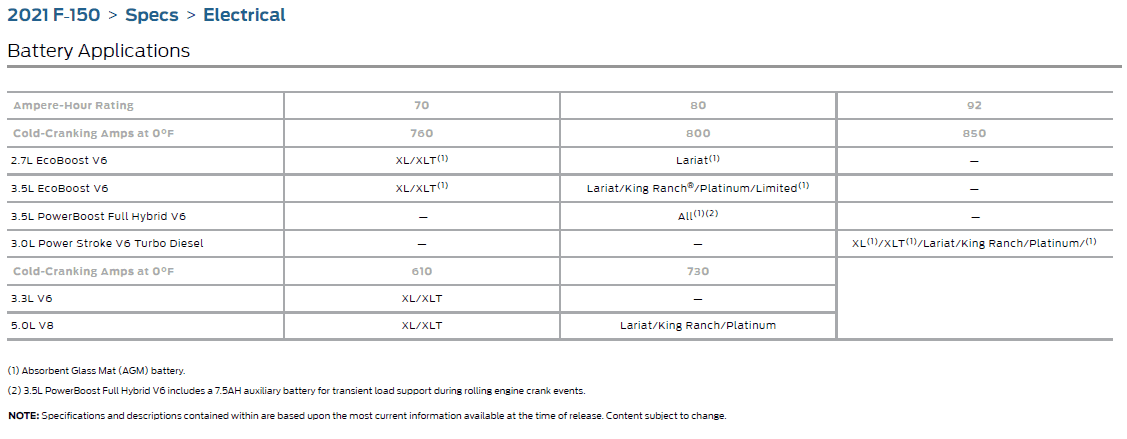

A H6 battery is a bit undersized for a Platinum trim F150. Ford didn't stick to their initial plan due to supply chain shortages, but their early 2021 documentation indicated that a Platinum trim should have a H7 94R AGM battery at minimum. The H6 batteries were only supposed to be used in XL and XLT trims without the diesel engine.

Traded my '19 platinum for a 2024 King Ranch
retired
I had to replace the battery in my 2019 platinum last year because even though the original was testing positive, it would never charge to full capacity. I was getting error messages about low battery shut down and such, and a few times it wouldn't start. I replaced it with the BAGM94RH7800 800CCA battery that the Platinum called for. Have not had a problem since. If you look up the battery for your Platinum, I think you will see it also calls for this 800CCA battery. I forget what the reason was that the Platinum required the larger battery, but it had something to do with the extensive electronics on the Platinum. However, I was just checking the availability of this battery online, and it is showing as being on back order. So maybe that's why your dealer substituted a smaller battery. I would still ask them to put in the proper battery later, as the one they gave you is undersized.
You should be able to go to this website and put in your Vin# and it should give you the proper battery for your Platinum - https://parts.ford.com/shop/en/us/shop-parts

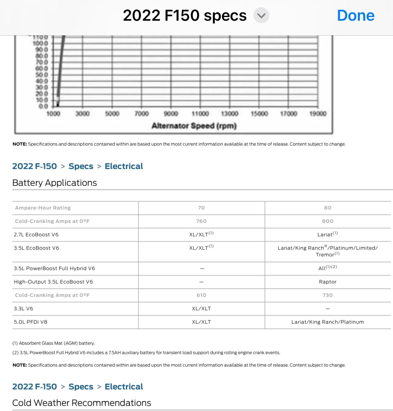

I showed the dealer the 2022 f150 build book. They replaced the original H6 with a new H7 on my 2022 platinum.
After that, all battery related issues have gone away.
