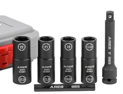

When I was a kid my dad used to take care of the vending machines at the McGard factory. I went with him on an over time service call and the foreman took us on a factory tour to show us how they were made, very cool, and high quality. To solve the swollen lug nut problem get a set of flip sockets that have half sizes. This is a good set that I've used for some time now...link below.
https://www.amazon.com/ARES-59065-S...5004&sprefix=FLIP+SPCKETS,aps,272&sr=8-9&th=1

I've just purchased the McGard 64073 nuts and they are very nice albeit expensive. I also carry a large breaker bar and my 1/2" torque wrench along with a non-marring 22 mm socket in my tool box in the back, I couldn't even imagine using a regular tire iron on these beasts. Ed, I bought a set of those flip sockets, really saved me on my 2013's swollen lugs before putting on Gorillas.
