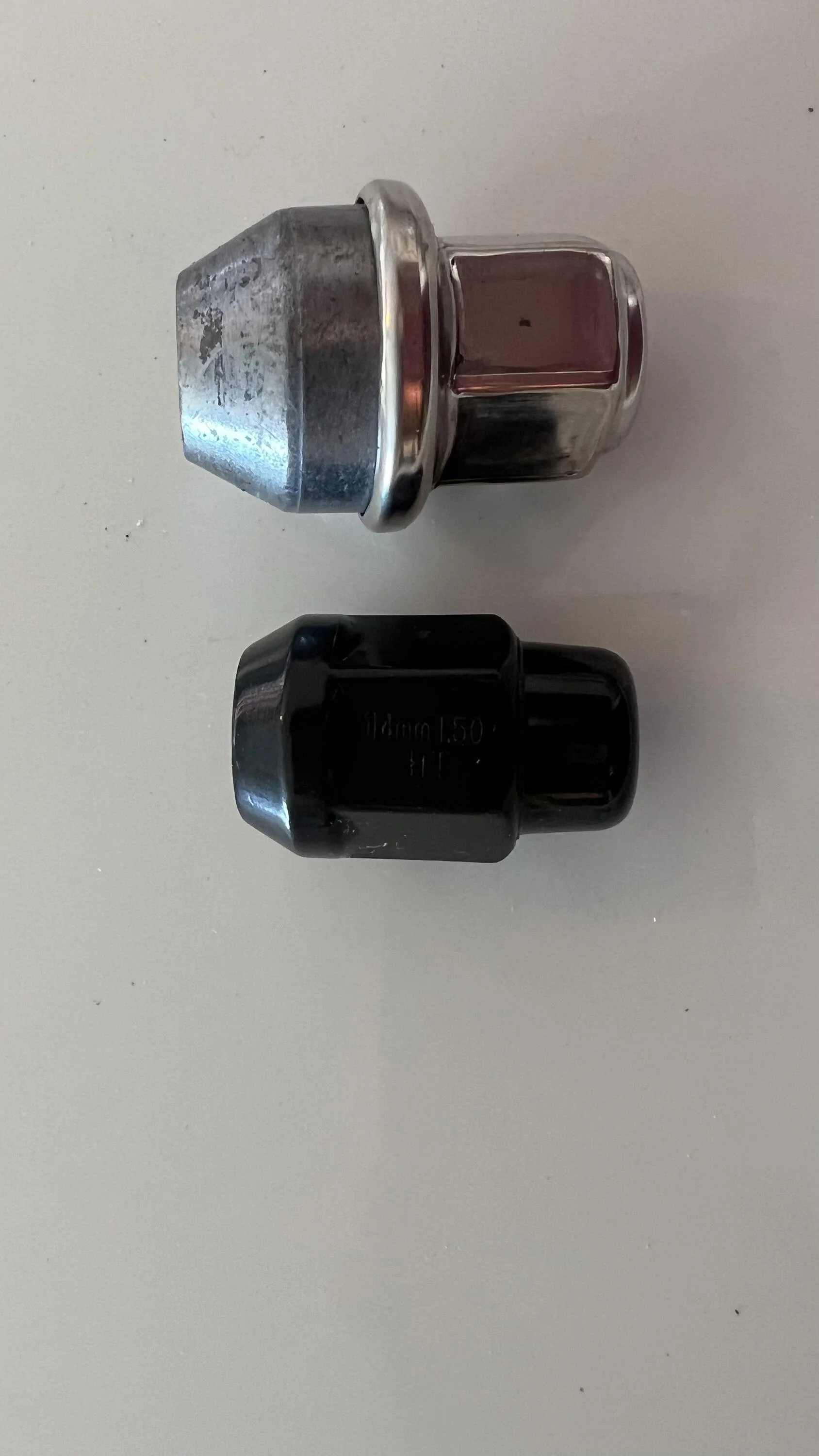

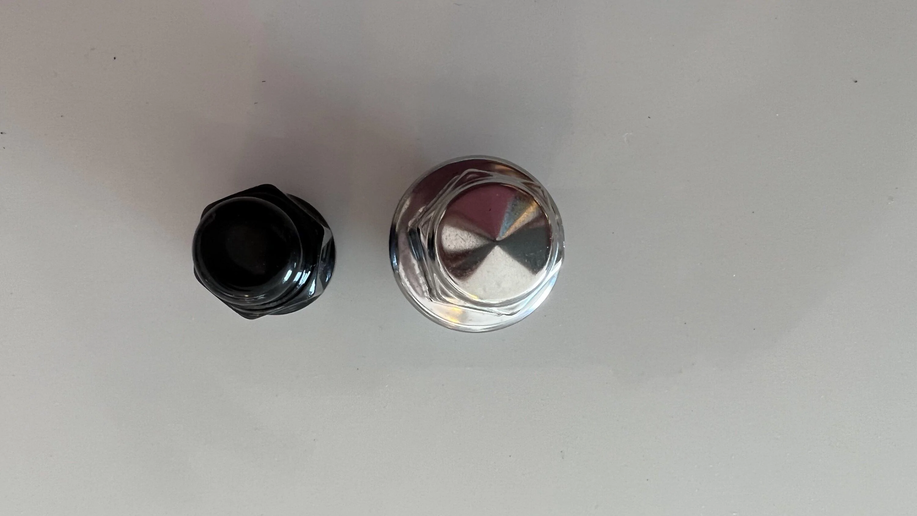

Brought these to swap out from the stock lug nuts.
https://www.ebay.ca/itm/274408612025
I’m a bit concerned that these are too small, specifically the camber insert. My son who is a mechanic has the same concerns.
They fit ok, but there is no way they are filling all of the camber hole.
Thinking I should have ordered the ‘large seat’ versions.
Thoughts?

I ran the 61148bcx gorilla nuts, I don’t think I would personally use these.

I got the same ones as @Doyouevenboost , they are a direct replacement, only black. The ones you got don't even look like they are for an F150, I wouldn't use them.

You want Gorilla 61148BCX/61147BCX LARGE SEAT OEM STYLE.
Maybe it's autocorrect getting you....but it "chamfer", not "camber".
