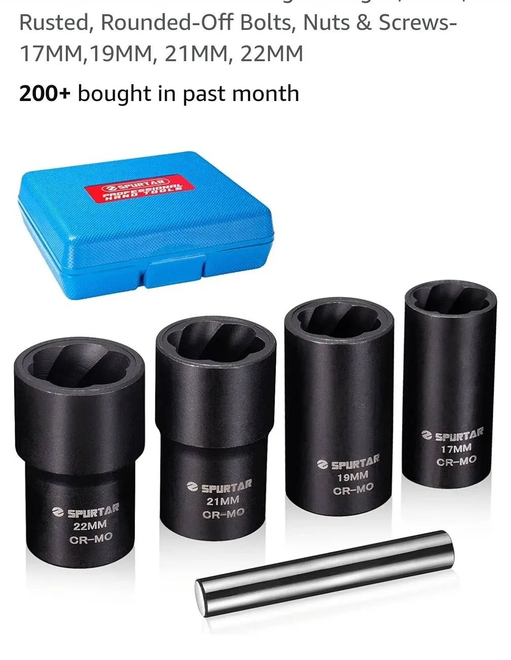

I really don’t think you can get a replacement lug key without that card. They are asking for. Most likely you’re gonna have to either get one of the tools for removing locking lugs, or sacrifice some cheap sockets and pound them over the lugs to remove your wheel locks

Second that thought.
Example of a Locking Lug Nut extractor kit:
