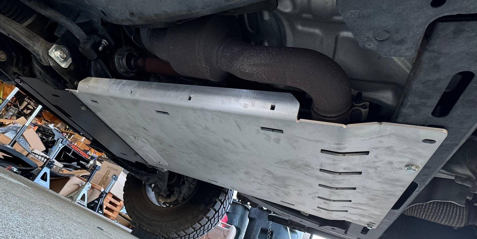

Bought the RCI front/engine/transmission skid plates in raw aluminum as well as the 2WD brackets from Space White. They aren't required, but for the 2WD guys it'll save you having to drill into the frame to add the holes that are there for the 4WD trucks. At least now I can remove those fiber board setups that are barely hanging on and hang too low.
The_Auto_Tech
Cody
Dec 16, 2023
40
529
242
Des Moines, IA
2022 XL 4x2 3.3
Got all of the skid plates installed this weekend. I ended up just drilling the additional holes in the front subframe to add the speed clips and also relocated the EPAS ground wires to the back side of the subframe instead of the bottom. Nothing too difficult, just takes a bit of time to get the holes big enough for the speed clips. Glad I went with the RCI setup, the are very nicely made with awesome hardware. It's so nice to have all those crappy fiber splash shields out of there that hung down so low, and also no protection for the front of the engine bay area.
