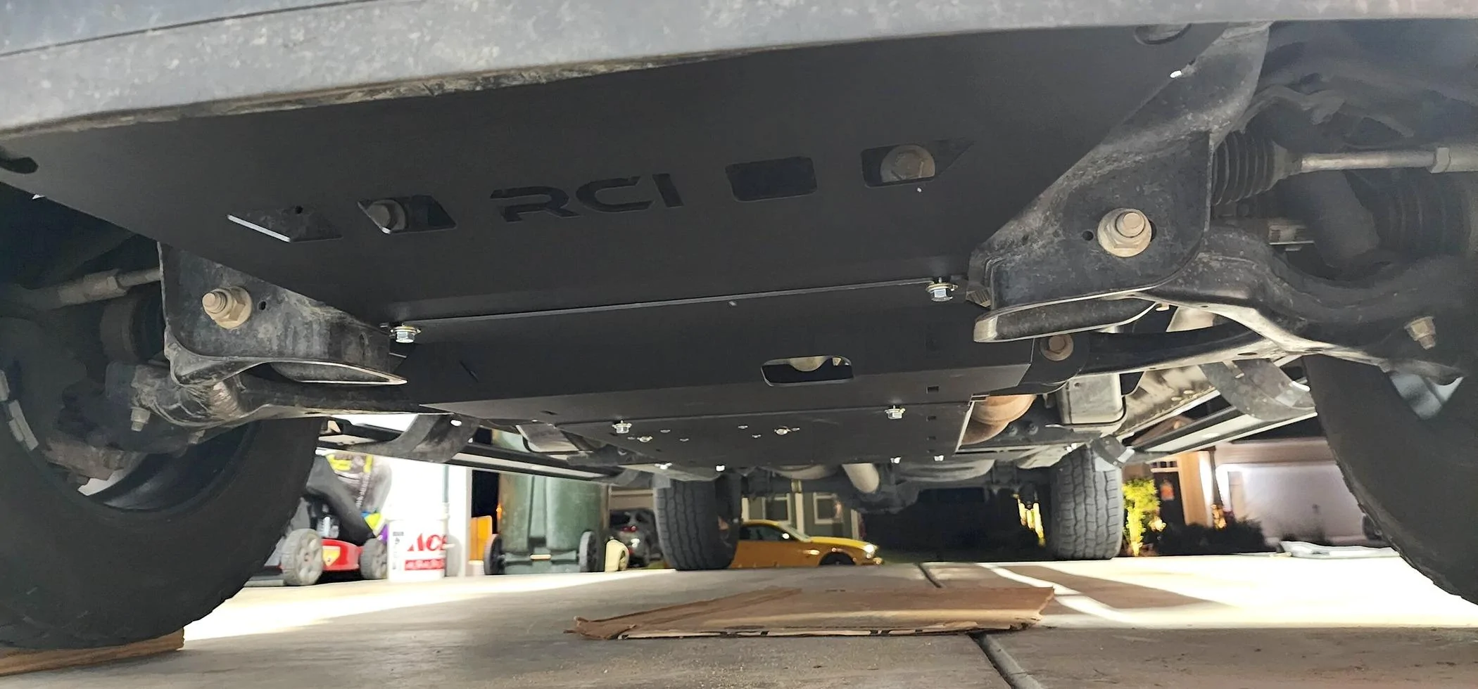

Hi Cody - I just contated RCI and they said they do not have a plate which covers the space left if the active air dam is removed. Their site shows the following:
The AAD is still there - it does not bolt directly under the front bumper - it seems to go "above" the AAD and covers some of the gap. My concern was stuff getting into the engine area when in deep snow. All good - will give it a shot when they arrive.
Thanks!
Well no, it doesn't attach to the front bumper, if you want that, buy the Tremor skid plate. It most definitely covers in between the front bumper and the front of the engine bay though.

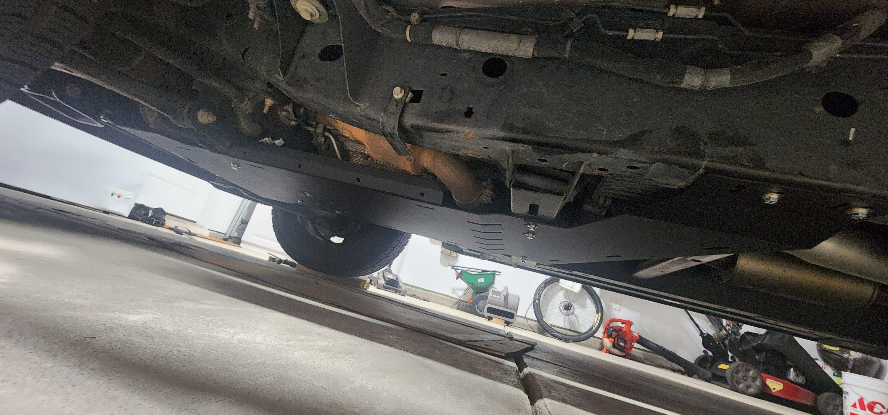

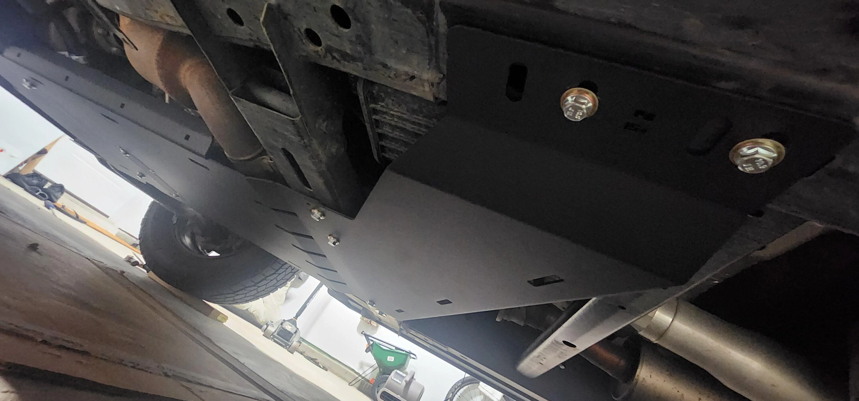

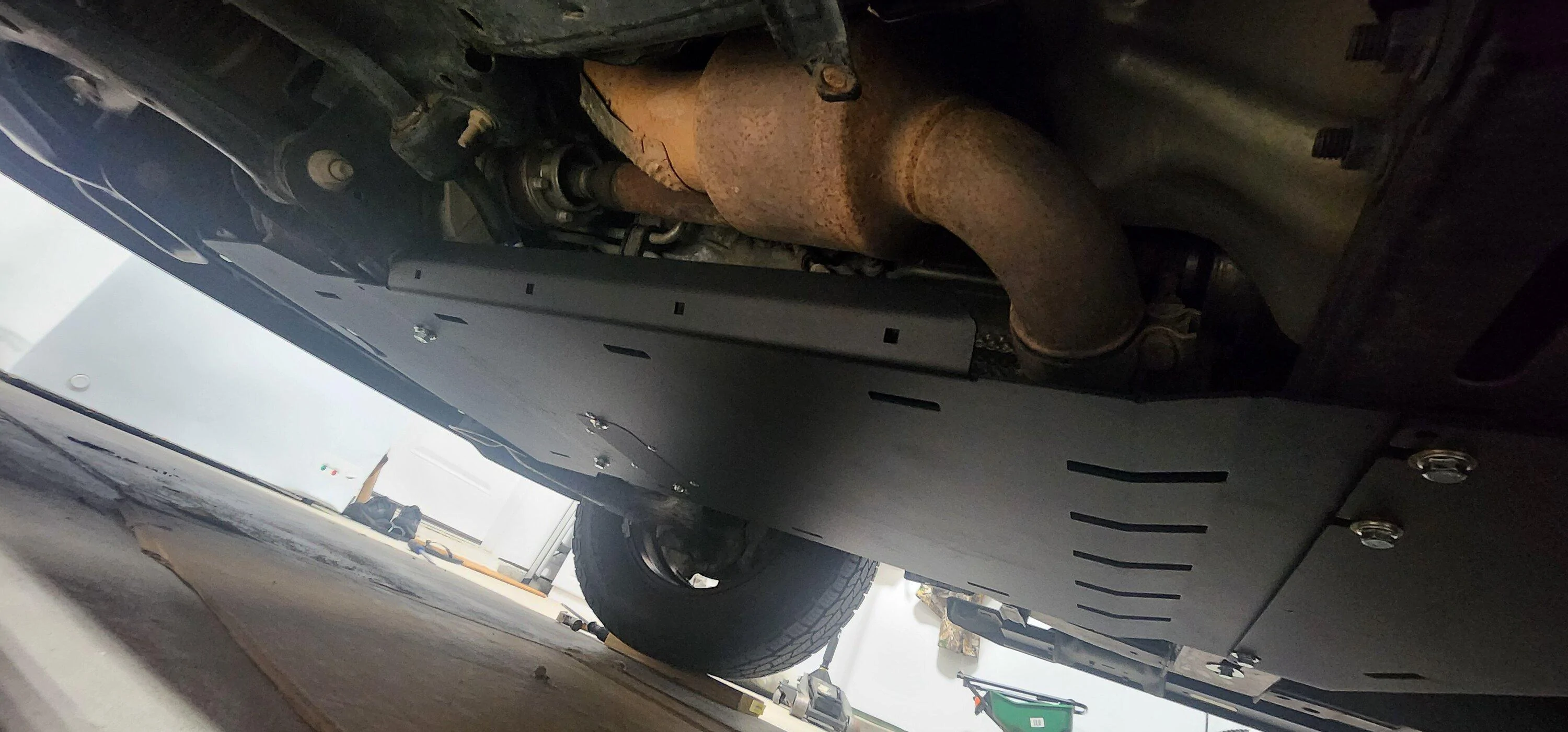

I put mine on a few months ago. Oddly one of the holes for the tank straps was off by a few inches. I tripled checked and yup, it was off. I had to redrill.
In hindsight I wish the RCI skids protected the lower control arm mount.
No protection on those mounts and they stick out lower than the RCI skid by 1-2".
